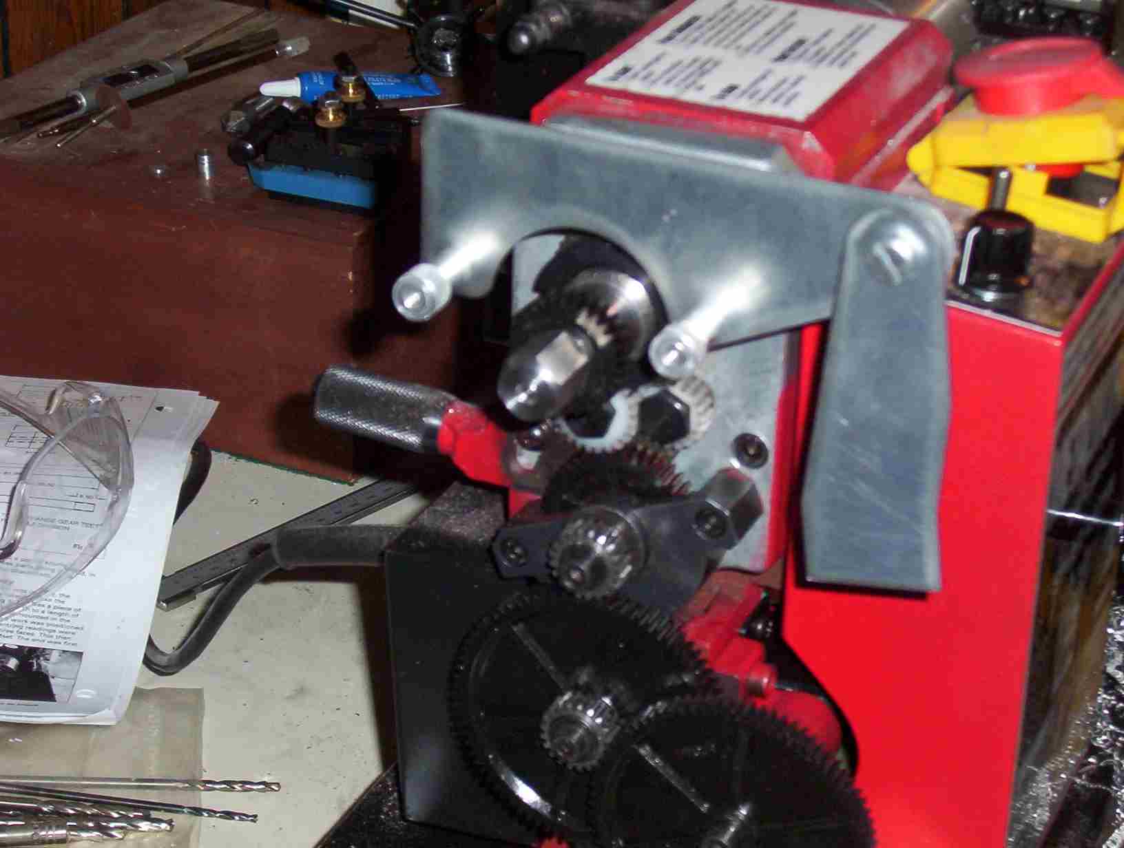

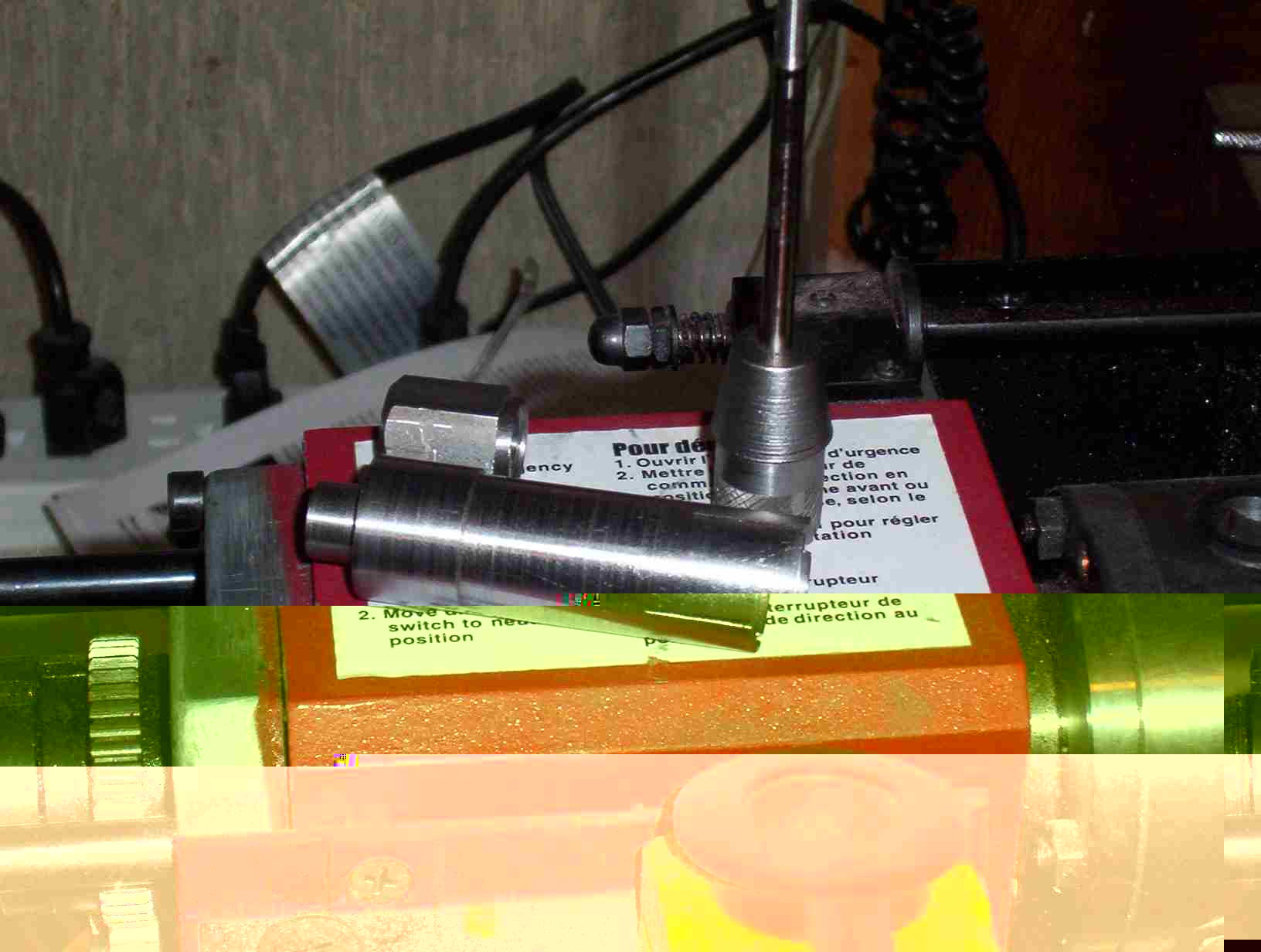

Hi All,
I cannot take credit for the design of this project, as it is from the pages of the MODEL ENGINEERS WORKSHOP magazine from the UK. They recently ran a whole series of articles by Dave Fenner on the mini-lathe and projects for it. This attachment consists of a expanding arbor that slips into the backend of the spindle and then expands when you tighten it to lock into the spindle. It uses one of your lathes change gears as the index. In the photos you can see both the expanding arbor and then the mounting plates on the end of the lathe as well in that photo the arbor is in place with a small change gear mounted. I have yet to build the small spring loaded plunger which will mount on the swingplate (hanging down in photo) and engage into the teeth of the gear for pos=itive locking of the spindle. The many change gears will allow most any number of desired divisions. Couple this attchment with a toolpost mounted dremel tool and al sorts of neat things become possible on this little lathe! Once I finish the plunger I will post a complete pic. All these parts were made on the mini lathe, except I slit the expanding arbor on my mill and I knurled the retaining nuts on my big lathe as I don't have a knurler for the mini lathe.
Questions?
Gerald

Ralph, Gerald's building an indexing attachment so he can accurately rotate / index / divide the workpiece for other operations in the lathe ............ hence the use of a dremel in the toolpopst, your using the chuck as a dividing head ............. I'm pretty sure Cedge has done this as well.

It appears that others have answered the question as to what to use this for. I plan on making new graduated dials for things like my lathe or for drilling bolt hole circles on the face of things mounted in the chuck. Drilling of course will require a live tool in the toolpost and I have described my toolpost holder for a dremel tool in another posting. The dials can be graduated by simply using a very sharp lathe tool to scribe the lines into the new dial which you index around in equal steps. Say you would do 50 divisions for a dial to be used on a 20TPI screw (for 50 thou per turn of the screw)
Look for DAVE FENNER's new book on the MINI LATHE in the Workshop Series. Dave was the past editor of the UK  magazine MODEL ENGINEERS WORKSHOP. Both the book and the magzine will be readily available in the UK where you are located.
Gerald

Cedge dose indeed have such a modification.... nice hint CC...LOL.  Soooo... I hadda run out to the cold shop and shoot some photos.  :(
Gerald...
One suggestion for you. Notice I moved everything outside the gear box cover. Your idea is sound and looks easily adaptable to outer mounting. This lets me use it with a minimum of fuss. It stays on the machine all the time now and I don't have to remove the cover to get to it. The hand wheel was added later to let me have a way to hand turn threads... if I ever get around to turning threads....LOL
I'm also looking at another idea or two where the indexing is done on the cross slide. Much easier to get at the edge of a work piece. The drill bit would be located in the lathe chuck.
I noticed your Dremel mod . I quickly found the snout mount was not quite stable enough and had to add a more substantial mount to hold it steady while drilling. I'll post photos later.
Understand.... I'm not being in any way critical of your efforts. I'm only sharing what time and experience taught me... old school bloody knuckle style. If it saves you from a problem then the scars are worth it...LOL

Thanks for the pics and the comments. I have a set-up like yours (mostly completed)  on my TAIG, however the design for the mini lathe is to allow the use of the lathe's own supplied change gears to generate the index. Once you go to a plate based system such as yours , you need either CNC or a rotary table/mill  to generate the master plates! As far as the dremel in the toolpost goes, I have done a small amount of drilling and grinding with it and it seemed solid enough. However having said that I have recently replaced the turret toolpost with a QCTP and I haven't used it there. I was given a nice block of nylon a few days ago and I may make a full body clamp for the dremal that totally replaces the toolpost.
Gerald

Gerald...
What I was hinting at was using the change gears as indexing plates, but outside of the cover. Visualize using the change gears in place of my indexing plate. A quick change of a gear and you're off to the races again. Little Machine Shop offers a full set of extra change gears for $29.95 or you can get the 40 - 50 and 60 tooth gears for just under $16.00. Then you still have an intact gear train as well.
Darren....
You could use the gears to cut an index plate, but the gears can also function as the plate. You're thinking is spot on :beer:

Cedge,
Yes I see your point about having it outside the end cover. That is easily doable with just a slightly longer arbor. Cover or no cover is not really an issue for me. The longer studs and the knurled nuts that retain the index attachment also serve to hold the end cover in place so no more using the socket head bolts that originally held it on. Ans yes of course you could use the change gears to produce a set of dedicated index plates going so far as to make an individual plate for each index, 2,3,4,5,6,7,8.........etc and this would eliminate counting holes  or gear teeth when doing an indexing operation. I guess if you do loads of it then this might be worth the effort. In actual fact I have a CNC 4th axis project on the back burner so for me at least , at some point this will all be redundant. I can easily use the CNC mill to produce an index plate with any desired index spacing so it really is a simple operation here in my shop. I already have 2 complete sets of mini lathe change gears so this is just the easy convenient and cheap way to go for me. I always take the path of least effort!
Gerald
