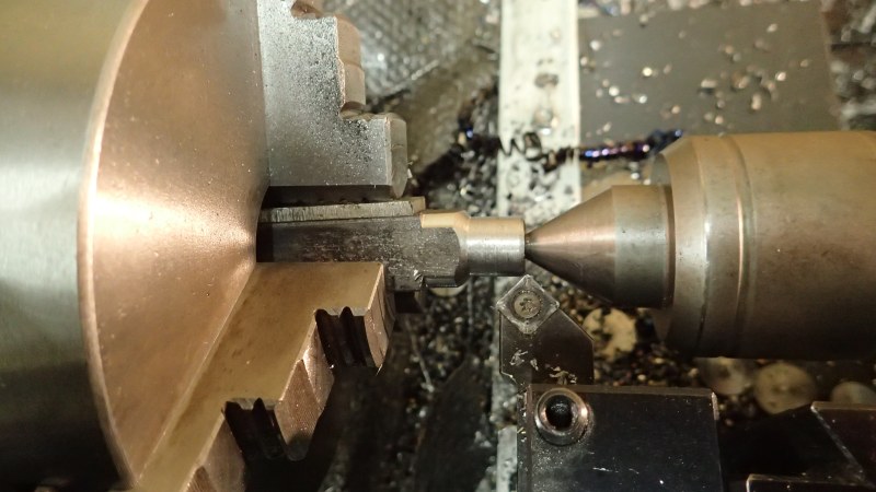

With the part mounted into or onto the chuck, with the jaws just 'tweaked' tight, the ball race is brought into contact with the face that requires straightening up. With a slight nudge from the tool, the part should move into a much truer running position, then you tighten up the jaws. If say you were holding a disc in the jaws, by nudging, you should be able to get it running fairly true, if not spot on.

By swinging the toolholder the other way, the other ballrace can be brought into operation to true up those wobbly bits of metal held in the jaws, before fully tightening up.

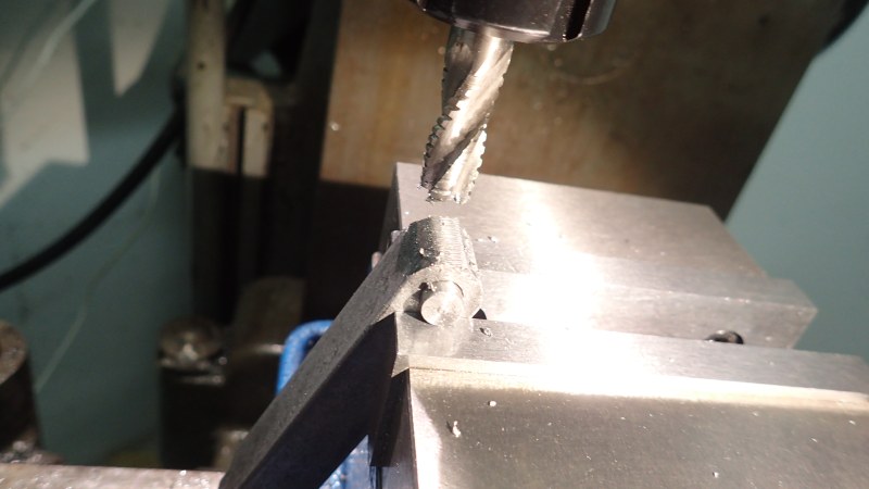

mine is just a bearing pressed on to a silver steel bar
it has a paint mark on it so it can be used as a edge finder on the mill (once it touches the job it stops spinning )
works great

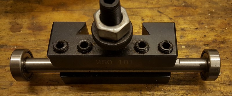

My version:
http://i577.photobucket.com/albums/ss219/H0n3/Tooling/C3-QCTP/PE-QCTP-20s.jpgA quickie 'Nudger'
http://i577.photobucket.com/albums/ss219/H0n3/Tooling/C3-QCTP/PE-QCTP-21s.jpgA quickie 'Nudger'
/Peter

He also showed a bearing mounted on the end of a round bar, as a simple edge finder - brilliant - so simple to use in the milling machine :clap:

Peter, nice one!
Andrew, how it used on the milling machine? Like edgefinder? When bearing rotates, you are 1/2 OD way off center?
I wanted to avoid using screws, ended up making it press tight. Probably have to use glue if I ever disassemble it. made shoulder for inner race.
