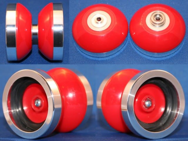

I know 1 or 2 of you were interested in seeing some yo-yo modding. What I'm going to show below is one of the yo-yos I finished today.
Yo-yoing has evolved significantly in the past 20 years or so. Until around 1990 all yo-yos had been fixed axle, then the first ball bearing axles were introduced. With longer sleep times yo-yo tricks became much longer and interesting. Around 2000-2001, players started messing with the traditional way that the yo-yo returns and played their yo-yo with little to no tug response. There are no limitations to what a player can do with their yo-yo now. creative tricks are the only concern.
I take low end responsive yo-yos and modify them in a way that allows advanced tricks. This usually involves cutting a groove around the bearing and applying silicone in the groove that allows a bind return. Basically the yo-yo returns only when you want it to. Sometimes I will convert the yo-yo to a larger bearing size to widen the string gap to allow more string layers. Sometimes I add weight rings to increase spin times. I did all 3 in the yo-yo below.

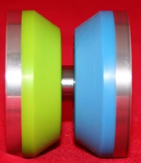

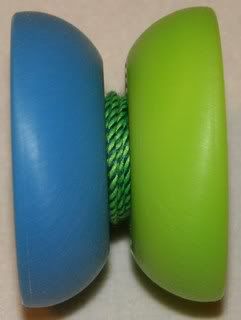

This is a beginner model yo-yo that is available at Toys R' us for about $15.
Here is a stock photo of the original

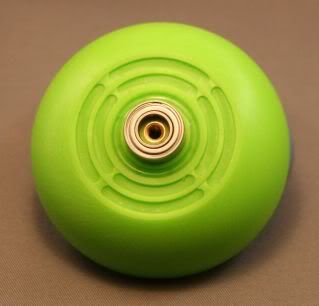

and the insides of the original look like this (not this yo-yo but same setup)

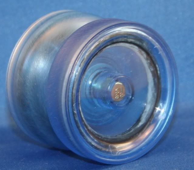

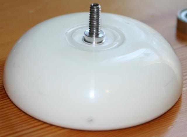

I cut out the original plastic hubs that housed spacers and a smaller 4mm wide bearing, and press inserted 1/2 in aluminum plugs.
Cut down the plugs to fit the larger size bearing on its 1/4" inner race.
drilling for the new axle
tapping for the new 6-32 axle
turning the long end of the plug down for eventual hubstacks, or independent spinning side members.
This is the small bearing on the post
Cutting the silicone response groove
before and after the groove
This is one of the new weight rings that i put on the rim of the yo-yo to increase spin time. The set was discarded from another yo-yo.
facing and turning down to size. Also took the green anodization off.
Cutting the rim down to fit the ring.
Ring fit on the half
Prepping to fill the grooves with flowable silicone.
Silicone installed and axle cut from a 6-32 flathead machine bolt.

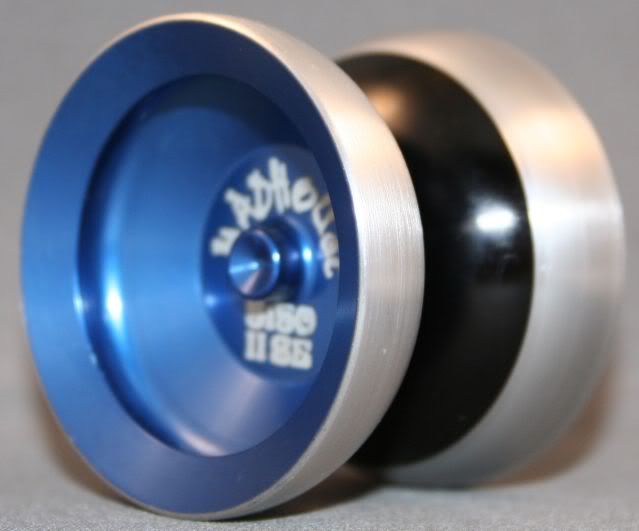

After the silicone cured and side spinning hubstacks were installed, the yo-yo is complete.
Now it is a beast of a yo-yo capable of any trick anyone can throw at it.

Interesting stuff! What are the white things for on the outside sides of the yoyo ?
Do we get to see any in action videos?

The white things on the side are mounted to the bearing on the outer post. They spin independently and are made of machined delrin. Independent spinning side posts are a relatively new innovation in yo-yos. been around since 2007. They allow you to catch and hold the sides of the yo-yo while its spinning.

Yes there is a balance of several variables that make a good yo-yo. Modifying them is al about making weak playing yo-yos into strong playing yo-yos.
One of the goals is to make the yo-yo smooth and vibration free. It is important to ensure that everything is done to both sides perfectly the same. Unbalanced(rotationally) halves cause a wobbly yo-yo. Other factors also make a wobbly yo-yo, bent axle, uneven bearing seat, trashy bearings, un-evenly treated hubstack bearings etc...
We all know a little about physics here, Max rim weight=max inertia= long spintimes. This is why a plastic body with metal rings are a popular mod. More dense material on the outer rim will increase inertia. A whole company was founded on that principle (www.yoyojam.com. I believe the rings I used on this yo-yo are bi-metallic, aluminum with titanium inserts in the undercut area. Although there is a drawback to massively outer weight, that is that it causes kickback in the throw the wider string gap also causes kickback, meaning when thrown the yo-yo grabs the "weight" and the extra string layers and lurches backward behind the thrower instead of straight downward like you would expect from a yo-yo.
Also extreme outerweaight causes some fulcrum instability. (Imagine 2 big people on a long seesaw). The yo-yo will lose its plane fairly easily.
as you can see there are lots of variables to take into consideration when designing a yo-yo. Most high-end yo-yos are made fully out of aluminum because you can more easily control the weight distribution as they are machined on CNC lathes.
http://img337.imageshack.us/img337/3586/quotecopy7bv21ip.jpgModding yo-yos
There is a "happy-medium" weight that players like to use that is around the 62-68 g range. That is why aluminum is used instead of brass or steel. Although brass and steel have been used in miniature yo-yos to maintain playable weight in a tiny yo-yo. The mod I posted is about 72 g. I may fix that later.
Companys sometimes use brass and titanium in slim, stable long sleeper yo-yos for world records(which is in the 22 minute range for transaxle yo-yos).
Yo-yo designers try to find the balance of variables that make a smooth, stable, long spinning, comfortable, good looking yo-yo(not necessarily in that order of importance).
outer-weight(width) = spin time
center-weight= stability
small diameter = fast
large diameter = slow

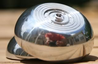

Great write up and videos! Thanks for sharing. I have some Titanium valves from nascar engines that I have wanted to make a yo-yo from, I will have to give it a try now that you have shown how.
Offline Mark132
  • Posts: 23
Re: Modding yo-yos
« Reply #18 on: March 02, 2011, 12:30:51 AM »

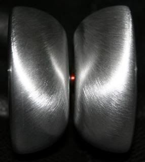

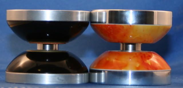

Titanium yo-yos are awesome. Due to their relative difficulty and cost to machine vs, aluminum it is rarely used for production models. Due to its strength the walls can be much thinner and thus you can really use the outer weight distribution to your advantage. Where an aluminum yo-yo will average about $100 retail, Ti yo-yos usually go for about $300.
I've never owned one because I cant afford it. But they are cool and they spark when you walk the dog.
This one is aluminum hubbed with giant Ti rings. And cool case.
« Last Edit: March 02, 2011, 01:37:50 AM by Mark132 »

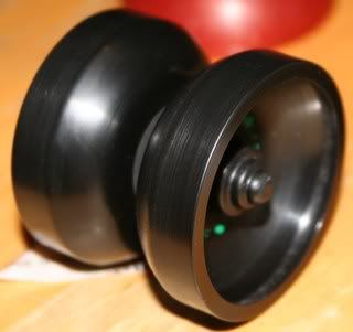

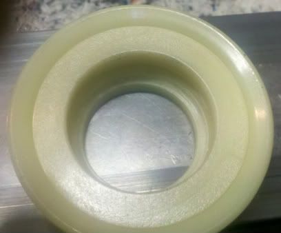

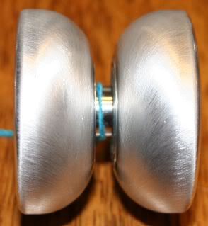

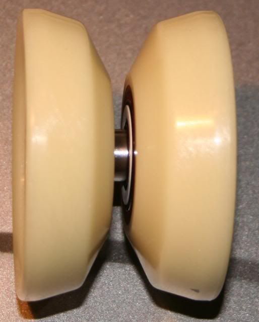

A new yo-yo I did recently.
Very basic. Added weight rings to a plastic yo-yo. The rings were from a previously broken hubbed yo-yo. They are nickel plated brass i believe. Very solid and stable, heavy spin.
around 76 grams after I cut out all of the internal plastic I could without making it too thin.

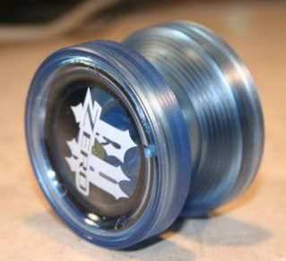

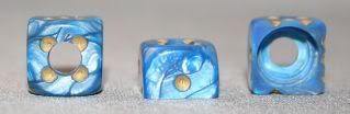

Here are a few pics of some of the yoyo mods I've done over the last few years:

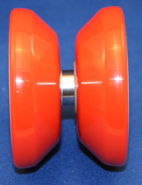

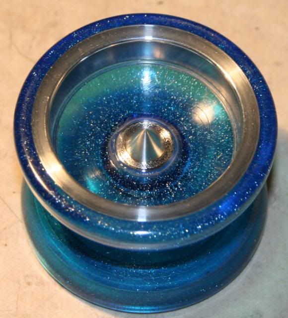

Most recent mod:  Take the best parts of two yoyos and make one out of them!  Hubs from an Velocity and rims from a Starlite
http://i70.photobucket.com/albums/i120/Ricerocket00/Yo-Yos/2011-03-11_14-11-52_980.jpgModding yo-yos+http://i70.photobucket.com/albums/i120/Ricerocket00/Yo-Yos/2011-03-11_14-12-14_592.jpgModding yo-yos=http://i70.photobucket.com/albums/i120/Ricerocket00/Yo-Yos/IMG_2565.jpgModding yo-yos
http://i70.photobucket.com/albums/i120/Ricerocket00/Yo-Yos/IMG_2416.jpgModding yo-yos

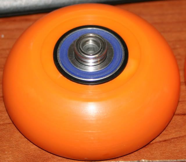

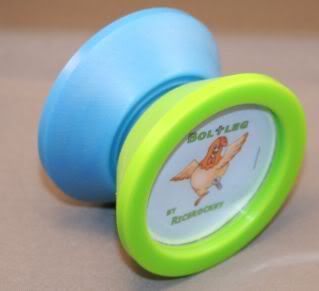

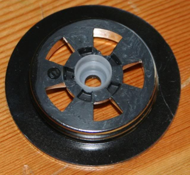

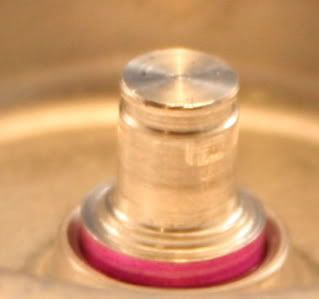

Added hubstacks to an unstacked yoyo (the independent bearing side caps Mark mentioned above).  The maker called it a 'DNS' or 'Do Not Stack' so of course I had to stack it!
http://i70.photobucket.com/albums/i120/Ricerocket00/Yo-Yos/IMG_2397.jpgModding yo-yos

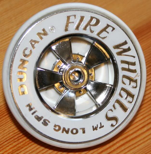

A Duncan Fire Wheels (you might fine one of these at a toy store or maybe even Wal Mart).  Machined a new hub to accept a bearing and hubstacks.  Also added silicone response ring:
http://i70.photobucket.com/albums/i120/Ricerocket00/Yo-Yos/IMG_2379.jpgModding yo-yoshttp://i70.photobucket.com/albums/i120/Ricerocket00/Yo-Yos/IMG_2380.jpgModding yo-yoshttp://i70.photobucket.com/albums/i120/Ricerocket00/Yo-Yos/IMG_2383.jpgModding yo-yos

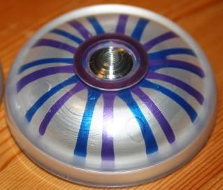

I machined the caps so that they acted as hubstacks so the whole 'wheel' spins.  Backside of the cap:
http://i70.photobucket.com/albums/i120/Ricerocket00/Yo-Yos/IMG_2384.jpgModding yo-yos
Video of the spinning side caps:
<a href="http://www.youtube.com/watch?v=8TLuVoZ_XKE" target="_blank" rel="noopener noreferrer" class="bbc_link bbc_flash_disabled new_win">http://www.youtube.com/watch?v=8TLuVoZ_XKE</a>

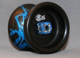

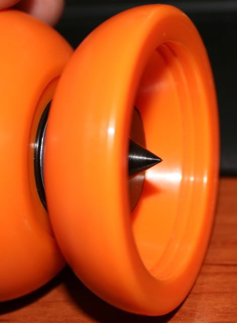

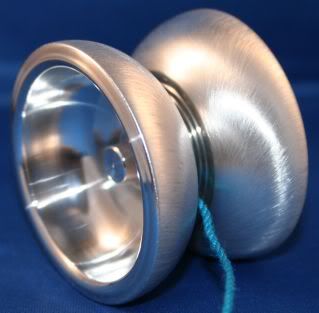

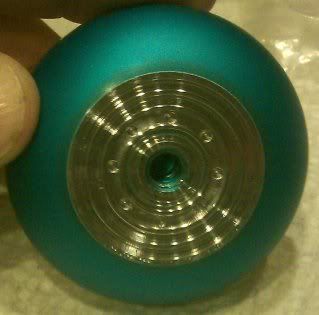

Rehubbed Bolt with spikes on the outside (once again for catching the yoyo on the outside with your fingers)
http://i70.photobucket.com/albums/i120/Ricerocket00/Yo-Yos/IMG_2263.jpgModding yo-yos
http://i70.photobucket.com/albums/i120/Ricerocket00/Yo-Yos/IMG_2261.jpgModding yo-yos

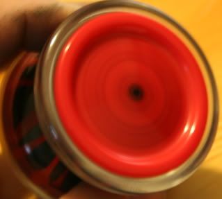

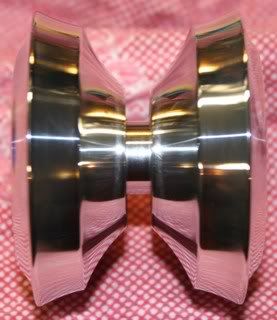

This one started out clear.  Painted it from the inside and also made new hubs for it.  This one features side spinning caps and was recently auctioned off for charity (just like the 4 Mark had the pic of above.   BTW, mine is the 2nd from the left)
http://i70.photobucket.com/albums/i120/Ricerocket00/Yo-Yos/IMG_2204.jpgModding yo-yos
Another one like the one above showing side cap spinning action:
http://i70.photobucket.com/albums/i120/Ricerocket00/Yo-Yos/IMG_2172.jpgModding yo-yos
Close up of what a machined hubstack post looks like.  The bearing sits over the post and is held into place with an o-ring.
http://i70.photobucket.com/albums/i120/Ricerocket00/Yo-Yos/IMG_2054.jpgModding yo-yos
This is a mod I did a while back.  You can change the center section to change it from a 'small' to a 'large' bearing.  This totally changes the play of the yoyo:
http://i70.photobucket.com/albums/i120/Ricerocket00/Yo-Yos/219CANON.jpgModding yo-yos
This one was a tough mod.  Reshaped Freehand Zero and added lights!
http://i70.photobucket.com/albums/i120/Ricerocket00/Yo-Yos/IMG_1519.jpgModding yo-yoshttp://i70.photobucket.com/albums/i120/Ricerocket00/Yo-Yos/IMG_1539.jpgModding yo-yos
I also machine 12mm so they fit over a hubstack bearing for that little extra 'touch'
http://i70.photobucket.com/albums/i120/Ricerocket00/Yo-Yos/IMG_0467.jpgModding yo-yoshttp://i70.photobucket.com/albums/i120/Ricerocket00/Yo-Yos/IMG_0476.jpgModding yo-yos
Some other random mods:
http://i70.photobucket.com/albums/i120/Ricerocket00/Yo-Yos/IMG_1871.jpgModding yo-yoshttp://i70.photobucket.com/albums/i120/Ricerocket00/Yo-Yos/IMG_1837.jpgModding yo-yoshttp://i70.photobucket.com/albums/i120/Ricerocket00/Yo-Yos/IMG_1851.jpgModding yo-yoshttp://i70.photobucket.com/albums/i120/Ricerocket00/Yo-Yos/217CANON1.jpgModding yo-yoshttp://i70.photobucket.com/albums/i120/Ricerocket00/Yo-Yos/IMAG0046.jpgModding yo-yoshttp://i70.photobucket.com/albums/i120/Ricerocket00/Yo-Yos/IMAG0050.jpgModding yo-yoshttp://i70.photobucket.com/albums/i120/Ricerocket00/Yo-Yos/IMG_1736.jpgModding yo-yoshttp://i70.photobucket.com/albums/i120/Ricerocket00/Yo-Yos/IMG_1174.jpgModding yo-yoshttp://i70.photobucket.com/albums/i120/Ricerocket00/Yo-Yos/IMG_1132.jpgModding yo-yoshttp://i70.photobucket.com/albums/i120/Ricerocket00/Yo-Yos/IMG_1015-1.jpgModding yo-yoshttp://i70.photobucket.com/albums/i120/Ricerocket00/Yo-Yos/IMG_0781.jpgModding yo-yoshttp://i70.photobucket.com/albums/i120/Ricerocket00/Yo-Yos/IMG_0672.jpgModding yo-yoshttp://i70.photobucket.com/albums/i120/Ricerocket00/Yo-Yos/ReprofiledBoltleg3.jpgModding yo-yoshttp://i70.photobucket.com/albums/i120/Ricerocket00/Yo-Yos/BoltlegSegmentedSchmooves.jpgModding yo-yoshttp://i70.photobucket.com/albums/i120/Ricerocket00/Yo-Yos/IMG_0348.jpgModding yo-yoshttp://i70.photobucket.com/albums/i120/Ricerocket00/Yo-Yos/EndedKyotu6.jpgModding yo-yoshttp://i70.photobucket.com/albums/i120/Ricerocket00/Yo-Yos/IMG_9581.jpgModding yo-yoshttp://i70.photobucket.com/albums/i120/Ricerocket00/Yo-Yos/BL84.jpgModding yo-yoshttp://i70.photobucket.com/albums/i120/Ricerocket00/Yo-Yos/IMG_9147.jpgModding yo-yoshttp://i70.photobucket.com/albums/i120/Ricerocket00/Yo-Yos/481b770d.jpgModding yo-yoshttp://i70.photobucket.com/albums/i120/Ricerocket00/Yo-Yos/IMG_8746.jpgModding yo-yos
