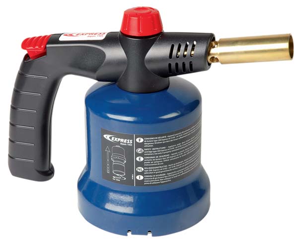

Til now i have always used tin solder to do my small boiler work.
As my boiler projects get bigger i decided to get some silver solder and use that instead. After watching numerous instructional videos on youtube and reading DIY guides on the net i tried it a couple of times yesterday with poor results.
The flux just gets brown then burns away into a crust without liquifying. From what i have read the flux should liquify to clear flowing fluid indication its time to apply the silver solder. this does not happen i my case .
I have tried on both copper and brass with same disappointing results, could it be that the surfaces need to be cleaned more thoroughly?
I am using this flux and solder (it is specified for model making)
http://cgi.ebay.co.uk/Silver-Solder-1-5mm-Flux-Kit-Brazing-Model-engineer-/360334888469?pt=UK_BOI_Metalworking_Milling_Welding_Metalworking_Supplies_ET&hash=item53e5a20e15
and i use a handheld propane/buthane torch

First, that blow lamp seems far too small to do what you are attempting (soldering a boiler). It will be good for very small things, jewelry size.
Lack of heat is the most likely cause why your flux won't turn watery. If you are used to soft soldering, silver needs a completely different "attitude" to heating the workpiece(s). The workpiece(s) must be glowing dull, otherwise no go. And if they are copper, brass, bronze, they must be glowing at least some 1-2 cm away from the intended seam also. To get enough heat to even a small boiler will need a huge torch, if you don´t build yourself some sort of a brazing hearth. It doesn´t need to be anything fancy, one of mine is here. It's just 3 1/2 fire bricks. I have a bigger one, but it is seldom used. The hearth should not be bigger than needed to keep the workpieces "inside". It is rather essential for everything except very small things - so small that the flame is big enough to completely engulf the workpiece. Anything bigger will need the heat to be constrained somehow, or else you will need an enormous torch (maybe even two or three), and you'll risk setting the whole shop afire...

If the burner is too small, could it be that the flux is exhausted (time thing not a heat one) before it has had a chance to do its job. If so perhaps a change to Tenacity flux instead of Easiflo might help, once a bigger burner is obtained.
As another guide to the right heat, if the rod does not melt and "flash" as soon as you put it to the joint, it is not hot enough. As has been said, it takes an awful lot of heat to solder a boiler, even a small one.

The silver solder you have is ok, but lay it down as pallions or circles around the joint rather than trying to feed by hand.
Your main stumbling block is your flux. The latest, Tenacity 5, designed for prolonged heating times, is what you really require, and don't use too much, just enough to cover both joint faces is plenty. Other fluxes will exhaust their cleaning properties well before you have the job up to solder flowing temperature, just like the one you are using now.
Two points about the heat source, don't use oxy/acet unless you can control it like a real professional, get a good sized propane burner, around 3/4" to 1" will be fine for smallish boilers. We made Stews boiler for his 3.5" loco with two burners, one at 3/4" and the larger background one was somewhere around 1.25".
NEVER point the heat source directly at the flux or solder. Play it onto the metal around or under the joint, when the job gets up to temperature, the solder will flow by itself towards the point of highest heat, it is then you can come in with your hand fed rod and fill in any gaps that are left.
Once you have mastered the technique, you should never have any more problems.

There's maybe some confusion about heat capacity and temperature. They are not the same thing. A lit match will have quite a high temperature at its "sweet spot", certainly far over 1.000 oC. It will actually melt iron - if the iron "lump" is  small enough. Test with a strand of 000# steel wool and see for yourself. But the heat capacity of a match flame is not much to write home about. It will not raise the temperature of one litre of water very rapidly.
The flames of small and large propane burners will attain +/- the same temperatures, but heating a litre of water to boiling will take a lot less time with a big burner. The two burners have different heat capacities.
In making a good silver solder joint, it´s not so much about temperature than about heat capacity. Most of the time the workpieces are very good heat conductors (copper, brass, bronze), that have to be constantly supplied with quite a lot of heat to keep them at a proper temperature. That is why a hearth would be needed. You will need a lot less heat capacity in the burner (meaning a lot less gas also, it's not free after all...) if you prevent the heat from escaping freely.
It is not enough to have a small spot at the tip of the flame over the melting point. That's a sure recipe for a failed silver solder joint. It´s all OK when actually "gas welding" pieces together, or even brass brazing them. Silver solder behaves differently. It will be sucked into the (well prepared) small cavity of the joint by capillary force (yes, even somewhat "uphill"), but only if 1). the surface is clean (=well fluxed), 2). the cavity is small enough to create that capillary force, and 3). it is hot enough also farther off from the flame tip, so it will not begin to solidify. It's often said that silver solder will "follow the heat". That's very true, it does.
Using an oxy-acetylene flame for silver soldering is asking for trouble if you don't do it daily, or train a lot how to control and manipulate the small but hot flame. And it is hot, it will reach 3.500 °C (6.330 °F). It's not so much the ultimate attainable temperature that interests, as long as it is well above the solder melting point. The important thing is the heat capacity. It has to be in relation to what you are trying to solder. With oxy-acetylene, you are very likely to heat just a small spot, not the whole workpiece (and there is always more than one workpiece to heat), and that spot to far too high a temperature.
