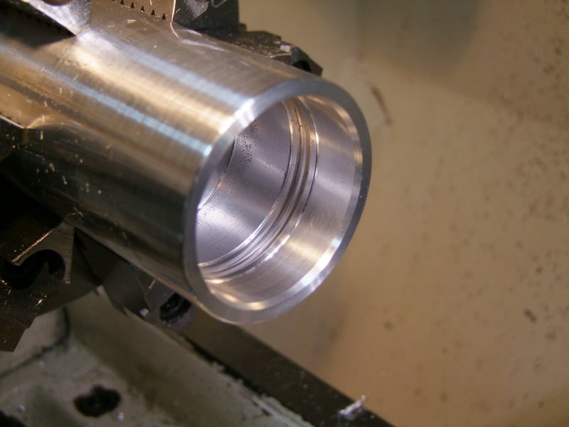

and then cut the o-ring grooves (I did two sets of them):
I tested the o-ring and lens (original head to the right side).  It works really well:

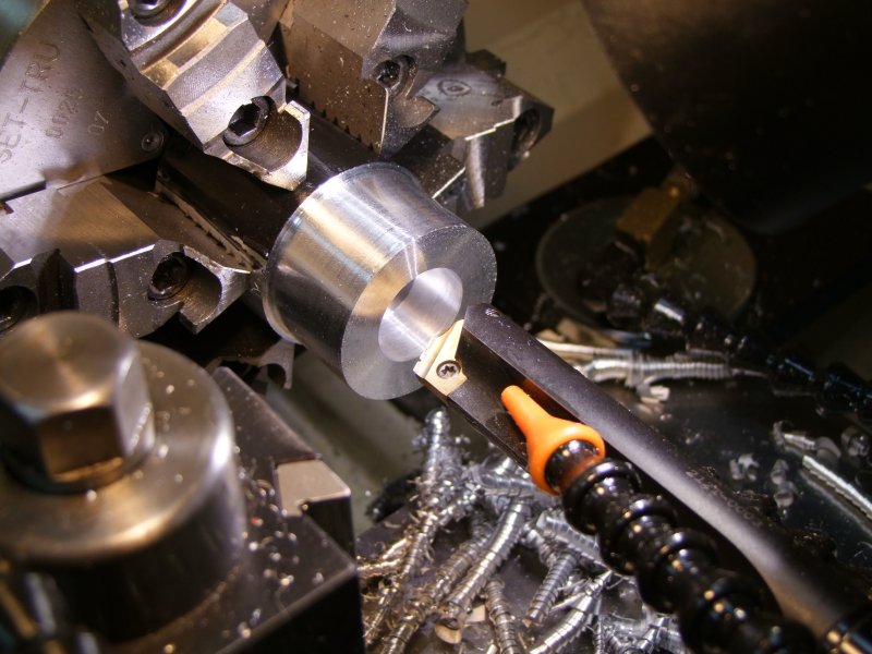

And I started work on the head:

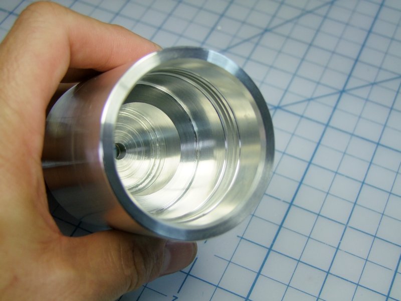

Test ID with lens:
Cut o-ring grooves:
Work on the other side, to get ready to thread:
Test new metric threads:

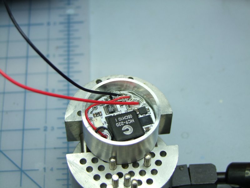

Again, for best thermal transfer, I decided to flow solder the SST-50 to the copper piece, so I made a small "post" so that I can then solder the wires from the sides:
I then worked on the other side of the module to make room for the H6CC current driver (set conservatively to 5Amps):
Reflow LED:
and test it to make sure I did not kill it:
Solder wires (very hard to solder wires "blind" from the underside!) and then test it at rated current (5A, but do to the long Power Supply wires the voltage was of course higher than the actual vf):

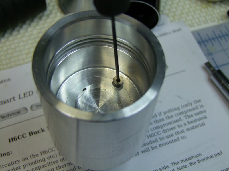

To provide mechanical strength to the solder wires, and so seal the cavity I used 2-part epoxy (even mixed glow in the dark powder for fun, although it is hard to see behind the reflector!):

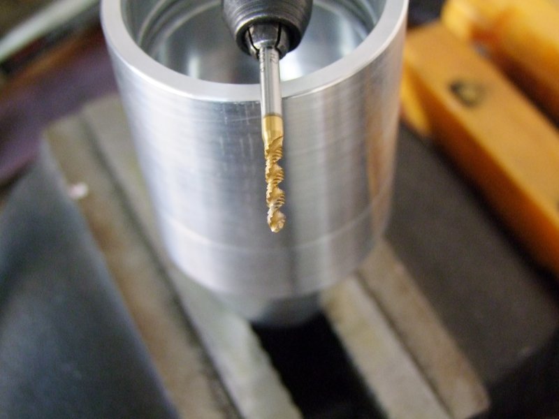

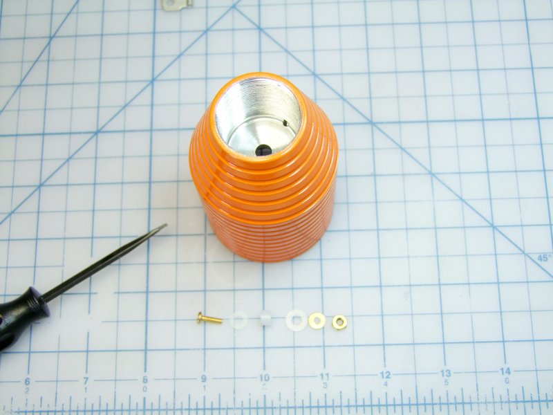

To make 100% of the solid electrical contact for the negative battery, I am using a screw through the head, through the lip of the body - no chance for anything intermittent in a diving light!:
I then milled a relief area for the screw head:

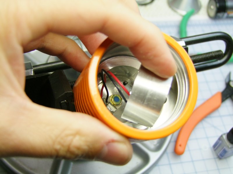

I am also using a screw to keep the LED/driver module firmly in place:
Since it is a slight press fit, I drilled two small holes so that I could use thin nose pliers to align the module with the screw hole:

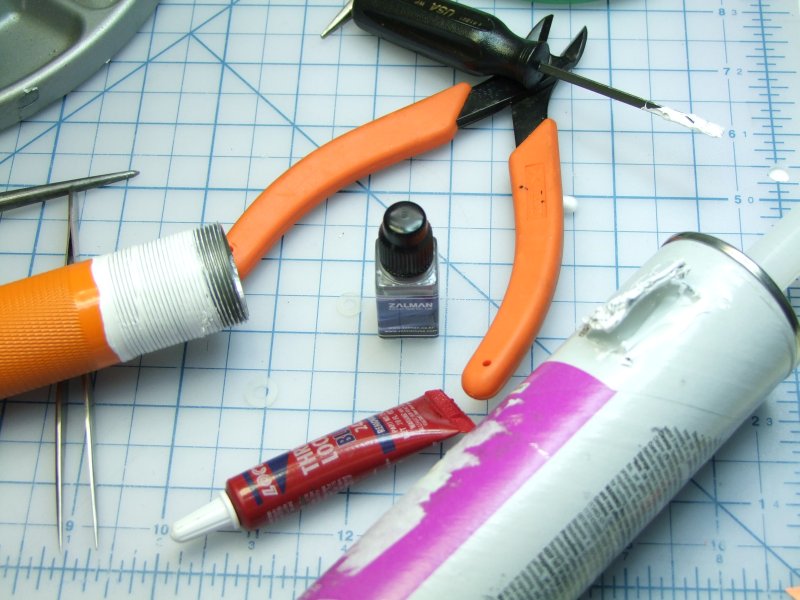

Here I am doing the final assembly (blue stuff is Loctite):
Seal the head to the battery tube (had to access sealant from side as top was dry!):
Lightly coat module with thermal paste:
and seat in place (here I am not done cleaning the interior - not that anyone will see this part anyway, but that is the way I am!):
