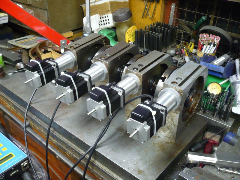

Re: 1hand's CNC RT
« Reply #2 on: January 16, 2011, 08:12:37 AM »
1hand,
I'd advise against using one of these Lovejoy type couplings. They are designed for axial misalignment and when doing these RT's if there is any misalignment it's always radial.
Look at Bog's post on his and use Oldham couplings, they are zero backlash and will handle both radial and axial misalignment. Plus feature is they are often shallower and save more space.
John S.

  • Posts: 2914
Re: 1hand's CNC RT
« Reply #5 on: January 17, 2011, 06:25:18 PM »
Looks good, like John said though, I also used Oldham couplings for mine.

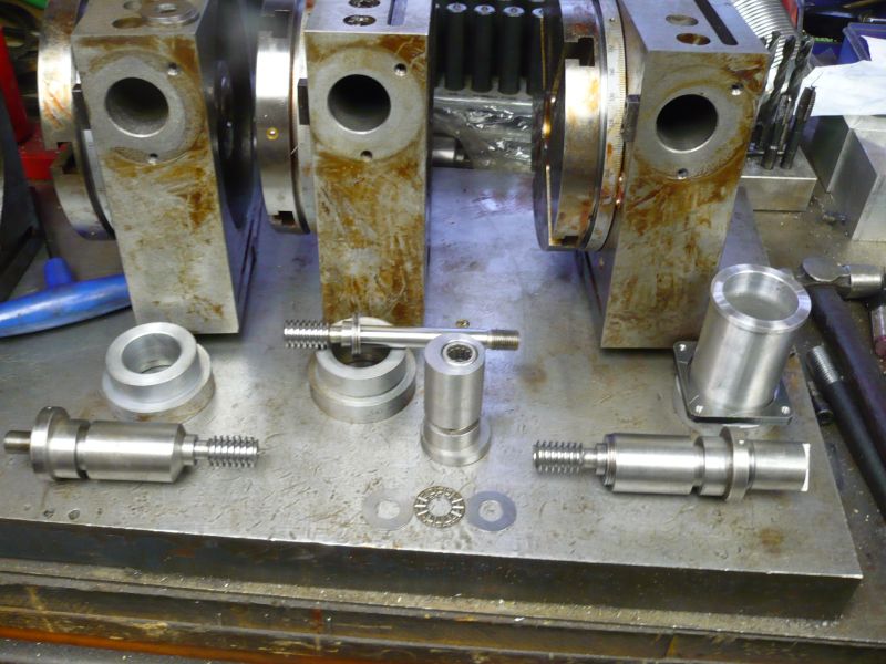

Re: 1hand's CNC RT
« Reply #6 on: January 17, 2011, 06:31:03 PM »
You can also fit bearings into this type of table as well, needle rollers and needle thrust, makes them a lot smoother.
One on the left is original, centre one has had the eccentric shortened down to get two thrusts in and bored for the needle rollers.
Far right is finished and assembles with the oldham coupling half doubling up as lock nut and adjuster.
finished and tested.
John S.
  • Posts: 2914
Re: 1hand's CNC RT
« Reply #7 on: January 17, 2011, 06:33:31 PM »
I only use my one occasionally, 4 is just greedy!  :clap:

Offline Spurry
  • Posts: 352
  • Norfolk, UK
Re: 1hand's CNC RT
« Reply #9 on: January 17, 2011, 07:05:23 PM »
John S
It looks like you have turned about 8mm off the rear of the eccentric for the thrust washers. That would seem to move the worm outwards by about 4mm from it's original position. I thought it would be a good idea to remove 4.00mm and to counterbore the front thrust bearing by about 3.50mm, so the worm was only out of position by 0.50mm. Apart from more work, is there likely to be any other adverse result?
Thanks
Re: 1hand's CNC RT
« Reply #10 on: January 17, 2011, 07:21:10 PM »
The worm position isn't critical as it only uses about three teeth anyway and as long as you are somewhere along the worm thread with full engagement , that's all that matters.
John S.

Offline cfellows
  • Posts: 303
Re: 1hand's CNC RT
« Reply #20 on: January 18, 2011, 07:13:15 PM »
Hey, Matt, what size stepper did you use (voltage and current).
Chuck
Offline 1hand
  • Posts: 113
Re: 1hand's CNC RT
« Reply #21 on: January 18, 2011, 08:06:31 PM »
nema 23 381oz/in 3.5amp 48v
I used the same as my mill and lathe to keep it all the same, but could of got by with a smaller one.
Matt
