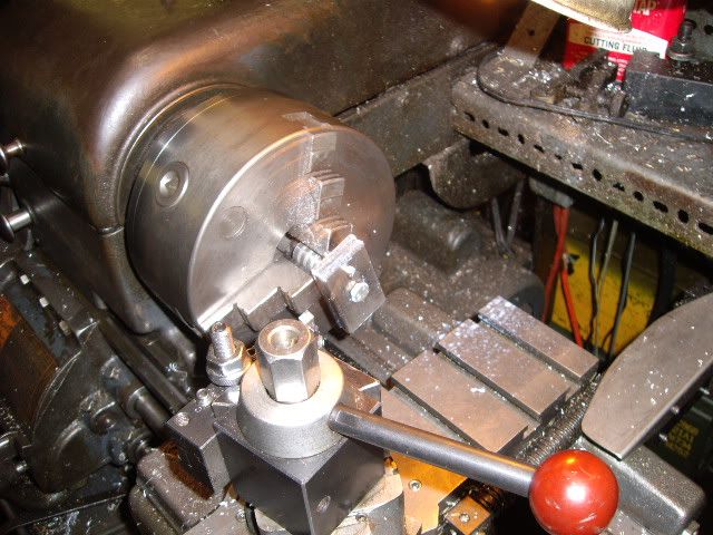

http://i894.photobucket.com/albums/ac150/madjackghengis/_0004-2.jpgbuilding a new flame sucker
turned a plug to fit in the crank structure, so it'll hold tight in the vise without distortion
http://i894.photobucket.com/albums/ac150/madjackghengis/_0005-1.jpgbuilding a new flame sucker
first cuts on the plug
http://i894.photobucket.com/albums/ac150/madjackghengis/_0006-1.jpgbuilding a new flame sucker
more turning, the blank is inch and three quarters, the bore of the crank support is 1.375

http://i894.photobucket.com/albums/ac150/madjackghengis/_0001-3.jpgbuilding a new flame sucker
turning off the sharp corners of the support, excess metal, and not in keeping with the shape I want.
