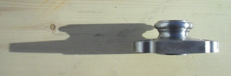

« Reply #217 on: March 10, 2012, 06:53:22 PM »
More progress :headbang:
Trying to make the steering head more interesting too look at. I made a mandrel and thinned the plates I'm using for the steering head. I just thinned the sides though. The middle is still the original thickness.
http://img.photobucket.com/albums/v652/Powderkeg3418/Penny%20Farthing/PennyFarthing092.jpgPenny Farthing Bicycle
Here are the final results.

I'm still poking away at this :poke:
Today I milled some locators on the steering head pieces that will later be welded together.
http://img.photobucket.com/albums/v652/Powderkeg3418/Penny%20Farthing/PennyFarthing095.jpgPenny Farthing Bicycle
The handlebar lug got a flat also.
http://img.photobucket.com/albums/v652/Powderkeg3418/Penny%20Farthing/PennyFarthing096.jpgPenny Farthing Bicycle
The pieces go together like a puzzle:o)
http://img.photobucket.com/albums/v652/Powderkeg3418/Penny%20Farthing/PennyFarthing097.jpgPenny Farthing Bicycle
I'll be able to weld the pieces together now and keep them straight\o/
http://img.photobucket.com/albums/v652/Powderkeg3418/Penny%20Farthing/PennyFarthing098.jpgPenny Farthing Bicycle
I'll try and get that done in the next couple days:o)
