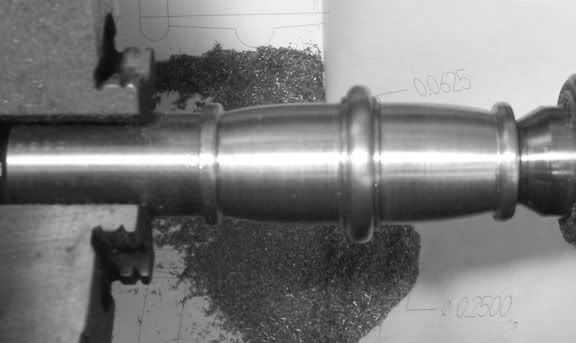

« Reply #192 on: February 28, 2012, 09:44:47 PM »
I got the crown piece turned.
http://img.photobucket.com/albums/v652/Powderkeg3418/Penny%20Farthing/PennyFarthing083.jpgPenny Farthing Bicycle
I roughed the ends with a radius tool then filed and scraped it to shape. Checking it with a radius gauge along the way.
http://img.photobucket.com/albums/v652/Powderkeg3418/Penny%20Farthing/PennyFarthing082.jpgPenny Farthing Bicycle
After it was too my liking I cut it in half :Doh:
http://img.photobucket.com/albums/v652/Powderkeg3418/Penny%20Farthing/PennyFarthing084.jpgPenny Farthing Bicycle
This is what I was after. I'll set it up in the mill and touch up my angles then mill a couple pockets to hold the fork tubes.
http://img.photobucket.com/albums/v652/Powderkeg3418/Penny%20Farthing/PennyFarthing085.jpgPenny Farthing Bicycle
Getting closer\o/
~Wes~
