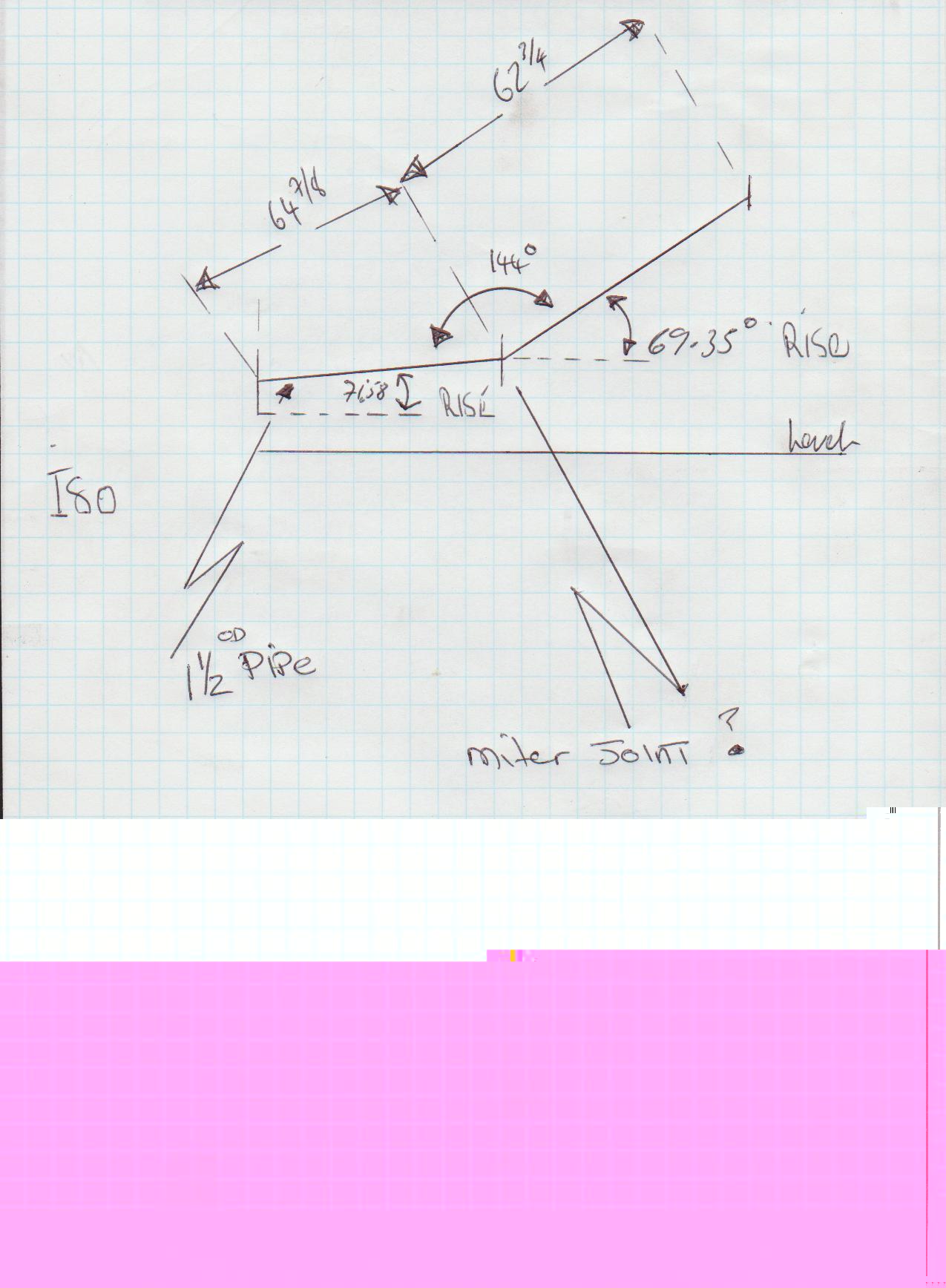

I need to make a handrail so I need to miter the pipe to make the joints, in the attachment is a hand sketched Iso it shows my runs, angles of rise and angle of turn.
What is the formula to making a swing joint off set miter joint. I really want to make a template out of card so I can wrap around the pipe and trace the line to make the cut on the pipe.

Your math is correct for a level miter, but I have a rise and angle projection together. I called that a swing joint( maybe wrong here).
In essence  my y value from left to right on the sketch is 71.58* rise from level heading to z,  my run is 64.875 then I hit my miter joint,  then at the joint I  rise 69.35* in z travel while 144* away from x value.
Yep before I cut the pipe I certainly will slice into card. This is a brain teezer, believe me I was at my welding table for an hour tonight fiddling with pipe and propping up silly stands trying to get a visual on this.

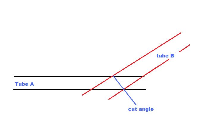

Simple way to do it, I served my time as a joiner so had to do a lot of jobs like this in my time, we simply drew it out on plywood,then used the same bit of plywood to make a mitre box, using this methoud you can have two different sized tubes and still get the correct angle.
this is just an alternative way to do it and just posted so you can have alternative fall back, if you have one of these cheap power miter saws with a metal blade in use the piece of ply as a temlet to set the saw.
Oh and when you draw it out devide by 2 or  4  the two lenght's  but not the pipe size to make it managable to draw
Peter

This is a rolling off set, the miter has to do two functions swing an angle (off set) then roll up at an angle.
Allot of people have answered my question I thank them but all the answers I am getting is just for a general miter.
My first sketch has the wrong angles I have amended this with another sketch. All so read the drawing as an Isometric three dimensional.
I did not mean to complicate it its my fault for a bad drawing.
Berned I think your right I maybe making this too complicated, I have read a lot of peoples answers and gone into the shop and tried it just don’t seem to work, where I offer the two pipes in the air at the given  elevation changes  and the angled off set I see the joint of being a mixture of both angle change and elevation in the angle from one pipe to the other.
I think this is one of the hardest times I have had to put into words a complicated math problem.
Hopefully this next sketch helps.
Thanks to all again.   Anthony.

I think (and that is sometimes a bad thing) that we are taking a simple problem and making it complicated. The math has escaped me at present. When these 2 pipes are mitered and welded it will be the same as 1 long pipe with a bend of X degrees somewhere close to the center. Now if we take that pipe and lay it on the floor with nothing supporting it, it will lay flat on the floor. In that position you can see that there is only 1 angle involved. Divide that angle by 2 to get your cutting angle.
This is easy to do after the fact. Now we see how it can be worked out mathematically or making a mock-up. Take 2 pieces of something of proper length and make a mock-up the way it will be installed then measure the angle formed, divide by 2 and cut the same angle on both pieces and they should line up as perfect as what you measured.
