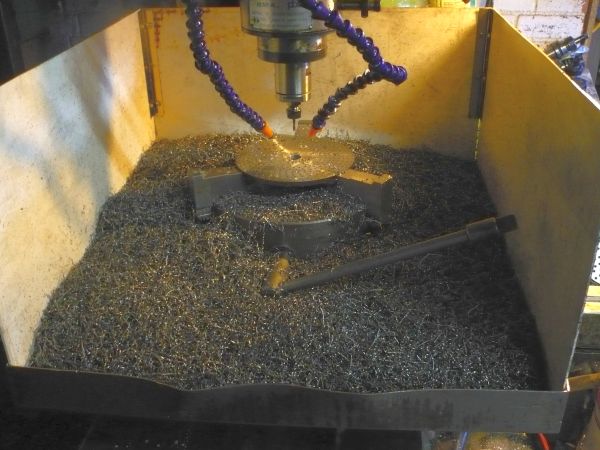

Re: Drilling! - small holes on the mill and centre drills
« Reply #16 on: July 18, 2010, 01:48:40 PM »
1) Center drills are about 3X as stiff as a spotting drill because less material is removed for the flutes.
So why don't you see CNC machining centres using them? Less material removed isn't correct, if you take to pip that always breaks off then it's very weak in comparison to the main body.
a spotting drill is the larger diameter all the way.
2) Here in the U.S. the "cost equation" for center drills versus spotting drills is reversed.  A good quality spotting drill costs slightly more than double the cost of a good quality center drill.
Same here but now compare a stub drill to a spotting drill, hardly any difference and a fraction of the price of both.
This was yesterday afternoons work.
Believe it or not there is a 10" chuck under that lot and that is all done from drilling 8,500 holes in a series of 6mm thick steel plate with a 1/8" stub drill, nor pilot or centre drill first.
I wouldn't offer advise unless i know it works.
John S.

Personally I don't think so.
On those dividing plates I do there are literally 1,000's of holes, one has a 127 row right on the outside and it's just possible to fit this row in with 12 thou between holes.
If you get a drill wandering it stands out like a sore thumb two holes will be broken together and another two will have a large gap between them.
I buy good quality stub drill, usually Guhring, from J&L in quantity and change the drill every 4 plates, that's about 2,000 holes, if I do this I get no problems, any more and it's pushing it.
I do regrind drills but I have a precision Swiss drill grinder that fits in a shoebox and cost £9,000 when new and no I didn't pay that. I only do this not to save money but a correctly ground drill will do 6 plates, remember drills are produced on production equipment to the best economical shape, not the ultimate shape.
This is why Meteor and Christian are still making drill grinders that cost up to 15K and fit in shoe boxes. If there were no demand they would go out of business.
John S.
