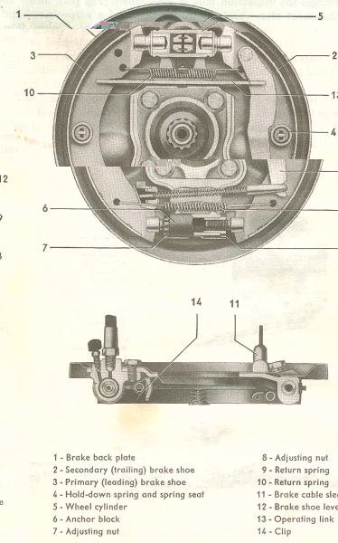

Darren,
I remember the days I did my VW brakes. Same problem. Only I discovered that as the shoes wore the brakes would adjust themselfs. They had a small star wheel the would turn a nut and extend the brake rod from the cylinder a bit further.
What I had to was take a screw driver and screw the little wheels back in releaseing the brakes. Made taking the drum off much easier. With todays disk brakes no such worry any more.
I've attached a copy from the original VW manual to give you a better idea of what I'm talking about. It's item #7.

Yes I know what you are on about Bernd. You could release the brakes through a little hole in the rear.
Mine have an adjuster, but it's in the same place as the hydraulic cylinders and there is no access from the rear.
Hence my modifications to prevent a repeat performance :dremel:
