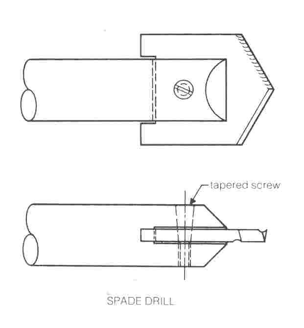

Here's another alternative. Make a spade drill. The shaft can be smaller than the drill bit end taking care of chip build up. Make up size to suit.

Bernd; Interesting idea with the spade bit; Wikipedia reckons they're good to 10x diameter (which would give me ~6.25" depth), but maybe I can go deeper within the tolerances I've got. Also, I do have a (heavyweight) drill press, which would be big & ugly enough to cope with the job... but it's got wobble like you wouldn't believe. Fine for roughing out really big holes, but I wouldn't trust it with this job.
