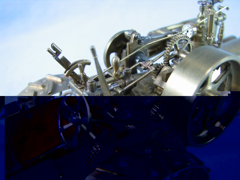

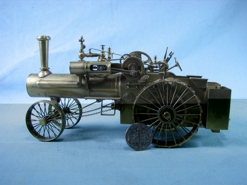

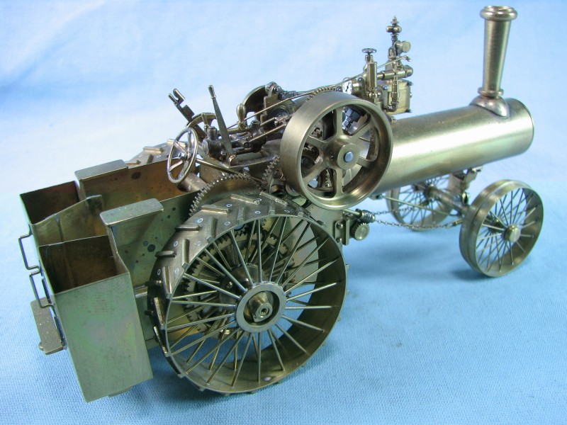

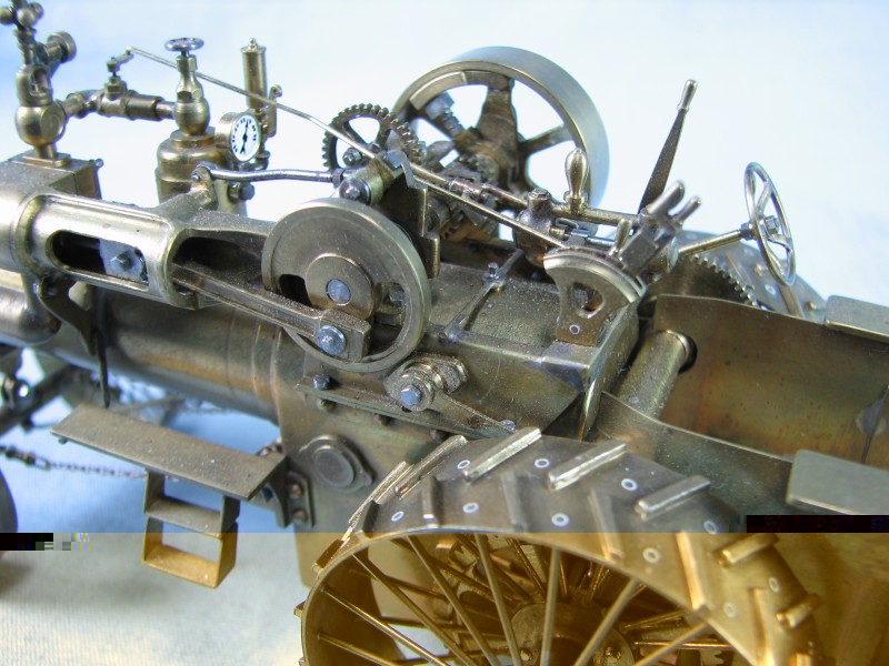

Gentlemen, this is the small version of a Case traction engine. I used the plans from my 1/12 Case engine and scaled it down. It's about 1/75 scale. Just a little larger than HO. It will run on compressed air but the piping is so restrictive that will only run on about 25 lbs. Most of the small fasteners are 1x.25 mm. The hardest part was making the rear wheels. Being that the cleats are layed out at an angle to the wheel axis I couldn't just turn them at an angle and cut them. I mounted the stock in my dividing head, turned the head at the appropriate angle then cut one side of each cleat with a degree cutter, then repeated that for the other side of the cleat. I then made a cut between each of the cuts to remove the extra material. The dividing head was then turned to do the other row, same procedure. After machining I went back in between each cleat and filed the contour with a needle file.

I hardly know what to say.  It looks like a nice model until you see the quarter sitting there and realize that it is 1/72 scale. Then it becomes "Oh my gosh, how could he do that?". A very nice model that you can be proud of George. Thanks for sharing it with us. :ddb: :ddb:
Even more impressive when you know it's a dime and not a quarter.   :clap:
Re: 1925 Case 65 hp. traction engine (small version)
« Reply #5 on: December 26, 2009, 05:09:34 PM »
I haven't even a dime to my name  :(  so I had to look it up. About 0.7", and scaling from that makes the entire model about 6" long. Wow!

OK Guys
Time to fess up.  :doh:  I just took for granted that it was a US quarter in the picture. Now upon closer inspection I can see that it is a US dime. Now I can see why some of the posts didn't make sense to me. I can't even blame it on drinking as I haven't had that many. I guess I will have to blame it on engaging keyboard before brain. :lol: :lol:
You win some, you loose some. :ddb: :ddb:
George

A dime is a tad under 18mm for those of us that don't see one on a regular basis.
