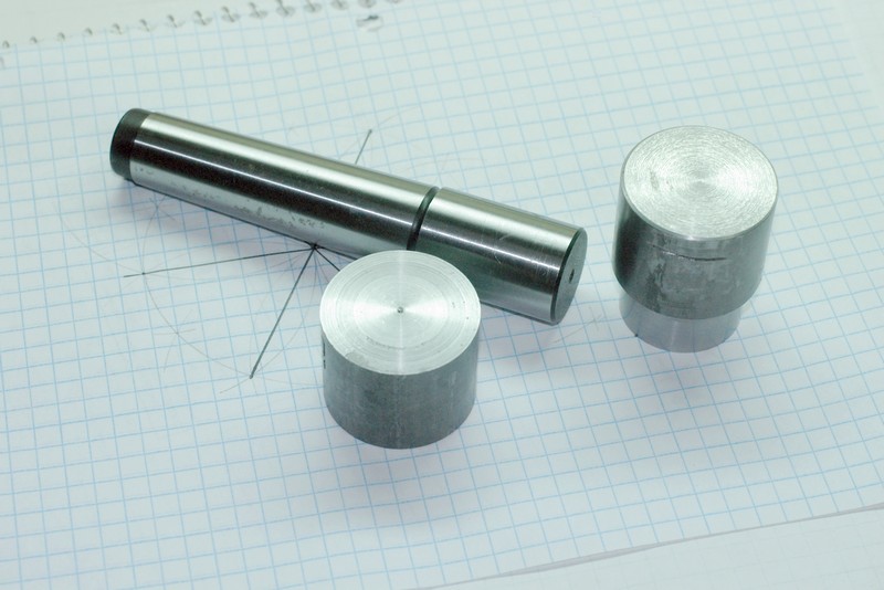

Ade's post on "How do I....bore out a hollow section leaving the centre intact? " got me off my behind to take a couple of photo's and post a just finished little project that was long over due.
I don't have a mill but I do some light milling using my lathe. The lathe has a spindle that takes 4mt fittings but I generally make tooling using 3mt blank end arbors and fit them to the lathe using a 3mt to 4mt adapter. I do make some that are 4mt but 3mt blank end arbors are by far the easiest to get and less expensive.
Slitting and slotting saws come with a variety of mounting holes - 1/2" 5/8" and 1" seem to be the most common. The ones I have been using have been 1/2" but I did buy a few that are 1".  I had made a couple of 1/2" arbors years ago and have served me well but now I needed one to take saws with 1" mounting holes.
The typical 3mt blank end arbor that I get have a 1" diameter large end. How do you make an arbor to take a saw blade with a 1" mounting hole out of a piece of metal that is already 1" in diameter?  Simple - add a piece!

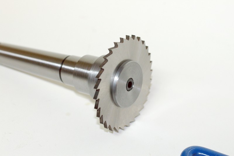

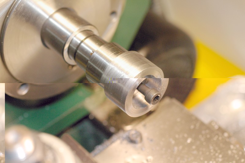

Basically what I did was make a up larger end piece bored out to 1" and nice fit on the blank end arbor that would allow me to then create a mounting piece to allow me to mount the saw with the 1" mounting hole. The big chunk that was bored to fit the arbor was fixed in place with Loctite 609, the whole affair then placed in the lathe (with drawbar of course) and turned to size (about 1-1/2" diameter) tap drilled for an M6 socket head bolt, the end then drilled out to 1/2" and then bored to 1.000" about 1/2" deep. The small hole was then tapped M6.

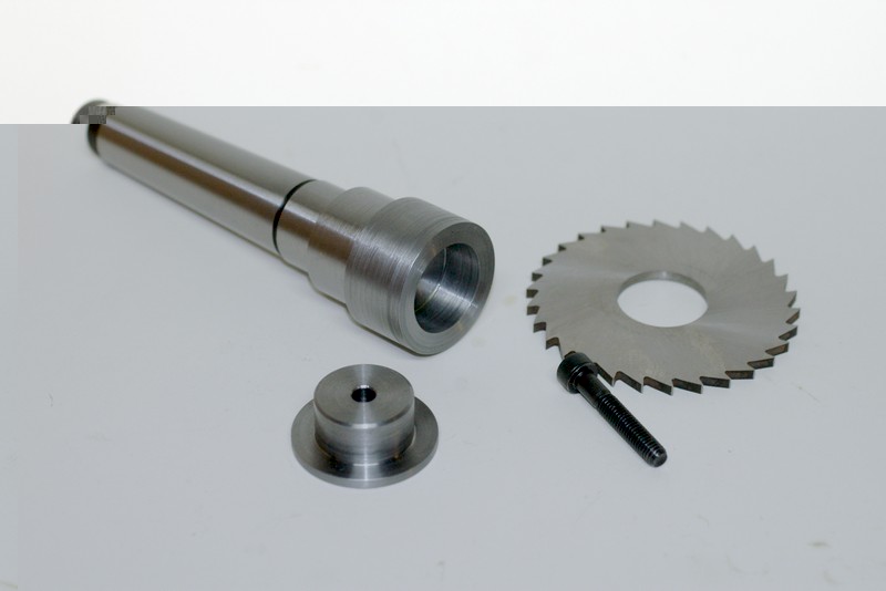

The piece that fits through the saw blade and into the end of arbor was then made. The stub end was turned to .999 inches so that it was a nice fit into the saw blade and into the bored hole in the end of arbor. The stub was then parted off, flipped over, faced off and clearance drilled and counter bored for the M6 socket head bolt.
The M6 socket head bolt is long enough that it threads into the added on bit of metal and also into the blank end arbor. I fully trust the Loctite 609 will hold this together in any use I will put it to on my lathe but the added insurance of threading into the 3mt arbor didn't cost anything and only makes good sense. If I was push this tool to the point that the Loctite 609 failed I would be pushing this thing past the limits of my lathe. Same reason I chose an M6 bolt - normally I would have used some a bit larger for something this size. The M6 is large enough that I can tighten everything up but no so large that will provide a bit of "give" if I happen to push the tool too far and too hard.
Total time was about 2 hours. I did wait over night for the Loctite to cure.
First photo show what I used to start with - a 3mt blank end arbor and two lumps of 1-1/2" leaded steel from the cutoff bin.
Second photo shows the arbor mounted in the lathe after having been drilled, bored, and tapped M6
Third photo shows all the parts and the fourth photo shows it all put together.
