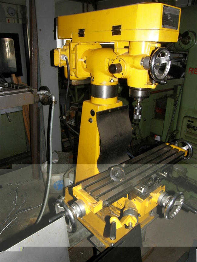

I own the german version of that mill.So far,I add a DRO and a phase converter to it and now I´m going to make a riser block.
And I´m thinking about a power feed for the X-axis
How did you modify the X- and Y-axes´s travel?
Regards,Ralph
This picture has been made before I bought that mill.It´s looking slightly better now.

Offline Xldevil
  • Posts: 91
Re: 6X26 Milling Machine riser block
« Reply #12 on: January 10, 2010, 01:15:37 AM »
He increased the Y movement by that much. The nut hits the casting and restricts the movement. I'm planing on doing the same to my mill as soon as I get a chance. Also I'll be cutting away the bearing blocks on the X travel screw. That will increase the X movement by about 2" or so.
Thank you.
That makes it clearer.
Unfortunately,if I would extend the travel of the axes ,I would have to buy new glass scales for my DRO also.
They are pretty new and have been not really cheap.
To be positiv,for my needs the movements are not cornucopian,but adequate.
Yesterday my riser block arrieved.It is turned to size and hollow bored,the 3 cut outs and the 6 holes for the bolts are milled already.
This has been done by a member of the steam engine community I belong to.He did the blank at his work.
Although I never met this guy in person,he gave me the blank and his work for free.Thank You,Eddy!
The center height of my Myford wasn´t big enough to turn that blank down to size.
It was weighing 30 Kg,the OD was 180mm.
Now it´s down to 15 Kg and 150mm OD.
As soon as it will get warmer,I ´ll make the bolts and the last fine cuts to the blank.
Yesterday the temperatur in my shop was 2°C.No fun to do metal work in such a surrounding.
Ralph
P.S. With the exception that my riser block has cut outs that I can use 6 short bolts instead of 3 long studs,the picture shows,how it will look,hopefully.
