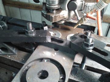

What are you using for gas to heat the BSM?  I saw the fire brick, a bit of a blue flame.  Again looking for what works.  I don’t mind trying new things but the wheel is not getting replaced until one of us fabricate an anti friction device.

Your idea to add a steel plate would give you allot more verticality  :med: , I just used Propane to do the heating nothing special .

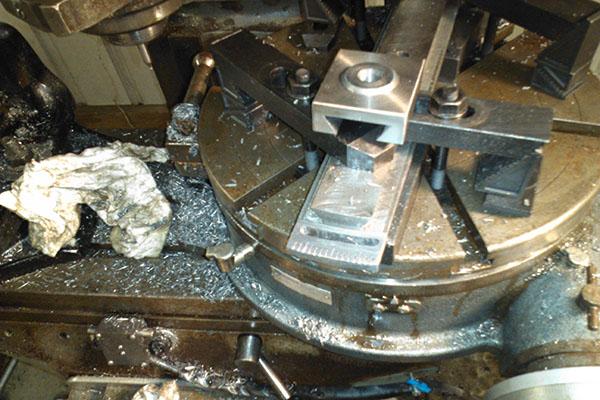

I have what I call the “Hard parts” done now.  I have the 4 foot by 3”X1/2” drilled and counter sank two days ago.  It is ready to be mounted to the Lathe.  The plan is to lay #1 bolt in the gap between the head and the bed.  I have a removable bed part that sounded great when I ordered the lathe.  Now after reading other posts, I am afraid to remove or drill it.  The 4 foot will run the full back side of the lathe with stand offs to turn it into a mono rail the attachment will ride on.  I am thinking rollers???  I have aim the rest of the mounts to align with the webs of the lathe bed.
After the mono rail is mounted, it is down to building the moving table the taper will ride on.  Rollers when not I use, clamps when in use.  The first thought was a set of bolt hole in the rail and move the attachment to matching holes.  With clamps it can go anywhere.  It will need something to keep the mono rail clean as it is rolling.

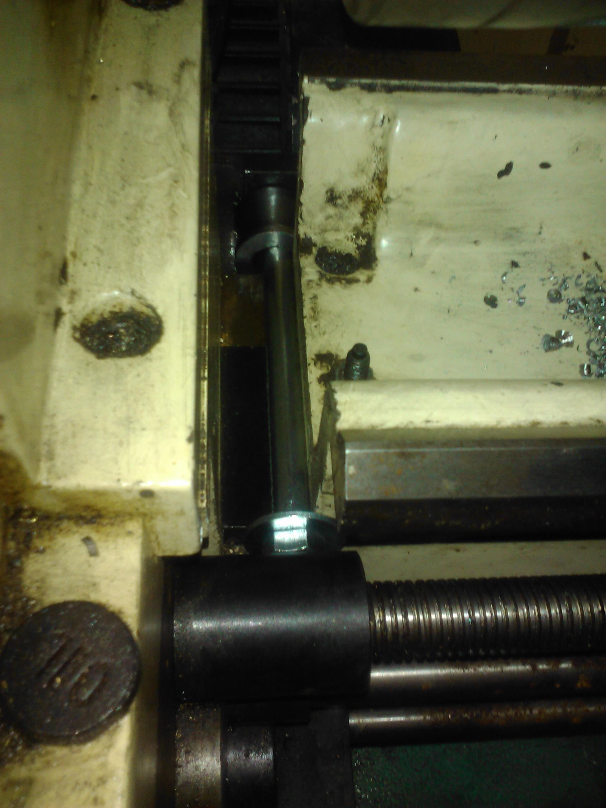

Here's a few photos
Lets no if you need any more  :thumbup:

The third photo you added is the big ticket!!  Wow I thought  the pin coming up was threaded and a tight mount from the cross slide to the top of the slide.   I am so happy I didn’t work on that part yet.

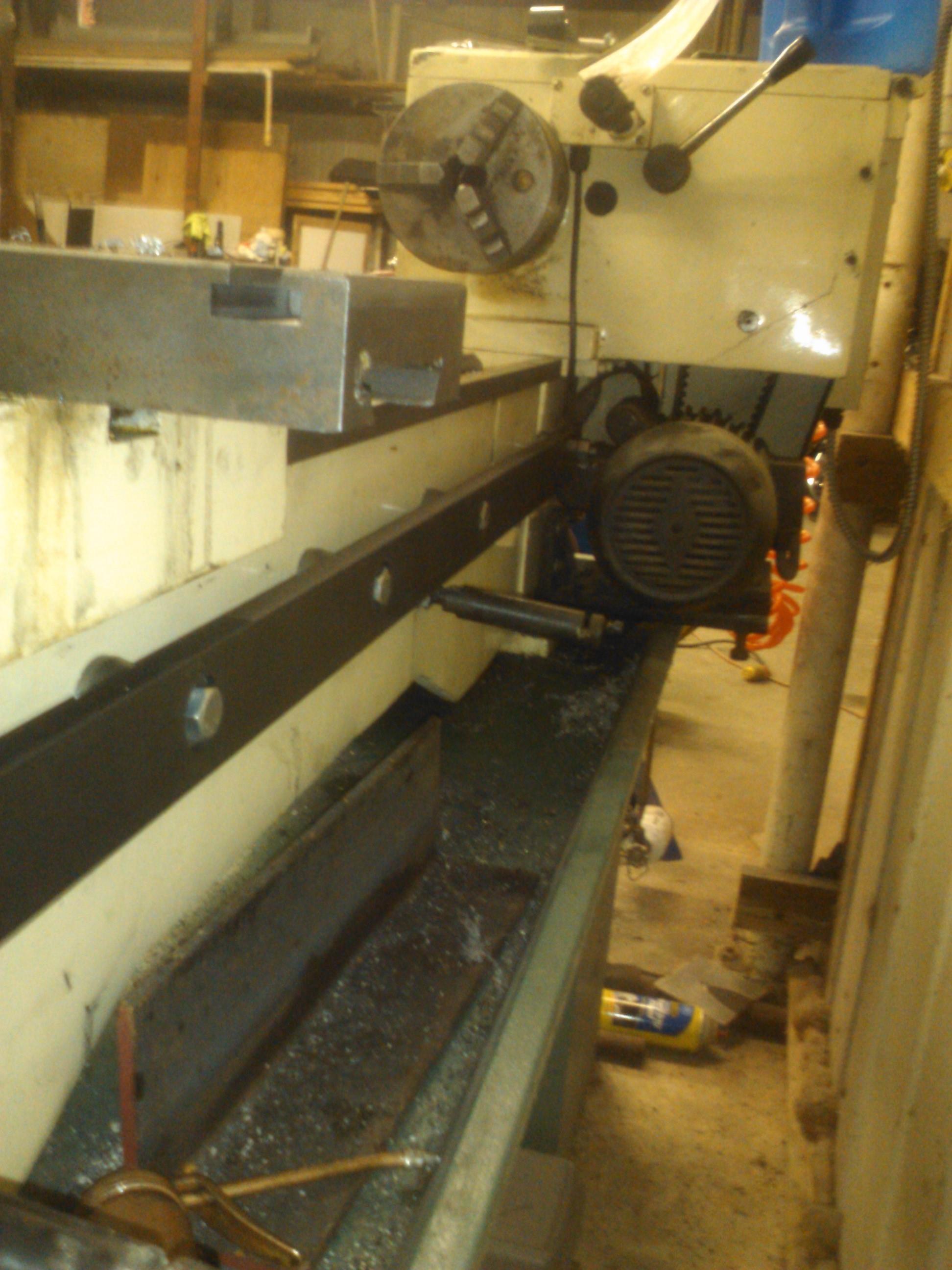

So I have the rail mounted.  It stand off the back at 1.75 inches on 5 bolts.  Going from the bottom rail in the back to the top closest edge I have a run out of .0014 over the four foot run.   I checked it at mid and its .0009.  Not bad for a hand drill.  I used the rail as a drill guide with drill guide inserts made for this.
One end, see photo (#1),  is just clamping across the top of the lathe.  This was due to the removable bed.
Thanks for the pics, it is helping SO much!!! :D
