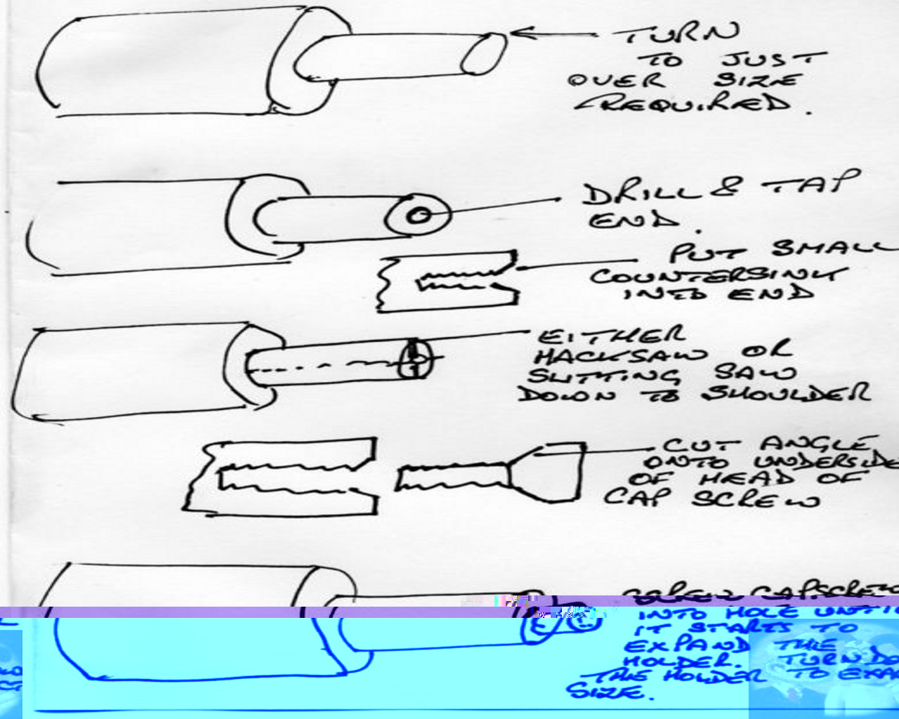

Could anybody explain how to make a 12mm diameter 20mm long expanding arbour that has to have a wider register to back material onto.  The other post somewhere made me think that this will make the tailstock die holder job easier but cant afford to buy the set from ARC at moment

Gerhard,
I hope this helps. Done in a bit of a rush, but should explain it OK
After you have turned down to right size, put part on and tweak screw to lock it on.

Thanks Bogs -ideal and not to difficult to make
20mm EN1A MS
http://i608.photobucket.com/albums/tt161/geroli/DSC_0001-3.jpgExpanding arbour
Tidy the back end
http://i608.photobucket.com/albums/tt161/geroli/DSC_0002-4.jpgExpanding arbour
Cut down to 12.5mm drill and tap m8
http://i608.photobucket.com/albums/tt161/geroli/DSC_0003-4.jpgExpanding arbour
add M8 bolt and skim to 12mm and the reduce and cut bolt to an angle
http://i608.photobucket.com/albums/tt161/geroli/DSC_0004-3.jpgExpanding arbour
Leaving a 12mm expanding arbour.
http://i608.photobucket.com/albums/tt161/geroli/DSC_0005-4.jpgExpanding arbour

But does it work Gerhard?
BR,
I find that run of the mill people understand a scrawled piccy much easier than a cad or works drawing.
This is how it is done on the shop floor when discussing how to get a job done.
The job is usually finished and all working before the engineer and draughtman have had time to draw it up.

An even simpler bodge is to tap the arbor end with an NPT (National Pipe Tapered) thread and use a (commercially available) NPT pipe plug to effect the spreading action.  I've done several that way over the years and keep a collection of smaller pipe plugs on hand for that use.

I was actually going to suggest a first cut tapered tap, and just by screwing a normal thread into it, it will expand enough, but I thought that was just too much of a bodge.
Not sure if you mean COC or the arbour but the answer is yes to both.  My mind understands COC better than any other explanation.
Used the arbour to cut 6 die holder tonight and they gripped well enough to reduce the body from 41 mm to 26mm in no time at all best of all is I could cut from one end and then turn piece around and finish the cut with no visible and feelable joint ( just to test consentricness)
Thanks again.
