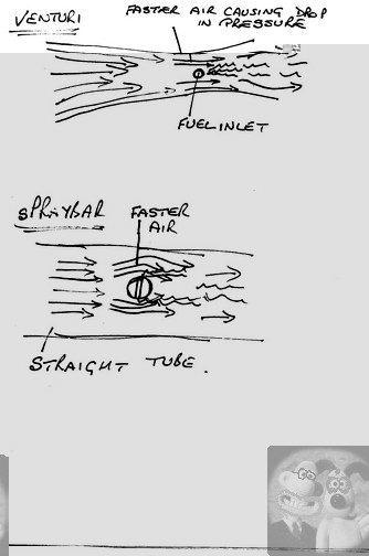

Re: Another version of how not to build a model engine
« Reply #79 on: December 01, 2009, 09:34:28 PM »
S,
I don't see any "venturi", just a straight hole to the engine in your drawing. I recall that the glow plug engines all had some kind of venturi on the carburator before the fuel got mixed in with the air.  :scratch:

bogstandard
« Reply #84 on: December 02, 2009, 05:26:34 PM »
You will find that you will get very little fuel suction as you have it.
The way the one you showed works is the spraybar acts as a backwards venturi. Instead of having the curved in walls of a standard venturi, speeding up the air flow and thus the drop in pressure, the airflow around the spraybar speeds up the airflow and it is that which causes the pressure drop, and so the fuel is sucked into the inlet. It is not as efficient as a venturi, but it is good enough for these small engines.
C-o-C explains the principle.
Bogs

bogstandard
« Reply #87 on: December 02, 2009, 06:11:43 PM »
You have to be very careful with angles in a venturi, if they are the wrong combination, you can actually get the air stalling and causing all sorts of problems, with dead air in places you don't want
I have just made a venturi for my spraymist system using a couple of basic angles that I know work. That is 22 degrees for going in and 6 degrees coming out, both inclusive, but I did away with the 6 degree one because of the way I will be using it. That should provide a steady pressure drop and hence suction once the engine is turning over.
Bogs
