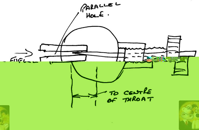

Re: Another version of how not to build a model engine
« Reply #52 on: November 19, 2009, 02:26:18 PM »
S,
so it's possible to use a mini-drill for making different taper
Are you using a tapered bore in your inlet?
If so, you will not get very good control as you are using two tapers, when they start to open up, they grow apart too quickly. You must only use one taper (the needle) to get good results.
Please see C-o-C.
Bogs

« Reply #53 on: November 19, 2009, 02:49:33 PM »
Bogs, thanks for demonstration. Anyway, I intend to use the taper on needle only, to keep things simple.
I'm not even quite sure, how to make a decent tapered bore, so I have kept myself away from it.
« Reply #54 on: November 19, 2009, 03:11:32 PM »
S,
I found that sewing needles had a much longer taper, so aiding much finer adjustment, and they were stuck into the threaded holder with Loctite. If you need to go up a size, just warm the holder up and the loctite will give way, allowing another needle to be fitted.
Bogs

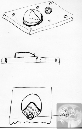

bogstandard
« Reply #67 on: November 27, 2009, 05:26:15 PM »
S,
Very interesting design for a side valve.
If you don't mind me giving you a suggestion which you might benefit from.
Even a basic bit of gas flow design might help with the problems you are experiencing.
It seems that the fuel might be being held around the valve area instead of the charge being sucked down into the cylinder.
If you look at the C-o-C that I have attached, I think just cutting the corner off the brass slug, like in the two top pics, would improve the gas flow a lot to give a more efficient burn.
If you ever needed to make a new head, the bottom picture shows how it could be improved even further, by shaping the head a little more, and moving the plug a little more into the corner of the cylinder.

« Reply #69 on: November 28, 2009, 06:55:15 AM »
Bogs, thanks again for the demonstration :thumbup:. The reason for the spark plug placement is, that I originally was going to add 'dieselish' compression screw(and contra piston) to cylinder head cover.
I'm not sure yet, what to do with that brass button. Maybe I'll bevel it.
