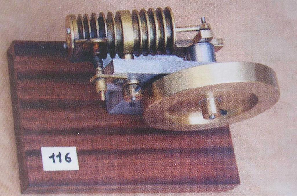

« Reply #94 on: December 15, 2009, 02:05:45 PM »
Hi all,
I know this has gone a bit quiet but I haven’t given up on it! If I’m honest, I am a bit disappointed that it didn’t run and I couldn’t even detect it trying to run. It passes I think the tests on Jan Ridders problem solving page. If anything I’ve done is a bit marginal, I think it was the cylinder and piston tolerances.
I haven’t done nothing on it, I spent a few nights messing around trying to get it to run but nothing. Then I thought, just finish the thing off and then try to troubleshoot. So I started by finishing the aluminium base off.
http://img.photobucket.com/albums/v287/NickG24/My%20Flame%20Gulper/2009-12-1215-02-40_0002.jpgNew Project Started!
I sanded it with the bosch mouse sander then got a stick with some wet & dry and rubbed it back and forth a bit. Then I did the same with some white spirit which gives a sort of matt sheen to it. I could really go to town polishing it but it takes ages to get the machining marks out completely so this’ll do for me. I haven’t put polish anywhere near it, just a quick rub with some wet & dry and oil seems to give a nice finish in my opinion. I decided not to put an edge around it as I’d probably spoil it if I didn’t take care in clocking it square on the milling table.
After this, I could then make the base from some brown stuff. This needed little counter bores for the screws underneath the alloy base. I was wondering which way to go to fasten it down. At first I thought, could make some nice hex bolts and bolt from top. Then I thought I could keep them hidden like the rest of the engine, but then I found some 0 BA screws with nuts so decided to drill through the lot and leave the nuts on top as a sort of feature. This meant giving my nuts a bit of a polish so to speak!
http://img.photobucket.com/albums/v287/NickG24/My%20Flame%20Gulper/2009-12-1215-02-29_0001.jpgNew Project Started!
Again, this was sanded with the mouse and oiled with teak oil. I did put an edge around this with a countersink in the milling machine. It worked ok but it was a mess on getting it clocked straight.
Then I decided to re-do the crank pin. As discussed before with Bogs, it’s better to retain the big end with a set clearance to stop it wondering. So I made this from stainless:
http://img.photobucket.com/albums/v287/NickG24/My%20Flame%20Gulper/2009-12-1216-20-15_0004.jpgNew Project Started!
Along with a little bronze spacer. This is the first time I’ve ever knurled anything since uni. The set of knurls I have are sort of sprung and you turn a screw which makes them closer together (need a pic!). I didn’t really know how much to tighten it so I went easy, but then of course you can’t go back and do it again incase it goes in a different place and mashes it up so the knurl isn’t very deep! I should have pointed out that it's a 2p coin in the photo! Not sure why I put it that way around!
I then assembled the engine together.  Here are some pics, looking much better on its real base!
http://img.photobucket.com/albums/v287/NickG24/My%20Flame%20Gulper/2009-12-1216-33-50_0003.jpgNew Project Started!
http://img.photobucket.com/albums/v287/NickG24/My%20Flame%20Gulper/2009-12-1216-34-26_0005.jpgNew Project Started!
http://img.photobucket.com/albums/v287/NickG24/My%20Flame%20Gulper/2009-12-1216-34-54_0006.jpgNew Project Started!
http://img.photobucket.com/albums/v287/NickG24/My%20Flame%20Gulper/2009-12-1216-35-10_0007.jpgNew Project Started!
Hope it doesn’t stay in here for the rest of it’s life! :
http://img.photobucket.com/albums/v287/NickG24/My%20Flame%20Gulper/2009-12-1216-41-00_0012.jpgNew Project Started!
The base was needed as it was wobbling about when trying to flick the flywheel over. Now it’s very stable so it will give me a better chance when I try to get it to run in anger!
Almost forgot to mention that I re-lapped the bore and made a better fitting piston and valve. How much better remains to be seen though! I also took the opportunity to extend the spigot on the piston slightly as I noticed my port wasn’t opening quite fully – not sure why, I must have calculated something wrong.
All I need to do now is the burner, then I am hoping my little tweaks and improvements are enough to get some life out of the thing. If not, I’m a touch puzzled. The only real thing I can think of is that I may have to revisit the cylinder and pistons again. I have a sneaky feeling that when I lapped it, it may have taken a bit of parallelism & circularity out of the bore. I think I have some adjustable reamers which may correct that, then make new piston and valve again.
There are another couple of suggestions with regards to the mass of my piston and valve as they aren’t hollowed out and the only other things that are different are the flywheel and con rod length. If anything the conrod length should improve things though and the flywheel should be ok, it should be better and don’t think it’s any heavier. If things such as the mass of the piston affect it’s running, it is, as I thought a marginal design.
Here is a little video flicking it over by hand, sorry about the lighting!
http://img.photobucket.com/albums/v287/NickG24/My%20Flame%20Gulper/_0008.jpgNew Project Started!
So, hopefully will get started on the burner tomorrow, and by the weekend, fingers crossed I’ll have some good news. But I’m not holding my breath, could be back to the drawing board I think!
Nick
« Last Edit: December 15, 2009, 02:08:34 PM by NickG »

To be honest, I'm pretty gutted it doesn't run. I haven't put as much care and attention into anything before, and I think it's a good improvement on all of my other builds. Maybe it's a step to far too early.
I still have options though. If it doesn't run now, hopefully I can get things nice and true and parallel with the adjustable reamer and plenty of oil, the only issue is the wall is getting pretty thin now, so if that doesn't work it'll need sleeving but still all is not lost.
If that doesn't work I'll be stuck for ideas and it would mean certain features of the engine that shouldn't be critical to it running, in fact are ... at which point I'll try making the poppin flame licker! There are a lot more examples of that running, infact that is one of the first engines I used to just stare at, mesmorised at exhibitions and steam fairs when I was a teenager! I have seen tiny flame lickers in the past that run really well and should only have a fraction of the power of this comparatively large one, unless this isn't a particularly efficient design.
Nick
ps I have also seen another design but never seen one working. I actually thought of this myself but then when was doing some research realised that somebody had infact already thought of it!  :doh:
It's a very simple idea so probably a lot of people have pondered it. Imagine an oscillating engine or wobbler but with the exhaust port not drilled. On the down stroke it sucks a flame in through the inlet port and once it gets to bottom dead centre the port is closed - it is effectively sealed. Gases cool down causing the under-pressure and atmosphere pushes the biston back to TDC. The only issues I see here are that the seal relies on a pushing the faces together which would cause a bit of friction., and  the timing is implicit in the design. Although by drilling the port in the right place you might be able to tweak the overlap etc.  This could be worth experimenting with but is a bit of a journey into the unknown and likely to make me even more  :( and  :bang:
When I first set my workshop back up a few years ago, a guy on CNC zone posted a pic of such an engine and one of his own which was unusual too (see attached)

Here it is with the bottom soldered in place and a bit of polishing. I haven’t fully got the plating off but it’ll do!
http://img.photobucket.com/albums/v287/NickG24/My%20Flame%20Gulper/2009-12-1700-41-23_0012.jpgNew Project Started!
Turning the top was pretty much the same as the bottom; just put this pic in to show the weird difference in surface finish part way across the cut. Must be something to do with the way it’s been cast.
http://img.photobucket.com/albums/v287/NickG24/My%20Flame%20Gulper/2009-12-2022-25-14_0001.jpgNew Project Started!
I drilled an air hole then a hole angled at 22.5 degrees. I was worried I wouldn’t get close enough to the cylinder with the wick if not. I then turned a stainless steel bush and loctited it in before a bit more polishing. The fit of the cap is a tiny bit tight really, well, it’s just there’s not much to grip to get it off! A pain when it’s ½ full as you tend to spill meths! I was originally planning on putting a little knurled knob on it but couldn’t be bothered!
http://img.photobucket.com/albums/v287/NickG24/My%20Flame%20Gulper/2009-12-2100-24-17_0006.jpgNew Project Started!
Pic of it on engine base:
http://img.photobucket.com/albums/v287/NickG24/My%20Flame%20Gulper/2009-12-2100-44-13_0007.jpgNew Project Started!
I tried to run it again tonight unsuccessfully. I did find out a few things though. On mine, it seems some sort of lubrication is going to be essential. Without it, the meths I’m using puts a nasty deposit on it pretty quickly, jamming it up. But with oil present, it doesn’t build up.
I’m not sure why it won’t run but have been in contact with Jan ridders who is going to do some experiments on valve timing and let me know the outcome. I just can’t get much out of it at all. The most promising results were when I slackened the rear collar off – this means that when the valve shuts, the suction pulls it further into the cylinder. I then almost get a sort of power stroke if the flywheel has enough momentum to carry it over – however, at that point the valve gets a bit tight in the bore so I clearly have clearance issues. If I take a little off it to avoid it being tight, it’ll probably not be sufficiently air tight. I think I may need to ream the cylinder bore out and make new piston and valve.
Also, at the same time, because the valve got stuck, me spinning the flywheel loosened it on the crankshaft and because I’ve stupidly put the grub screw somewhere I can’t get at, It’ll have to come to bits to tighten back on. In doing this though, I found another possible issue. When the flywheel was loose, I moved the conrod manually with the flame present and if I quickly put it past bdc, I felt a definite power stroke trying to pull it back. So I’m thinking of trying an experimental aluminium flywheel as I fear my big dia. Cast iron jobbie might have too high moment of inertia.
Another thing I noticed whilst studying the pictures, tips etc on Jan’s site was that his wick is about 2 x the diameter of mine. So maybe the width of flame needs to be much bigger. Not sure if I have scope in my burner to go quite that big so would need to re-make the lid.
Sorry if all that is difficult to understand. I find myself rambling when things aren’t going to plan! When I looked at the design of the engine, I didn’t think there were many variables as they were inherent in the design – how wrong was I! Still, hopefully I’ll get there one day.
Disappointing but lots of things to try. I just need to do them in a logical order.
