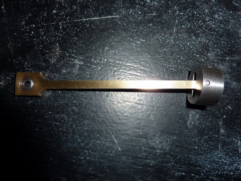

Another little niggly job that I had put off was milling the slot in the piston and drilling the hole for the gudgeon pin. So thought I might as well get that out of the way too.
Set up in the milling vice. First I centre drilled and drilled 3 holes, 1 in centre then the 2 extremes of the slot. I should maybe have used a slightly smaller drill than the cutter but I used a slightly larger one.
http://img.photobucket.com/albums/v287/NickG24/My%20Flame%20Gulper/2009-12-0221-38-20_0003.jpgNew Project Started!
Joining the holes up with the 3mm milling cutter:
http://img.photobucket.com/albums/v287/NickG24/My%20Flame%20Gulper/2009-12-0221-47-21_0004.jpgNew Project Started!
At first I started taking tiny cuts, but then thought I’d try half depth – that worked so it only took a couple of cuts. Think I could have done it full depth to be honest but I am still finding the limitations of the milling machine. I’ve given it a bit of a slagging off recently, but it actually works pretty well, it’s just not the highest quality but I guess you can’t expect that anyway. Would love a Harrison one to match the lathe!
Here is a pic of the finished slot. It worked reasonably well. If I wanted a really accurate thing I would have had to use a smaller cutter then take extra cuts to come up to size. But I knew this 3mm would give a little more than 3mm, which is what I needed on this occasion. I don’t want any friction between the piston and con-rod.
http://img.photobucket.com/albums/v287/NickG24/My%20Flame%20Gulper/2009-12-0222-01-30_0006.jpgNew Project Started!
Now all that was left on the piston was to drill the hole for the gudgeon pin. For this I just clamped in the mill, lining the slot up parallel to the top of the vice jaw by eye. I also just aligned the point of the centre drill to centre and edge by eye  - good enough for this since there is still scope for adjustment with this engine.
http://img.photobucket.com/albums/v287/NickG24/My%20Flame%20Gulper/2009-12-0222-16-36_0007.jpgNew Project Started!
Drilling the hole gently. This cast iron cuts like butter anyway though, a joy to machine.
http://img.photobucket.com/albums/v287/NickG24/My%20Flame%20Gulper/2009-12-0222-21-27_0008.jpgNew Project Started!
Test fit of the gudgeon pin material. 3/32” stainless. It is a lovely free fit but no play. The steel measured 2.36mm I used a number drill that measured 2.38 on the shank.
http://img.photobucket.com/albums/v287/NickG24/My%20Flame%20Gulper/2009-12-0222-23-18_0009.jpgNew Project Started!
Cut the gudgeon pin to length and faced the ends. 1mm shorter than the dia of the piston.
http://img.photobucket.com/albums/v287/NickG24/My%20Flame%20Gulper/2009-12-0222-28-54_0010.jpgNew Project Started!
The bearing surfaces will be those in the cast iron piston, it will be a tight fit through the rod so maintaining its position in the centre of the piston.
Here’s a bit of a mock up on the aluminium that will be the base plate:
http://img.photobucket.com/albums/v287/NickG24/My%20Flame%20Gulper/2009-12-0222-48-18_0011.jpgNew Project Started!
Unfortunately the glass burner I was planning on using won’t fit to give me the right flame position so I will need to make one.

Made a little more progress tonight. I thought I’d better turn that awful looking bit of brass plate I’ve been staring at for the last month into something – the connecting rod.
Started by finding a drill that would suit the 7mm bearing. Found one just under and did a test drill. It was ok, a sliding fit but I would loctite it. The brass was bloody hard stuff though.
Milled it square, to width and to length:
http://img.photobucket.com/albums/v287/NickG24/My%20Flame%20Gulper/2009-12-0322-41-19_0001.jpgNew Project Started!
Then marked it out a bit – well I knew what it meant! Incidentally this rod is 20mm longer than the drawings to account for my larger flywheel, slightly different design too.
http://img.photobucket.com/albums/v287/NickG24/My%20Flame%20Gulper/2009-12-0323-16-16_0002.jpgNew Project Started!
Back into the mill to drill the holes while it’s a uniform shape and more rigid.
http://img.photobucket.com/albums/v287/NickG24/My%20Flame%20Gulper/2009-12-0323-31-09_0003.jpgNew Project Started!
Wasting away the sides to give the narrow section:
http://img.photobucket.com/albums/v287/NickG24/My%20Flame%20Gulper/2009-12-0323-41-17_0004.jpgNew Project Started!
I then flipped it flat in the vice and milled the radii making sure I wasn’t climb milling. Stupidly, I decided I’d take a lick off the end but because it was only gripped by the narrow centre section the mill tried to pull it upwards.  :doh:  :wack: I really do some silly things sometimes! Luckily I backed off straight away and was able to clamp it back straight in the vice. There is a tiny machine mark on the end now but nothing to worry about really.
http://img.photobucket.com/albums/v287/NickG24/My%20Flame%20Gulper/2009-12-0400-23-59_0005.jpgNew Project Started!
Fitted to the piston and the bearing loctited in:
http://img.photobucket.com/albums/v287/NickG24/My%20Flame%20Gulper/2009-12-0400-38-43_0006.jpgNew Project Started!
Another trial mockup, nothing is bolted down here but it seems pretty good and if I bolt the bits in the right place it will be very free running so that’s the first tick in the box.
http://img.photobucket.com/albums/v287/NickG24/My%20Flame%20Gulper/2009-12-0400-45-35_0007.jpgNew Project Started!
It was really the first time I got to try the ‘pop’ test with the piston on the rod and something to pull on. The vacuum was more than I thought with the valve covering the port it took quite  a bit of force to pull the piston out which resulted in quite a tuneful pop! So that made me a bit happier – ½ a tick in the box I reckon – don’t want to count my chickens!
Base, burner and brown stuff left to do!  :ddb:
Nick
