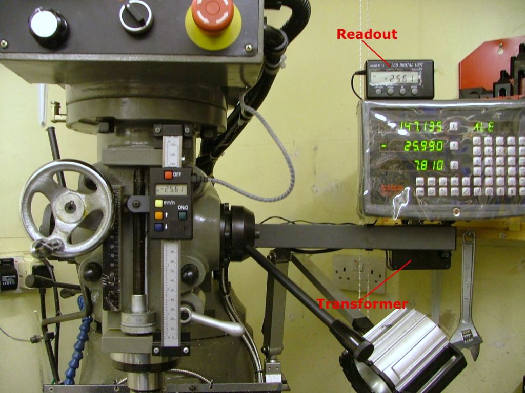

Nick G,
Correct me if I am wrong but after a quick Google search on the sieg X3 I see it's got 150mm standard minus 50mm that’s only 100mm travel which is a third less.
John,
A quill scale is also good for boring to depth. I had 4 scales fitted to my machine (quill and knee), that I had to take off before it went back. The only trouble was I bought it before Miester brought out their Magna 4 DRO so I had to unplug one to plug in the other. Now that I have received the new mill it came with a Sino 3 axis DRO. So now with the 2 sets, I can now combine the quill and the knee and maybe the Y axis and the ram don’t know yet. I have got the wiring diagrams off them to wire Sino and mitutoyo scales to the Miester and vice versa if they need be changed over, as I picked up a few mitutoyo scales locally on eBay also. They also sell a rotary encoder models but don't think the resolution would be fine enough for putting inside the head and turret for traming. Maybe the way things will go in the future?

Dave,
I have a 3 axis Sino on the mill, but for the rare occasions I do use the quill, I put a cheapo on there, linked to a small readout, all powered from a tranformer, batteries not included (or required), just a cap across the battery terminals in the read head.

Re: Fitting a DRO to a Seig X3
« Reply #24 on: November 13, 2009, 01:37:33 AM »
Stew,
 That looks to be a Miester DRO head without the name and Sino scales which have a good reputation. I don't think you will have any trouble with it as mine is still going strong with no troubles after 3 years. I see you don't have scale cover on. Are you going to put come on? As they will get chips and dust in them, especially the Y axis as it's on its side.
I've got the covers fitted I left them off for the photos so the machine interfaces can be seen, a good point about keeping the chips and coolant out.
Thanks for your replies and interest chaps
