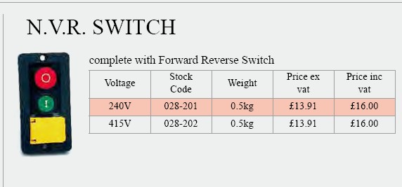

The motor is reversible and only needs a switch if I could find one.

Re: Union Lathe .... Help !!!
« Reply #24 on: October 12, 2009, 04:32:20 AM »
There is your answer then Darren.
Find your changeover switch and reverse the motor.
The one at the bottom was the one I used and was from Chester UK.
