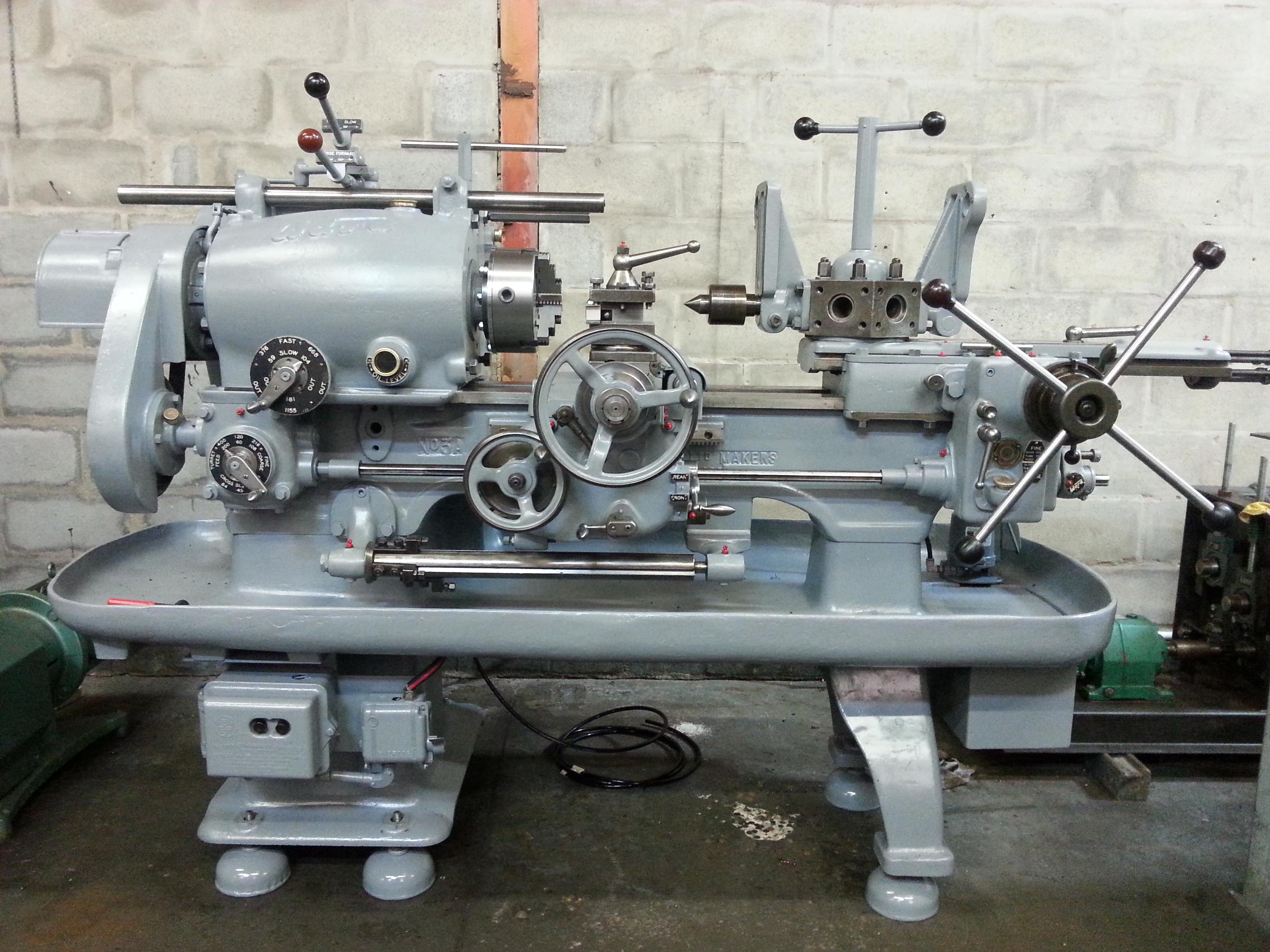

in a past life i spent a few years setting up and operating various capstan and turret lathes mainly Ward 3a capstan bar lathes and Ward 7t combination turret lathes and became quite familiar with the delights of setting up "rolller
boxes"and "coventry dieboxes" it was quite a bit of a bind setting up anything up to twelve tools and thier related stops and the art of aligning up the turret arms with fag packets and fag papers capstan lathes where quit a useful tool in their day for batch production that kind of work is now done by cnc machines
http://i998.photobucket.com/albums/af106/g6fow/ward3A-1.jpgCapstan Lathes
http://i998.photobucket.com/albums/af106/g6fow/ward7T.jpgCapstan Lathes
Cheers Paul

« Reply #10 on: July 20, 2014, 12:53:22 PM »
Hi Skiprat.
im setting up n ward 3a turret for vesconite bushes. It cuts 0.08mm taper over the lenght of 80mm.
What is the best way to make sure the chuck and the turret is 100% aligned.
