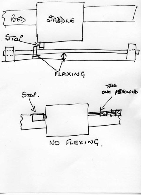

I have an idea for the saddle stop that would give me
1 )   Quick set up
2 )   No loss of any dimention / function
3 )   Can be used to as a left or right hand stop?
4 )   IS THRE ANY THING I DIDNT THINK ABOUT??????????
Il post thw bas and wait for some feedback / warnings before commiting to the design.

I looked at making one like that for my machine. Unfortunately I couldn't fit one because of the position of the operating shafts on my machine. I was looking to actually use the design for having an auto half nut setup when thread cutting. It would allow higher speed to be used when single point cutting.
The only problem I can see is that because of the length, and the associated flexing, you won't be able to use it as a precision saddle stop.
The saddle stop should be as close to the bed face as possible.
Have a look at this one, it might give you another idea of the way to go.
http://www.hemingwaykits.com/acatalog/Multi_Position_Saddle_Stop___Myford_7_Series.html
Bogs

Gerhard,
Your problem lies in the fact that you are stopping the saddle a great distance from the actual running face and using a flexible bar.
I have done a C-o-C to show what I mean. Unless you used something like a 25mm bar or larger, the flex could be substantial because of the moment forces imparted by turning the handwheel.
This is what I was on about, and when I get the time, I will knock one up for my lathe.
http://www.hemingwaykits.com/acatalog/info_HK_1840.html
This also gives a saddle clamp as well as an infinitely variable stop.
Bogs

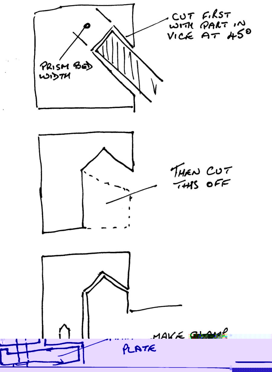

Bogs to try to get as close to the lathe bed as poss I tried one of these
http://i608.photobucket.com/albums/tt161/geroli/DSC_0040.jpgSaddle stop for the 918 lathe
But the edge of the lathe bed on the front bottom is not deep enough ( see left part of the COC)
http://i608.photobucket.com/albums/tt161/geroli/DSC_0036.jpgSaddle stop for the 918 lathe
The ones in the link Cliff sent are all deep enough that the clamp on the bottom of the lathe bed oposes the peak of the v in the bed and makes the whole thing stable. Right part of COC
Have had some more ideas to improve the other design but just need to run some tests - will update as soon as I have something solid.

Gerhard,
The one on my lathe is very similar to that, and very easy to make. See C-o-C.
Bogs
