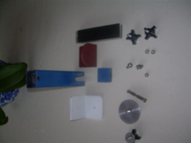

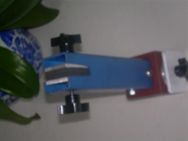

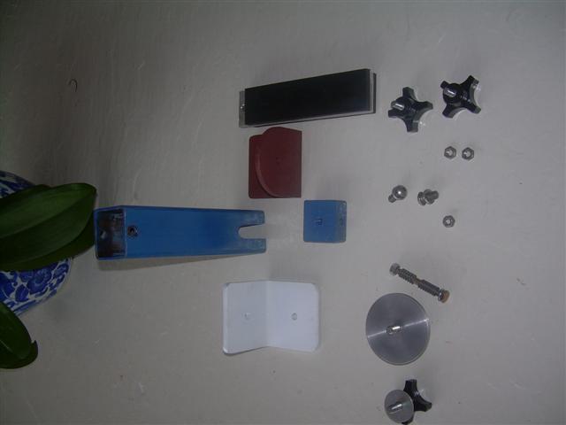

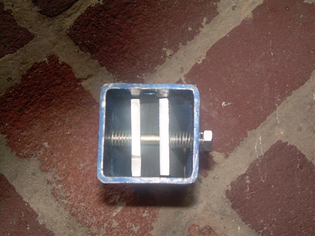

The vise stop is indeed just a clamp.  I made it the first session of school.  You can get the identical thing at Enco for a few bucks, but it's an easy project.  The center pin is just a SHCS with a small spring around it.  The side shafts are a press fit in one jaw and a sliding fit in the other.
