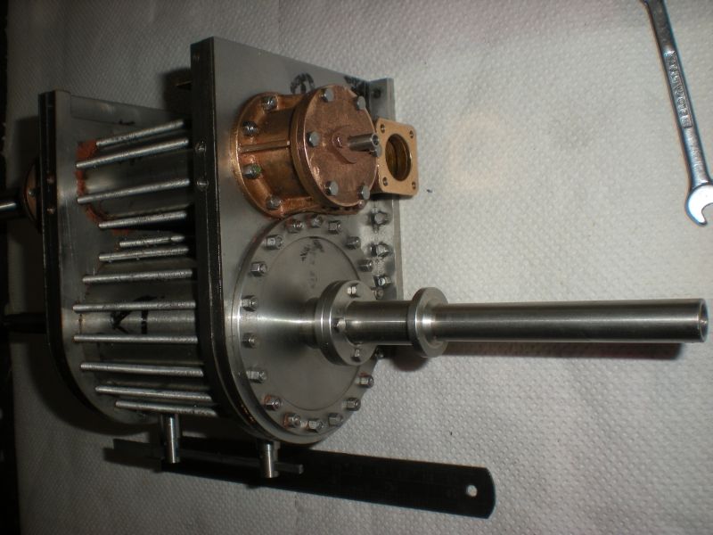

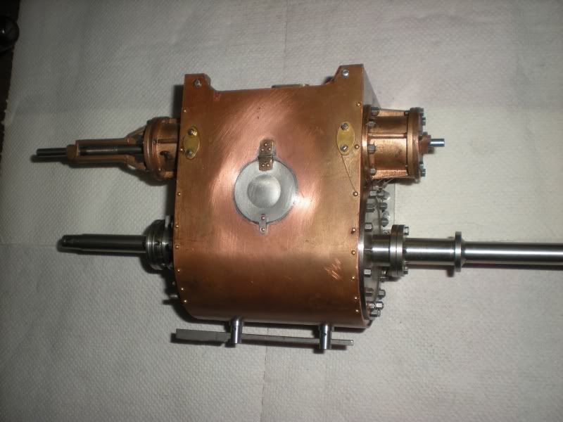

As requested, pictures for you addicts.
The BR74 Project at Berliner-Eisenbahn is using assembled cylinders, no castings, built up from plates, turned parts and some castings.
The exact detail is a little secret... All nuts and bolts visible from the outside are to scale.
This is for a 5" loco in 1:10 scale. The cylinders are quite large, larger as some the cylinders of some 7,25" locos, see the ruler.
The cylinders have pistonvalves with inside admission. The exhaust from the rear end is routed by an extra channel through the cylinder block to the front. This system was used in many of the Prussian designs.
Today, I completed the assembly of the cylinders, almost. The cover around the cylinders was made from some copper sheet which was handy. The draincocks are like the originals.
Have fun
Yorkie

Hi Yorkie,
Was the original design of the cylinder like you have produced, using tubes and endplates?. Or was the original a complete casting, and you are just replicating the outside detail?
Whichever way you look at it, it is a very innovative design, to produce a locomotive cylinder from just tubes and plates.
I was just asking because during the war years and immediately following, producing castings I think would have been rather difficult, and the tube plate method might have been used on the full sized loco because of supply problems. I am sure it would have worked just as well in full sized.

Hallo Bogs
It is a cost saving method. Of course the design of the KPEV (Royal Prussian Railway Authority) of 1912 was using solid cast iron cylinders. This approach avoids any complex milling operation e.g. for the steam channels, as these are now tricky holes in the sandwiched plates.
Some modern (reconstructed) locos at the small railways in Wales now have been built using exactly this approach! In case the old wooden patterns of the cast cylinders are lost, than this is the method of choice.
Yorkie

Hi Yorkie
Thats very interesting thanks for showing.
I've seen a similar fabrication method for cylinders employed by a chap in Sweden (i think), but he silver soldered the parts together, from your pics it looks like you've bolted the parts together with liquid gasket seals is this correct?.

Hallo Stew
The sealant is Loctite 5920, what is also used to fix oldtimer cars.
There is a possible drawback: After years, I may need to change pistonrings. When I unscrew the nuts on one side, the cover on the other end may come loose when there is no more tension on the studs. Then the reassembly of the cylinder on the locoframes, under the runningboard, will be a little difficult.
Yorkie
