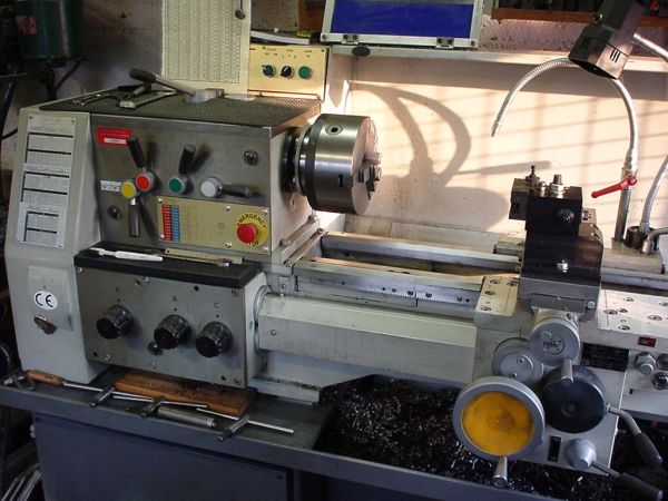

Didn't realise how tight these were for room.
First thing I did with my 'new' lathe about 10 years ago was to take the top slide off and replace it with a big steel packing block.
This has two advantages, one was extra rigidity and the other was I could drop the hight slightly to allow me to use bigger tools.
My take on this was the extra rigidity for 95% of the time soon outweighed not having the taper turning facility.
I haven't lost it as two nuts allow the original top slide to be refitted for the odd taper job, in fact it sits in the cupboard with a normal tool fitted in the original 4 tool holder.
The small cutaway at the back is so the block can travel in front of the tailstock without hitting it.

What lathe is that John, nice idea btw.... :thumbup: :thumbup:
Re: Tailstock Locknut.
« Reply #4 on: July 19, 2009, 06:24:28 AM »
Darren, that makes me feel much better......  :D
John, that`s a good idea! I rarely use the compound slide.....  :scratch:
Hmmm.......  :thumbup:
