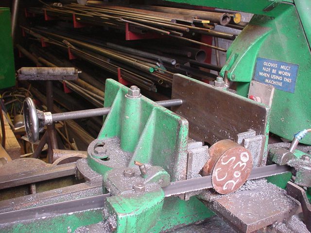

Whilst the common generic Chinese bandsaw that many of us have is a very versatile tool to have in the workshop, it does have one small annoying habit.
Cutting short pieces can present some problems when trying to hold securely in the vice. I have seen many adaptations on the net to overcome this issue, inc screwing a small vice to a block of wood, but none are perhaps as simple a solution as this idea.
The problem
As you can see the moveable vice jaw is easily cantilevered holding short pieces. The work piece is not only insecure, it's hardly held at all.
Some people insert another piece of similar size stock in the jaw in an attempt to keep it parallel. I find that even if you have another piece of stock of the same size it does interfere with the clamping pressure of the piece to be cut. esp if it's really short and only just held by the jaws.
If you have nothing similar in size then you are sunk.
A simple solution.
Remove the jaw and drill and tap a thread. I chose 6mm, but it could be anything that fits.
By using a bolt, or even a bit of threaded bar there is now all the adjustment that could ever be needed. No need for spanners and lock nuts, just adjust with fingers and leave it loose for ease of future adjustments.
Its simple and effective. The movable jaw can even be slid right over towards the blade to give a firmer hold.
My excuses. I could have turned up something fancy, but have you seen the state of my bandsaw.... :bugeye:

Re: Bandsaw Mod
« Reply #1 on: July 08, 2009, 05:40:06 PM »
Yup did that 20 years ago.
Also handy to use a couple of vee blocks to hold short rounds.
John S.
