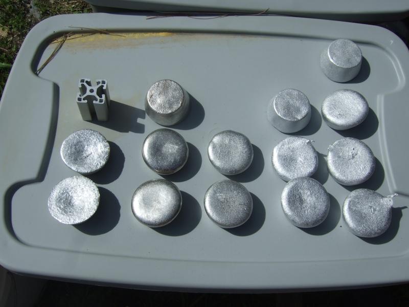

 Here's a shot of some of the ingots poured. They are lined up in columns by type. The worst stuff is in the first column on the left. It was poured from donated X shaped extrusions, one of which can be seen at the head of the column.
Column number two had the best quality aluminum (in my opinion) for casting. It was from an automotive bell housing.

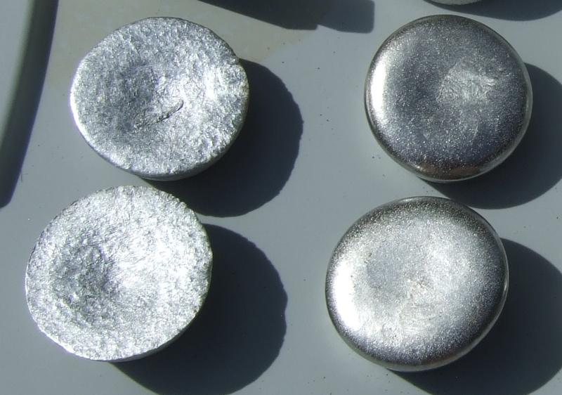

Some closer views of the ingots:
Worst, Column 1, X extrusions. All of the muffin ingots were poured to the same degree of fill of the same mold. You can see how coarse the grain structure is, how great the shrinkage was, and the lower height, and deep shrink depression. Also how dull the metal looks.
Best, Column 2, automotive bell housing. Same degree of fill, same mold as column 1. The grain is almost imperceptible. The muffin has almost the same puffy shape as poured, far less shrinkage, minimal shrink depression, and as shiny as a new dime!  :thumbup:

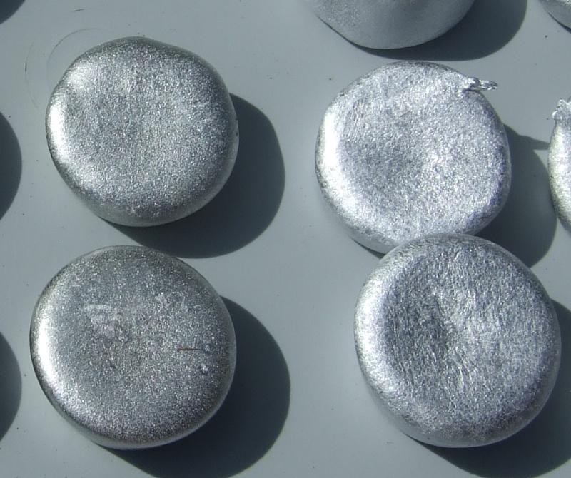

  • Posts: 6940
Re: How Not to Hate Casting Aluminum
« Reply #4 on: May 15, 2025, 05:29:46 PM »
Finally, Ingots from column 4:
This was a mixed bag of leftovers, including a couple of sprues, some bicycle brake levers, a lot of long thin extrusion scrap which I kept piling in through the top of the furnace, and even some spills from former casting sessions.
And yet, the ingots look pretty good. Probably the sprues and spills were high quality casting stock originally, and these mixed with extrusions produced muffins with qualities somewhere in between the others. Fairly good grain, reasonable shrinkage, rounded shape to the ingot. Definitely usable stock.

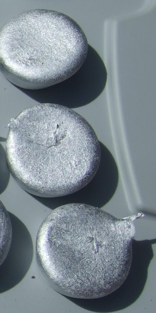

« Reply #6 on: June 13, 2025, 03:39:55 PM »
I did another set of consolidation melts today. I'm trying to get more room in my shed, so melting stuff down kills two birds with one stone. Plus it's fun. I thought you all might like to see the results from some other scrap types. Result, about 30 half pound ingots.
Stock: I melted down a light aircraft wheel hub, a small Tecumseh engine, and a bunch of thin architectural extrusions, plus small odds and ends.
The Tecumseh engine was probably about 4 hp horizontal, which I removed most of the steel and iron from. Actually, see my Avatar up left? Well that's it! You're seeing an exhaust and intake port view of it. It's been hanging around in storage for many a year. It had thrown a rod, so not much use.
I don't know where I got the aircraft wheel hub from. It was conical shaped with internal ribs. I think that was its use.. not totally sure.
The thin extrusions looked like window molding stuff.
Anyway here they are as muffins. The motor made beautiful shiny puffy versions with fine grain. The wheel, meh, not as nice, but usable, fairly coarse grain fair amount of shrinkage.
And the mixed scrap and extrusions turned out pretty good, considering. Maybe just a little better than the wheel aluminum, finer grain for sure.
I've taken to marking muffins now for future reference when mixing, and matching for purpose.
Another way not to hate casting aluminum!
Endnote: BTW I test every major piece of casting material before melting, by taking a small sliver off of the piece, and subjecting it to my MAPP torch. We don't want to mistake magnesium for aluminum! Magnesium burns with an intense white flame. And as I found out a few years ago upon doing the same test, the nice big VW bug engine block I was given was made of magnesium. Darn!!!! that had a lot of material in it.
And this time I was glad I did, as well. An old carburetor found half buried in the ground from some ancient vehicle seemed suspiciously heavy. A little piece of it turned yellow in the torch flame -- zinc based pot metal. Not good to mix with aluminum. In fact I do wonder if the casting defects seen in Ironman's video were due to zinc contamination. Zinc has BIG shrinkage, and coarse crystalization, not unlike the appearance of those castings.
