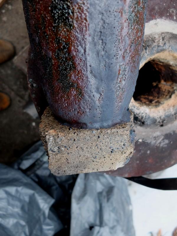

Well the part is cast:
First fill -- I just used a section of steel tubing as a pouring cup. I mainly used it to try to keep sand inclusion in the sprue to a minimum so I can re-melt it later without a lot of junk in it.

Here's the first pour out of the sand into another bucket. I was glad to see the mold looked like it filled:
And flipping it over also looked good:
