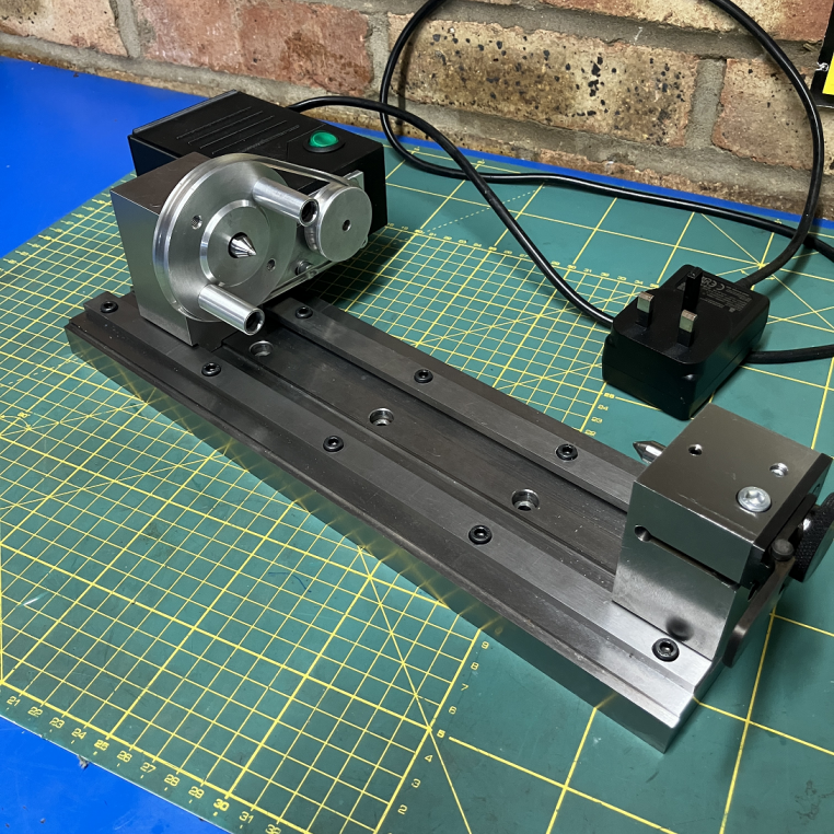

Anyway, little project that I did last year. Posted the entire build story over on the HSM site but I thought I'd share it here too.
I have a surface grinder (J&S540) but needed to grind some cylindrical stuff, so made up this fixture that fits on the mag chuck.
It will take 9"/225mm between centres, with a centre height of just under 3"/75mm, and has a workspiece speed of around 260rpm.
The rear centre is spring loaded and moveable via a thumb lever, and the rear centre block has a flexure for taking out taper.
It was fun to design and make, and works very well.

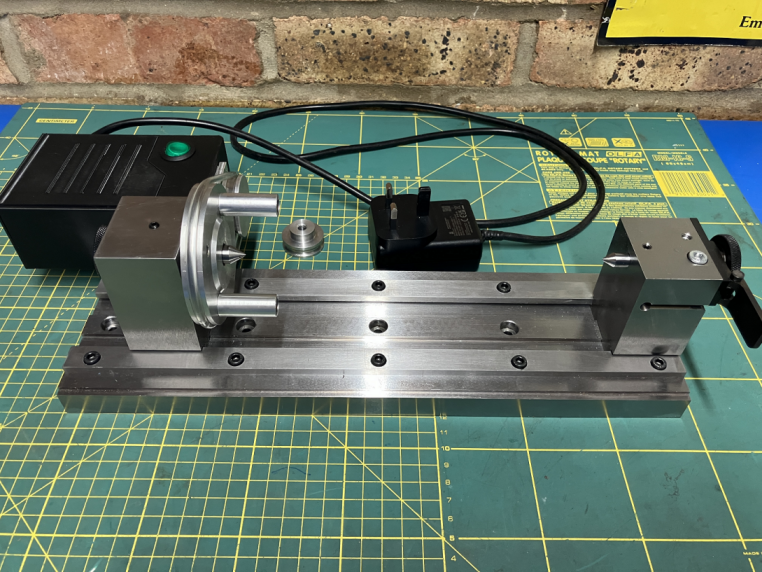

« Reply #1 on: January 14, 2025, 06:30:17 AM »
A second picture, as it appears I cant add this to the original post.
