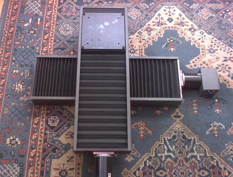

I purloined and few bits from a scrap wire-eroder that have inspired a couple of project ideas - (it was working and only scrapped because it needed to be moved and the only way to get it out of the workshop was in bits)
From the U/V wire-angle mechanism I have an incredible two-axis slide unit - cross roller guides, 1mm pitch ball screws  , preloading gears  has to have been designed for micron precision or better . But more on this later...
From the head unit I have a couple of Rexroth double row ball linear guides . These are far too good to use on the plasma cutter I had planned , hence this surface grinder idea.

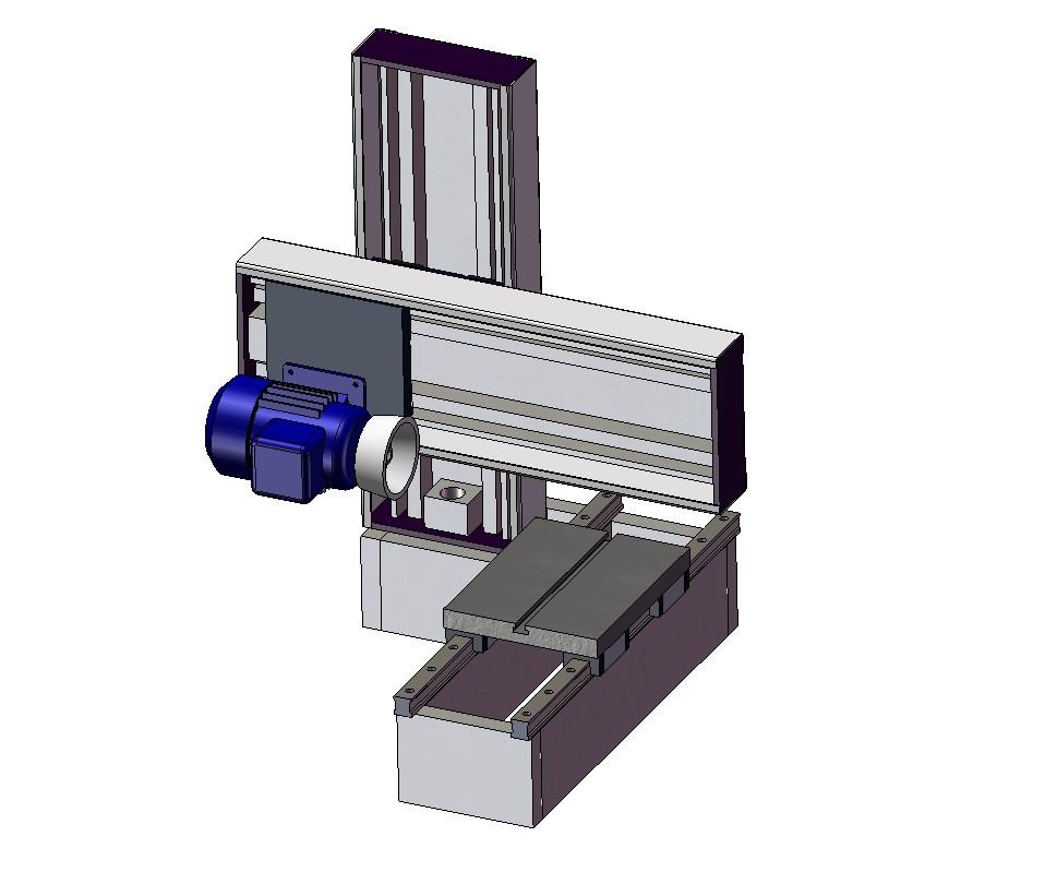

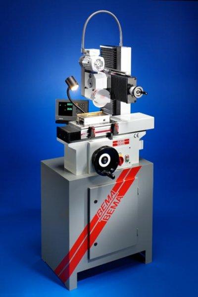

A while ago , on YouTube, Stefan Gateswinter' showed off his new Bema surface grinder (https://www.bemagmbh.de/en/range-of-services/lever-operated-flat-grinding-machine/)  I liked the compact size and novel layout.  I also had a pair of US made servo linear axes modules very much like the ones used on the Bema , I just needed something for the table to slide on.

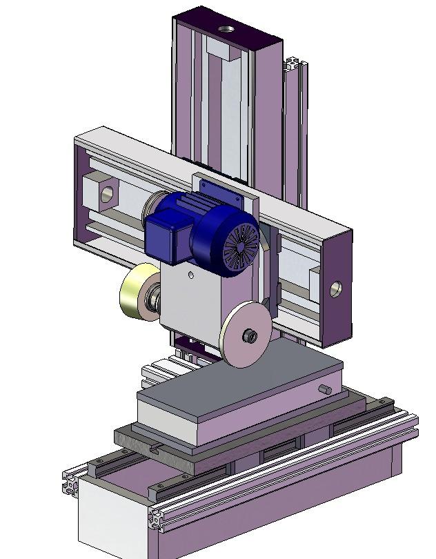

The design is a bolted aluminium construction  , using 25mm plate for the base and 10-15mm plates to stiffen where required . The table will have a travel of about 11inches (280mm) with the head traversing 14" (350mm) or so.  It should have about 12" (300mm) above the table .
I'm not sure about spindle ATM. I have an old Black&Decker grinder spindle (yes I know B&D but it is from the days when they made a better class of tool)
I'll probably use a chain driven table (Like Bema) but may motorise the Vertical and traverse since it will be easier than adding handles .
If I can find a suitable head unit, the Z will have a 0.1um Mitutoyo scale also courtesy of the wirer :-)
Coming soon ... microscope and/or Nano-mill  :proj:

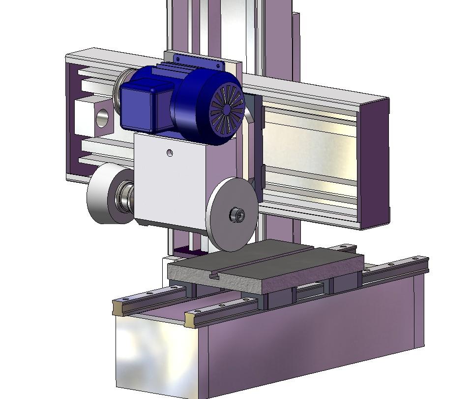

I have been thinking recently about putting linear rails on my converted surface grinder. although I would put the rails upside down rather than the way. This way I figure there would be less chance for the grinding dust to sit on the rails and damage the bearings.
I know you could cover them but I still feel there is the risk. I do like that design though.
  • Posts: 1225
Re: Surface grinder concept/project
« Reply #2 on: October 27, 2023, 06:08:55 PM »
I'm sure it would work fine.   The table is supporting the whole length of the rail  so it operates like a mill where the bearing is directly under the cutting force
I've gone for the stationary rail which keeps the table lighter and easier to traverse manually.
The dust cover is a problem, I can only find flat bellows ( rather than the inverted U shape I would prefer), so I am thinking about light air pressure to reduce dust ingress , perhaps using a hoover motor as a pump.

Update on the spindle assembly.
Like the Bema model, the entire head can revolve . so to see what it would look like, I added a cup wheel the the rear of the spindle , it could be used in a horizontal vertical fashion a little like a Blanchard .
« Last Edit: November 23, 2023, 06:08:30 AM by BillTodd »

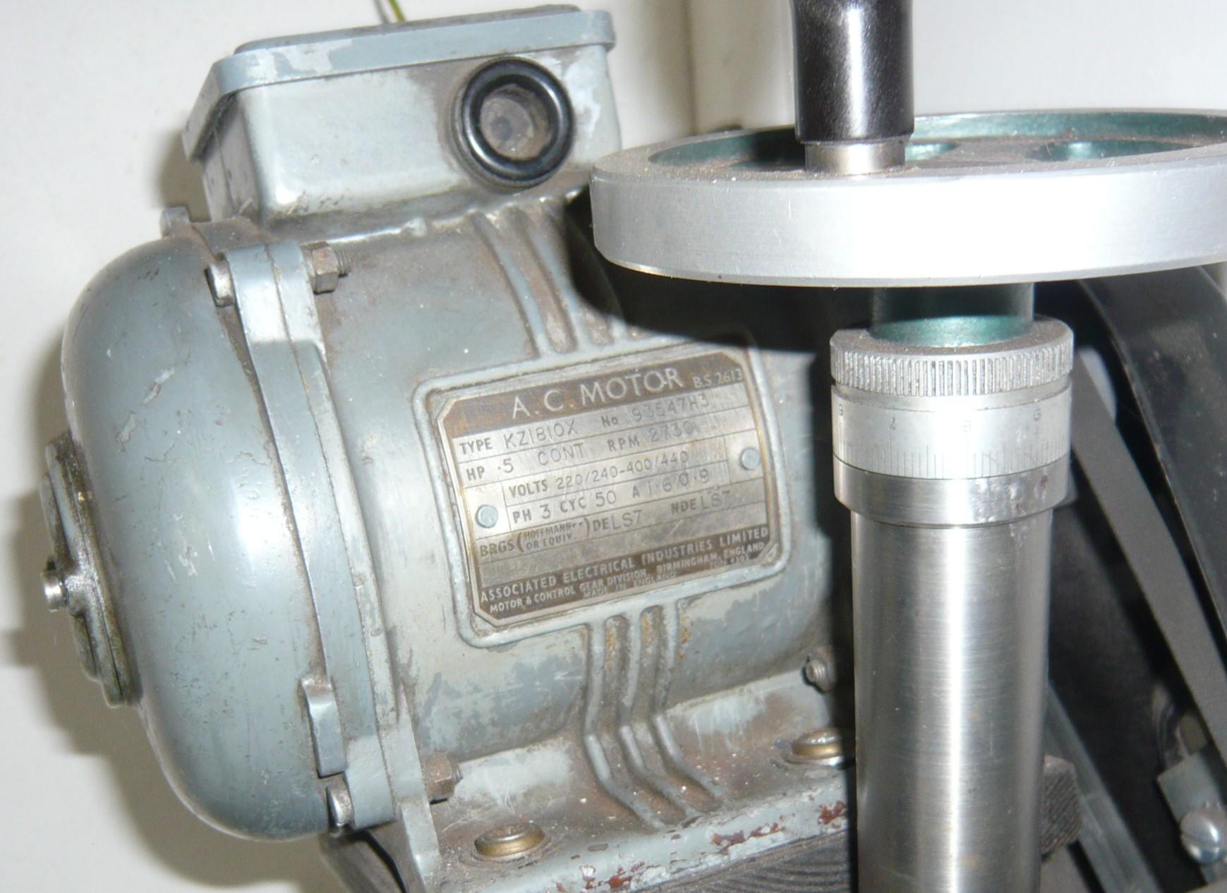

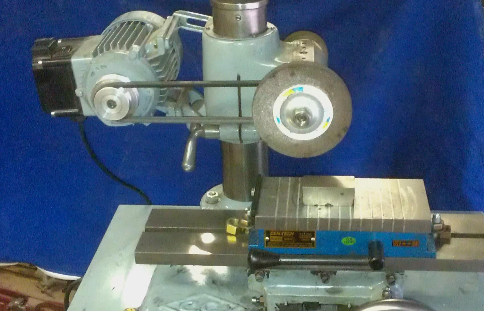

This is my small surface grinder. I made it from the bottom half of a Dore Westbury Milling machine and fitted a modified large Lathe toolpost grinder for the grinding wheel.  The table runs on small ball races spaced and adjusted to just touch the underside of the table. After much adjusting/experiment it now works very well.
Alan
« Last Edit: November 26, 2023, 04:57:04 AM by jackary »

What size motor is that?  The blue one modelled abive is 200w but I have a not too much bigger with more power (500+watts ?)
Offline jackary
  • Posts: 18
« Reply #9 on: November 25, 2023, 11:07:32 AM »
Hi Bill,
I think its a half HP 3phase motor. I had a lot of trouble with  the original 1 HP USA motor that came with the grinding head. It created terrible vibrations on the ground surface. I bought a new uk Half HP motor on Ebay but that was not very much better. I then swapped it with my Clarkson grinder motor and that solved the problem. I suppose this motor was specially balanced for grinding but I can not see any special reference to it. I will look at it tomorrow and give you better details.
Alan

Hi Bill ,
Here is a photo of the motor on my grinder
Alan

I'll model the larger motor, 200w doesn't seem enough, although I suspect the limit will be the available VFD , which might be also 0.5hp like yours.

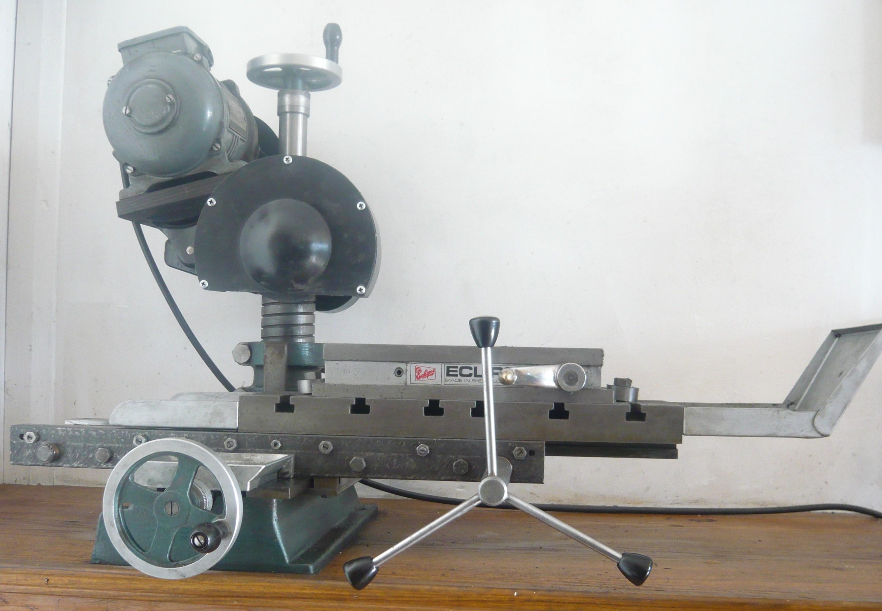

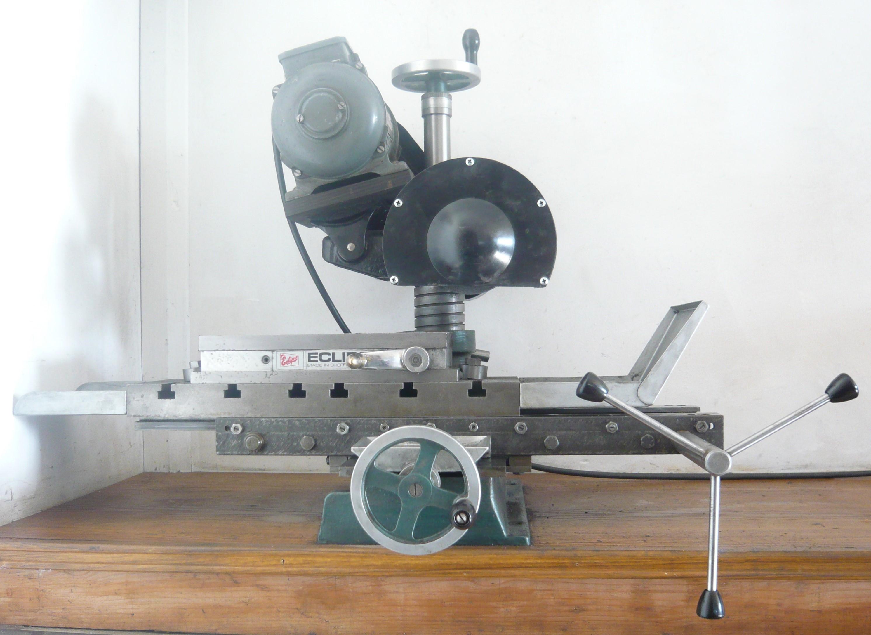

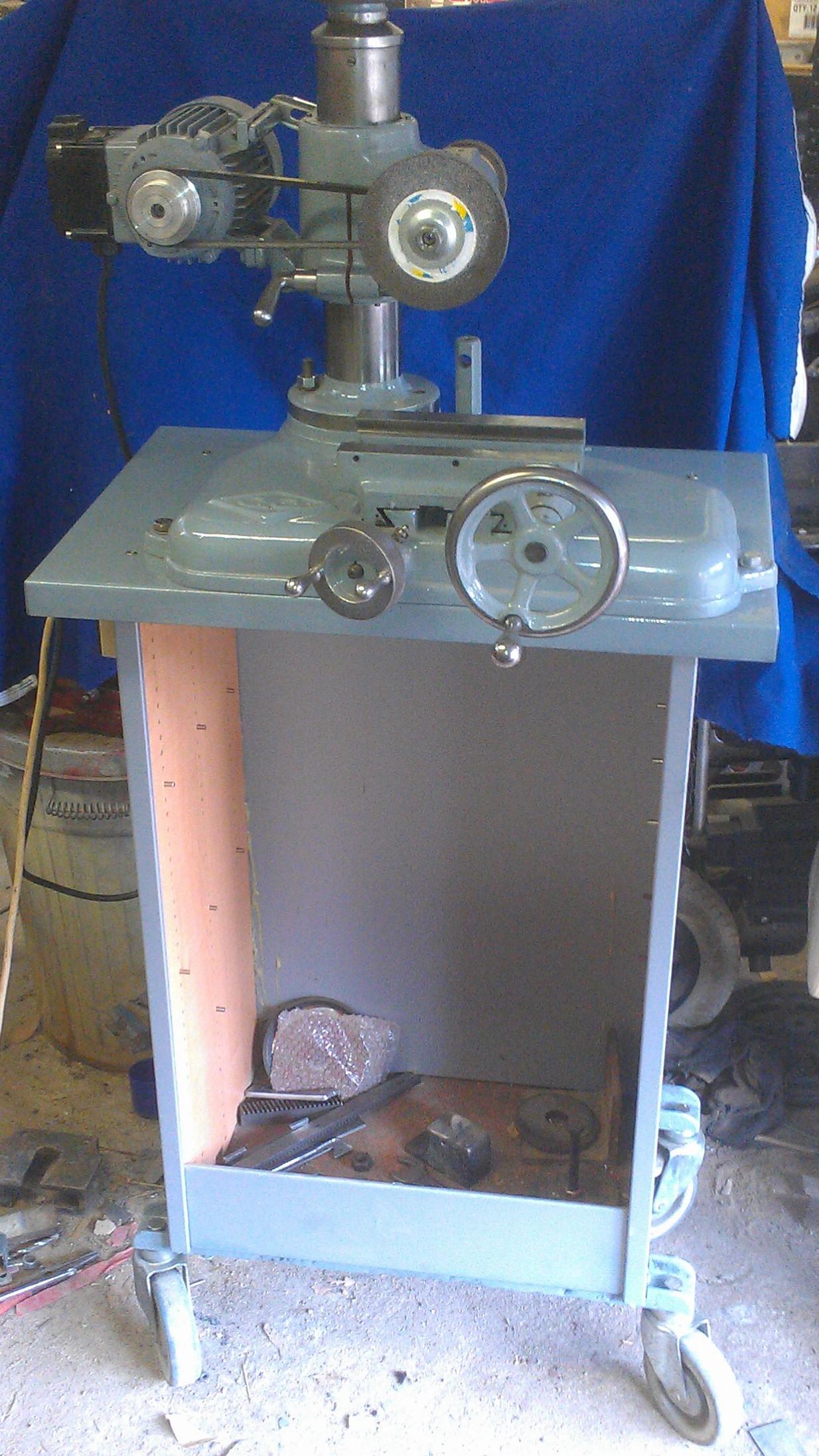

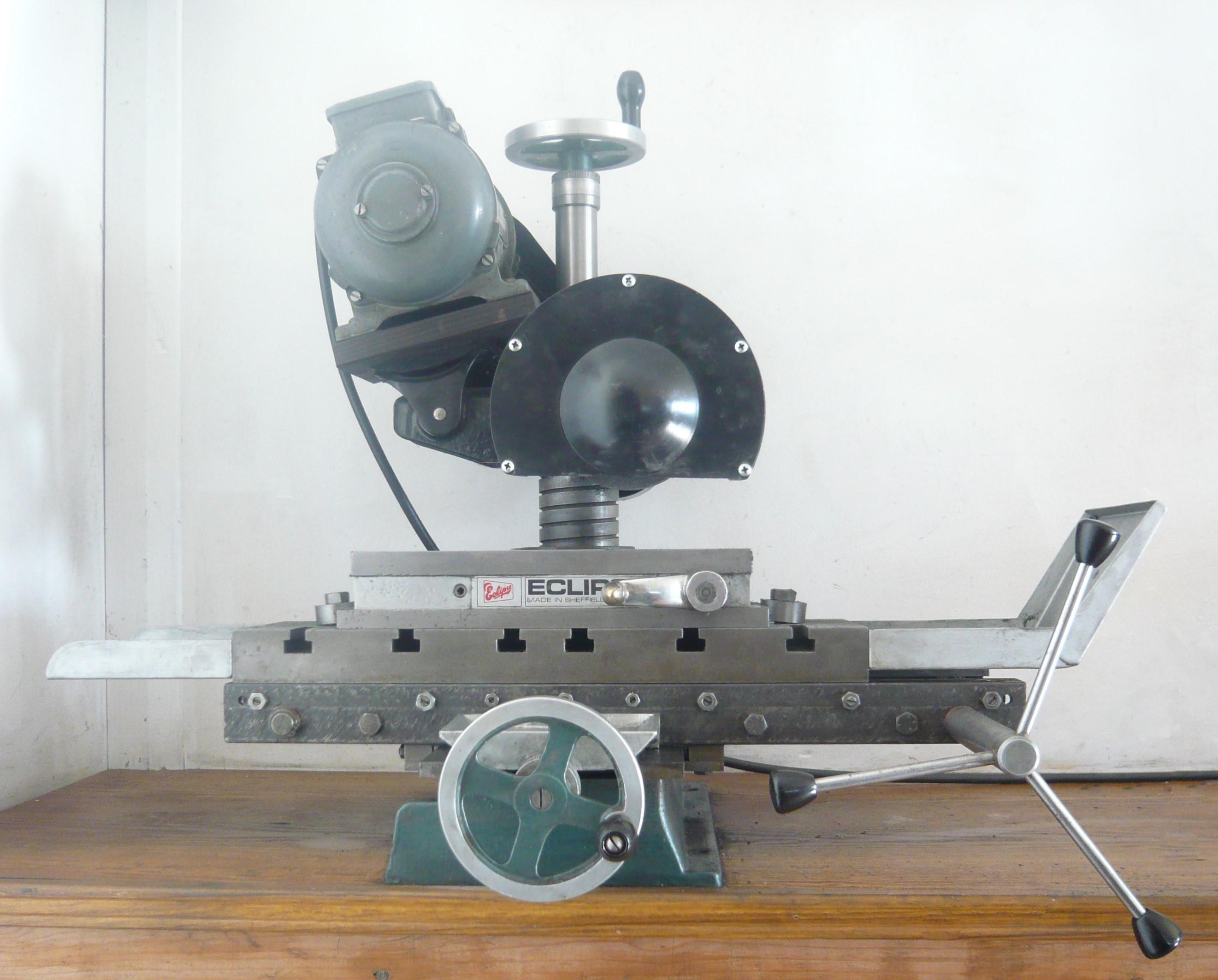

I have a small CC tool and cutter grinder that I uses as a surface grinder.
Cheers,
Joe

Hi Joe,
Nice little grinder. What make is it?
Offline JHovel
  • Posts: 97
« Reply #14 on: December 06, 2023, 08:09:47 AM »
CC Engineering Industries Limited, Sydney Australia
I was given it in a very dilapidated and worn state and restored it including re-scraping every single sliding and flat surface on it. Lovely little tool in use now. Here is a link to one on the original cast iron base recently sold at auction: https://www.grays.com/lot/0006-5048538/mechanical-workshops/cc-engineering-industries-surface-grinding-machine

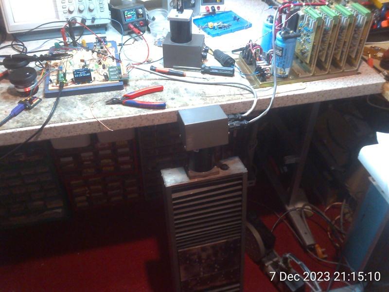

Experimenting with a Raspberry pi pico servo.
This sort of thing used to be difficult. Now  all you need is a £5 microcontroller and a few lines of python and you have a servo controller.
Here , the pico's PIO  (programmable input/output) is configured to be two quadrature counters (it can easily have 8)  , one handling the motor position, and one counting the handwheel input. One of the pico's PWM outputs is amplified, filtered and sent to the servo amps (on the right).
 :proj:
I feel the need to make a pico DRO  ....

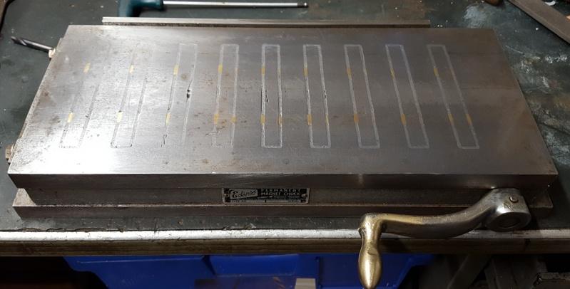

I've acquired a nice Eclipse 14 x 6 magnetic chuck  and updated the design slightly to incorporate some 40x40 and 80x40 extrusion for T slots and slide support.

Another rethink about the base design.
Instead of having to cut a 10" wide slab on aluminum down to 5" . I think I'll keep it 10" deep and fill in the the front and side with thinner plates and use another 1" thick piece at the back
If I cover the front left side with the extruded T-slot I have, it might be useful for mounting a rotary table for cylindrical grinding
