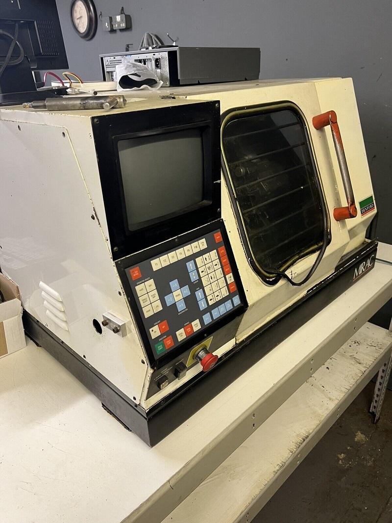

  [ You are not allowed to view this attachment ]  So a pic of the Mirac as I first saw it.
Was claimed to have been working until recently, at which point it stopped loading code. I have to say I suspect that it has not worked for quite a long time. lots of PC boxes came with it and a handful of hard drives suggesting there had been some unsuccessful trial and error attempts to make it work.

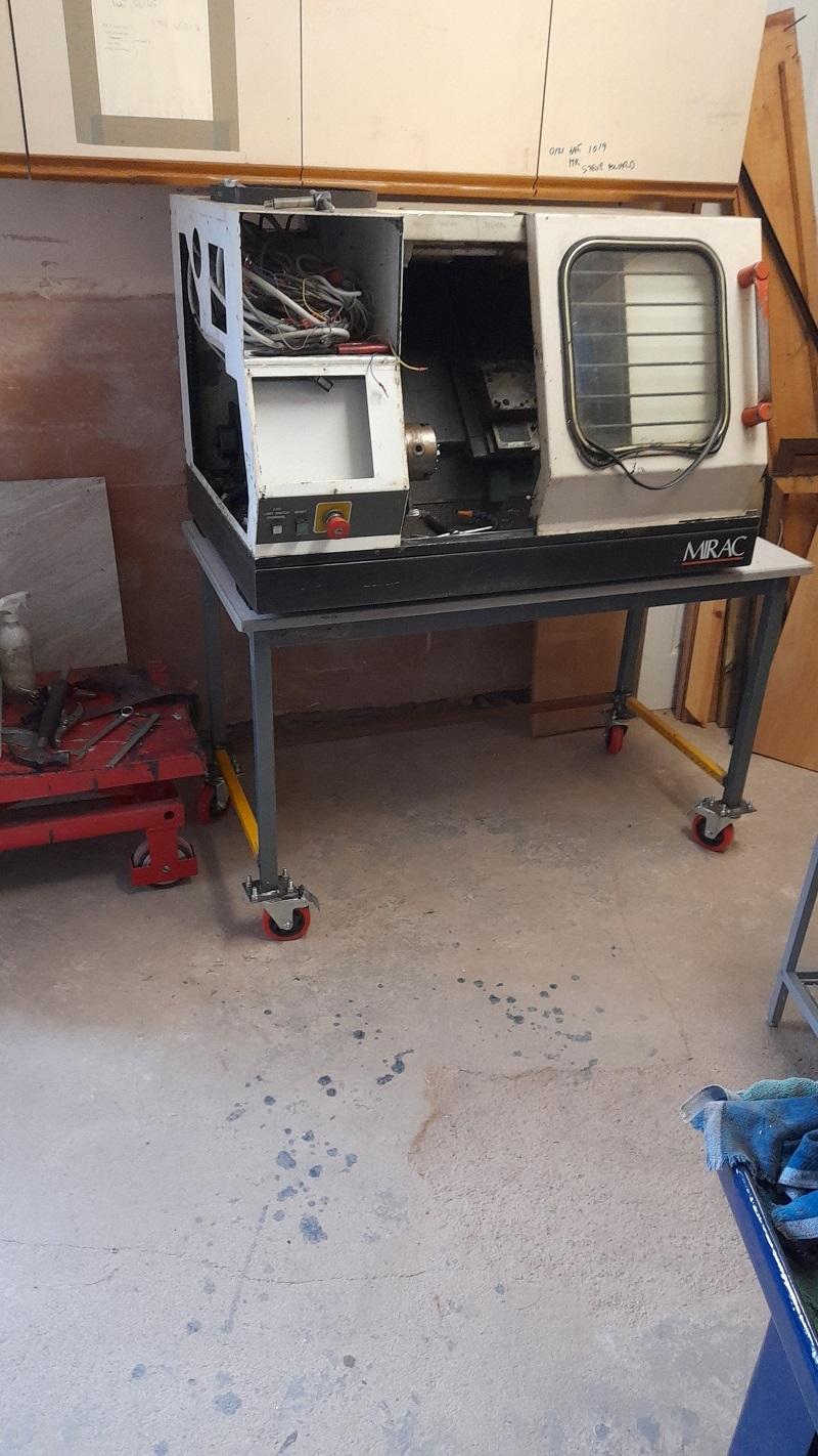

Got it home using a mate’s pickup and successfully unloaded with a floor crane, but to get it through the workshop door the panel needed to come off (so all had to be disconnected)
Seen here looking forlorn after it was hoisted onto a trolley table. The “Dexion” version offered with the machine was just not going to do the job. And it needs to be on wheels for access to the panel when the job is done.
Panel was placed on the bench.

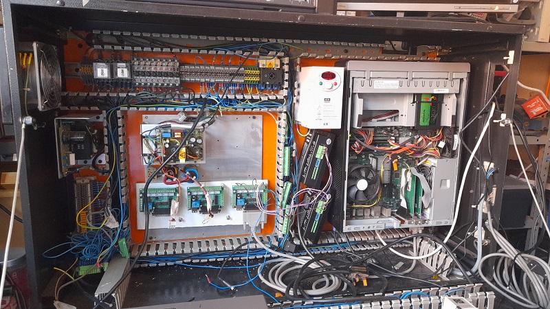

Whilst the Denford panel looks OK, I have no Denford software and am led to believe that a costly Denford Dongle could be needed to run Denford software.  I had already run a Boxford TCL machine using Linux so decided to do similar and Installed a PC with  Debian 2.8.4 and 3 parallel ports
Then removed the Denford slave board , (reasonable offers considered)   to make room for the new kit which includes 60v drivers ,  3 BOBs  and a 0.4Kw VFD.
A mate has done similar with a Denford Cyclone, adding a turret control board designed by a colleague, and sourced from China and he has made a successful conversion. His turret motor had been goosed so he had converted his to a stepper motor drive.
 We compared notes and it was decided to first try the existing turret motor and see if it worked.
 All of the turret connections are now identified and tie up with the manual for turret wiring of a six station model.
We tried to run the motor (free of the turret) using the 0.4 Kw VFD.   It stuttered and quickly overheated.  Tried another VFD which did similar, yet the windings check out and there are no signs of damage, so am now puzzled. The turret data plate is lost but it does look like your RH80 model Andrew.
So the question is now whether the motor is goosed, or do we need a beefier VFD??
What is the rated power of the turret motor and what VFD should drive it .
What did you use Andrew?
« Last Edit: July 21, 2023, 04:20:58 AM by john11668 »

Used a beefier VFD and now have turret motoring .
In the absence of a Slave board we know to be working, we are adding a dedicated turret board.
We know we have to motor the turret past the required station then back into the lock position and that function is proven.  Board should be fitted this week  then hopefully make some chips.
