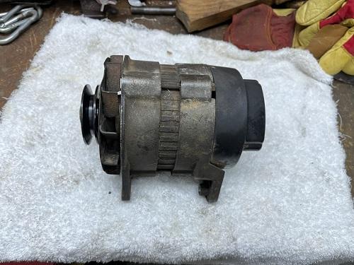

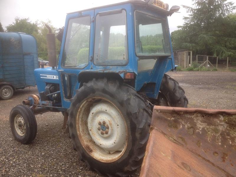

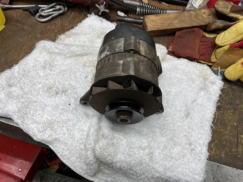

I recently replaced the alternator on my 1979 Ford 4600 tractor that I use for hedge cutting. I don't  think it's ever charged while I've owned which is since 2014 - I just top it up using a mains charger. Well in a fit of enthusiasm having finished this years hedging I decided to 'sort it'
Originally this tractor had an alternator with a separate regulator, and had been re-wired for the Lucas ACR18 and the lack of charging was due not only to a faulty alternator but also problems with this re-wiring and also a genuine fault in the fuse box. One of the 'Lucar' 1/4" spade lugs had completely corroded off and the live wire was floating about  :bugeye: Fault finding wasn't really aided by the Ford 4600 wiring diagram which shows a single fuse whereas there actually are twelve  :lol:
Anyway once the wiring and fuse issues were sorted I decided for expediency to fit a new alternator however as the same unit fits both my Ford tractors I'm going to re-furbish the dead one as a shelf spare.

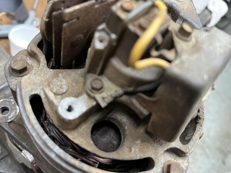

The bearings sound and feel like gravel, and no doubt the various electrical bits are either  blown or not in the best of condition, but so long as the rotating field coil and static 3 phase stater were both continuous and not shorting to ground it could be brought back to life (hopefully!)

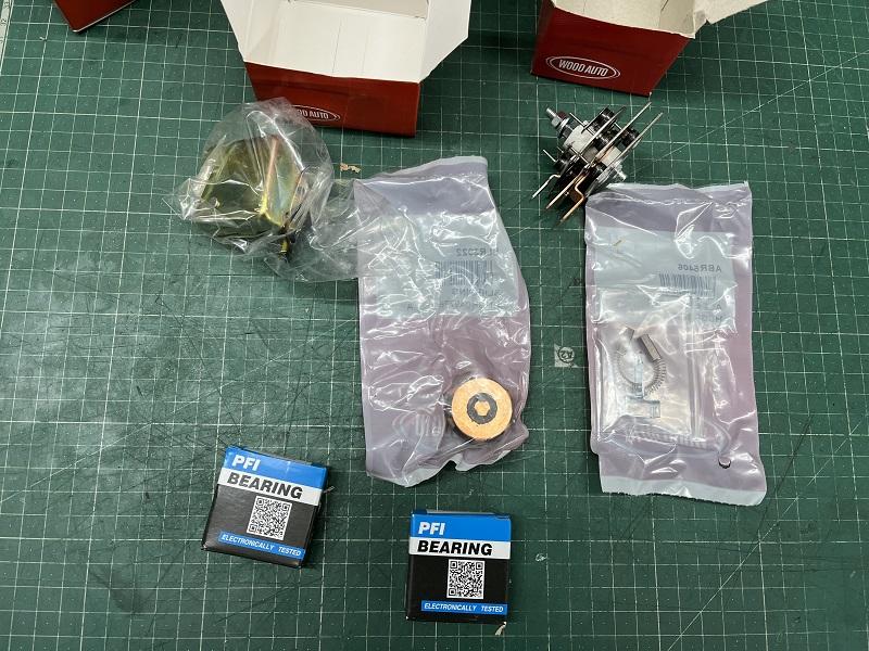

So this morning I removed it's end cap and made some basic measurements to convince myself it was worth buying the bits to re-build it. Happily both coils 'seem' fine so I have ordered:
New Bearings,
New Commutator,
New Brushes,
New Internal Regulator,
Fortunately all this is available as a kit on eBay including various links for the princely sum of £23 - or about 1/3rd the price of a new alternator.

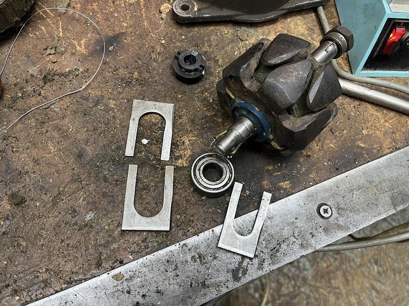

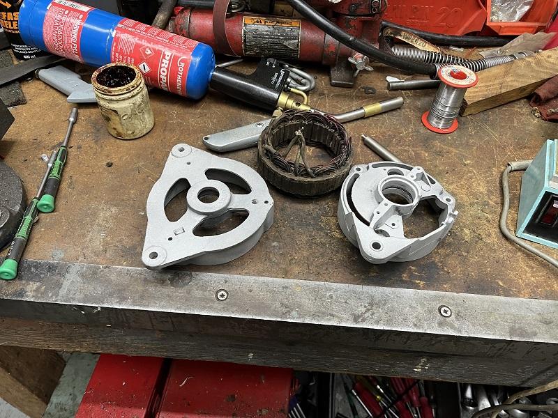

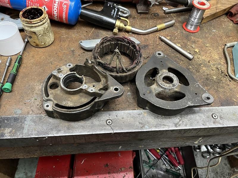

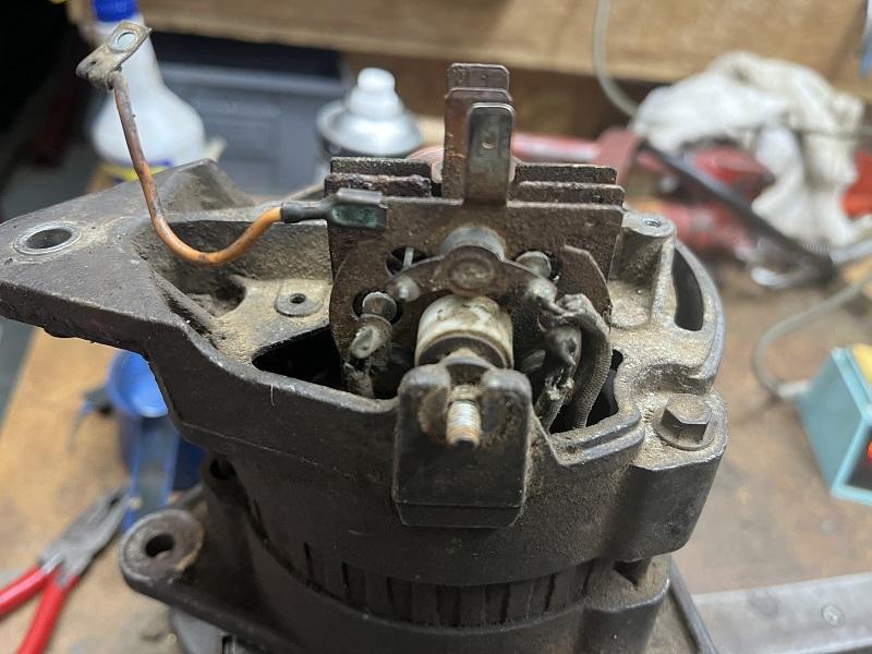

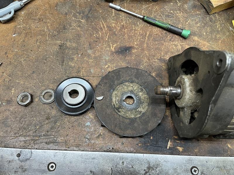

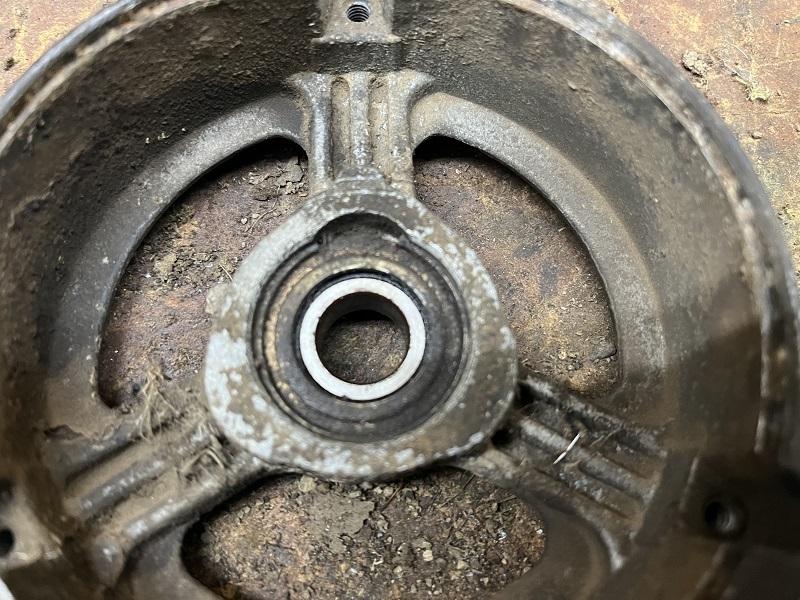

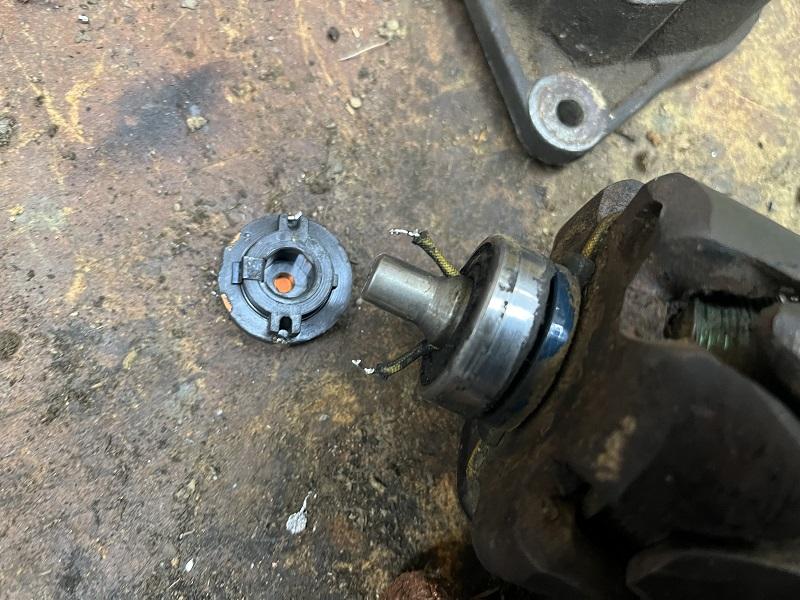

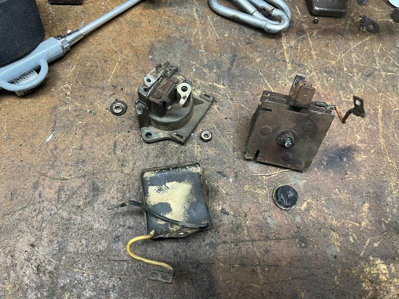

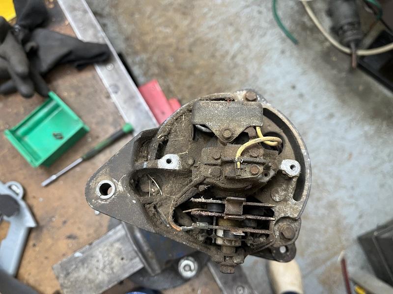

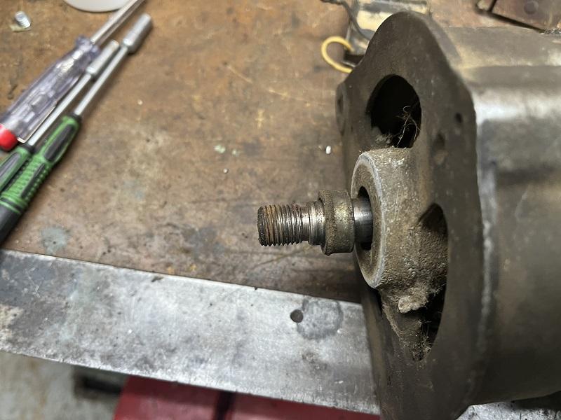

At long last the rebuild parts have arrived so having checked that they seem to be the right bits I committed to further dismantling.
Many pictures I'm afraid as I wanted to document the order bits came off and the position of various links and soldered joints. So firstly off came the pulley and fan noting that there is a woodruff key and a recessed spacer behind the pulley pressing on the bearing. Then it was a case of removing the regulator, rectifier and brush assembly along with all the associated links.
Once the 'back end' was disassembled I was able to part the front and rear covers and attack the bearings.
  • Posts: 9161
Re: Re-building a Lucas ACR18 Alternator
« Reply #6 on: October 17, 2022, 11:41:19 AM »

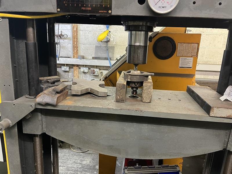

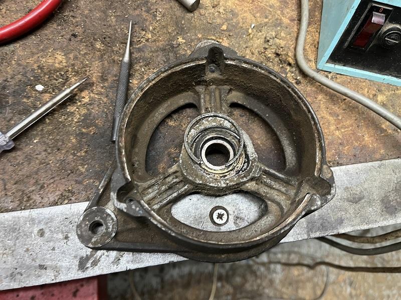

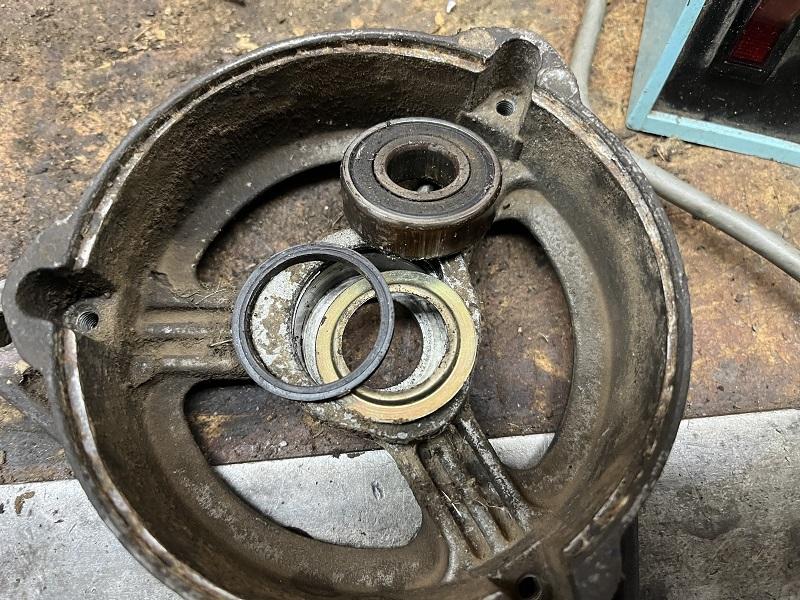

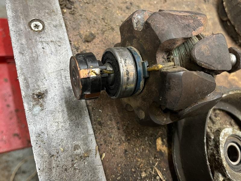

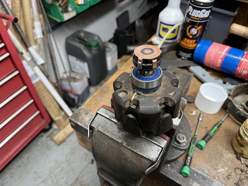

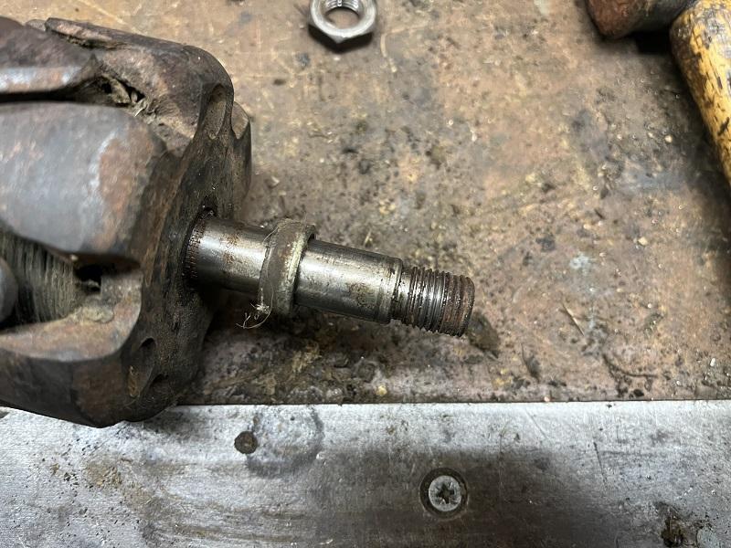

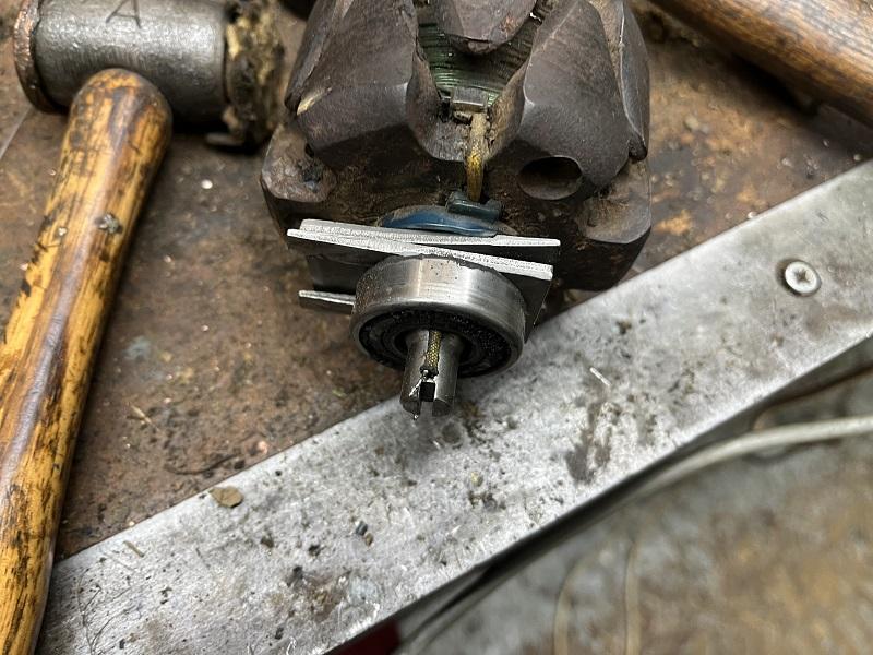

I ended up having to press to he rotor shaft out using the 60 ton press and once out I could tackle the bearing retainer. I always find those spring clip retainers a pain !
Once apart I was able to grit blast the end frames - they came up well but are not perfect -there is some remarkably tough paint (or baked oil more likely) in some of the nooks and crannies.
Starting to re-assemble the end frames and rotor I was getting rubbing between the rotor and stator which proved to be minute burrs that I'd raised holding it in the vice to remove the slip ring. A smooth file soon sorted it out but it just shows how small the clearance is between these parts.

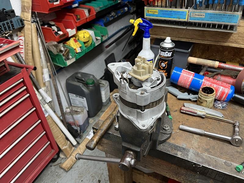

The nylon brush holder was extremely grubby so it got a light grit blasting and has come up well.
I've yet to refit the rectifier (has to be soldered) the regulator, brushes and all the links but I've had enough for today and don't want to make mistakes.
Play will resume tomorrow !

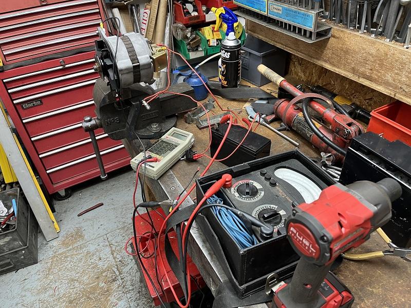

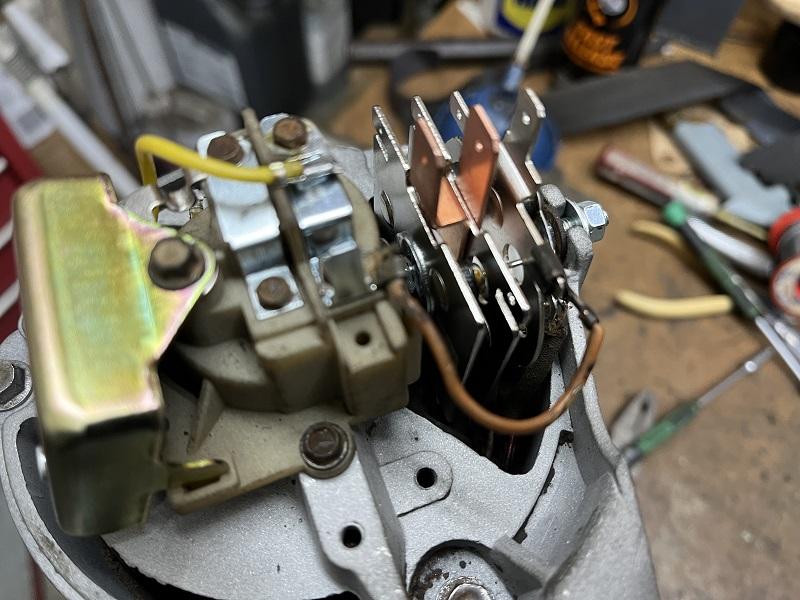

So this morning I soldered in the rectifier, installed the new brushes and set all the links connecting them to the regulator and brushes. Checked, double checked and was sure that there were no errors.
Then I set up a simple bench test - small 12 volt battery from an old UPS, 3 watt bulb from +12 v via a switch to 'Ind' terminal, with the obvious main + and - leads from the alternator output to the battery. Clamp ammeter round the alternator output lead, Fluke DVM across the battery - 'ready to test'
With my Milwaukee impact driver with a 22 mm socket I set it spinning. Did we charge NO  :bang: The battery volts were going down not up - argh what have I done wrong  :scratch:
Some time looking at photographs that I taken, and from on line resources particularly this one:
https://www.lrsoc.com/forum/forum_files/Lucas%20Manual%20A1-5.pdf
But I could find nothing wrong with what I'd done - I was about to re-install the old regulator when I thought hang on it's not the battery is it. Oh yes - another ex UPS battery - (even smaller this time !) hooked up and guess what - we start charging and the volts top off at 14.6 as they should.
Funny how you always doubt what you've done then it turns out to be something else  :clap:
So when I can find a big enough battery in a reasonable state that I can drag onto the bench I'll give it a full test - the alternator is rated at 45 amps but it only took 500 milliamps to raise the  7AH UPS battery to 14.6 so a very modest load.
