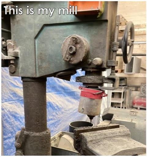

I’ve just become the proud owner of a NAEROK mill/drill

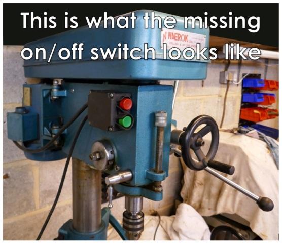

Wanted to know if anyone could give me a few pointers on the on/off switch
There isn’t one O-o

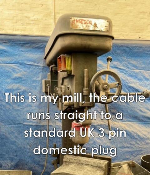

I believe the mill is being run straight from a single phase domestic supply [230v UK]

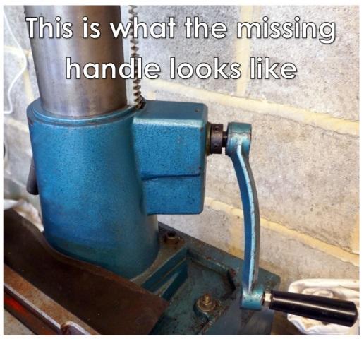

Also if anyone knows where I could get a handle for raising and lowering the head [the handle from the Bevel gearbox for raising and lowering the head was missing], that’d be outstanding.

That original switch probably was not only an on / off switch but incorporated a 'NVR' safety feature. NVR = no volts release. So if the mill is running and the power gets cut, it won't start up again when the power returns until the start button is pressed. Probably many generic switch units that will fit the bill.
Here's the first one I found on eBay but there are many more :
https://www.ebay.co.uk/itm/295037757613?hash=item44b19ee8ad:g:u5cAAOSwEbpiqGoQ

If you can't find a handle, and, since you do have a mill drill, maybe this will be of some help in fabricating one to fit, assuming you need to make a square hole in something for the stub:
---and maybe I should take my own advice and finally make a handle for my milling vise, instead of stupidly using an open end wrench.

Direct-on-line starters are definitely available for single phase, not just for three phase devices.  I have one on my lathe and another on my small drilling machine.
The type I have are 'Memdol' brand, made by the Midland Electrical Manufacturing company, hence the 'MEM' part of the brand-name.  The 'dol' part, of course, signifies 'direct on line'.   The particular versions I have also include a no-volt-release function.  They have a toggle actuator rather than the green and red start and stop buttons often used on industrial switch gear.  However, I believe that later versions of the Memdol starters are available with such buttons.  They have overload tripping heater coils, just like the three-phase versions, available for various motor load currents.
Having written all that, I am unsure without checking whether MEM are still trading or whether 'my' versions of the device are still available.
If you desire the motor to be reversible, that would require the addition, in-circuit, of a separate reversing switch, the Memdol doesn't include that function.
