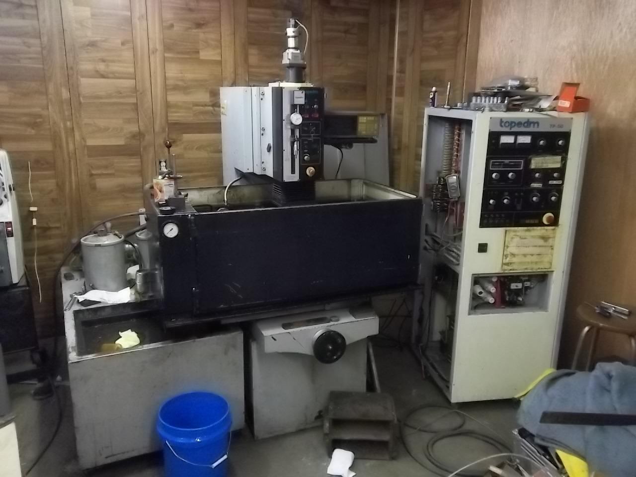

 I finally got my sinker edm running again. I had only operated it once last year when I first got it so I don't really know how to use it or exactly what I should expect from it. It's primary malfunctions is just the idiot that is trying to run it without consulting the operators manual...
    It is capable of 50 amps output but I am running it at 10 amps so that I don't pop the fuse , my 5hp rotary phase converter cant supply enough juice to it to run at 50 amps - I may get 20 amps if I push it......Irregardless . At 10 amps using a 1/2" square graphite electrode I am only burning .001 depth per minute in a steel workpiece.. Does that sound right.?? That my friends is slower than slow..
  Also, an 85 yr old still working tool and diemaker friend of mine talks about arcing going on that damages the workpiece and the electrode... What is that and how do you recognize it? I can call him but he is real hard of hearing, doesn't hear his own phone ringing unless he is near it. Photo shows my EDM today with most of it's covers pulled.. I like it a lot but I am afraid the beastie don't much like me.

Somewhere on the forum is a thread where I was sinking a 1/2" square using a copper electrode and I seem to remember that Pete-W asked how fast it went - can't for the life of me find the thread but it's here somewhere  :med:
 . . or it may have been the thread about making a big grub screw  :scratch:
As for arcing - that's bad. The electrolyte combined with the electronics should be totally preventing arcing. The discharge should happen in the last few microns of approach and the electronics cut off as soon as it happens
Oelheld have (or certainly had) a good downloadable EDM handbook on their site in the IONO-PLUS area.
