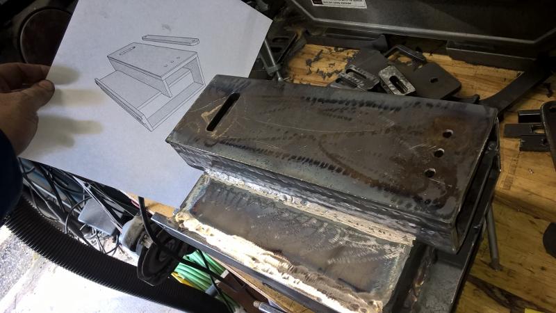

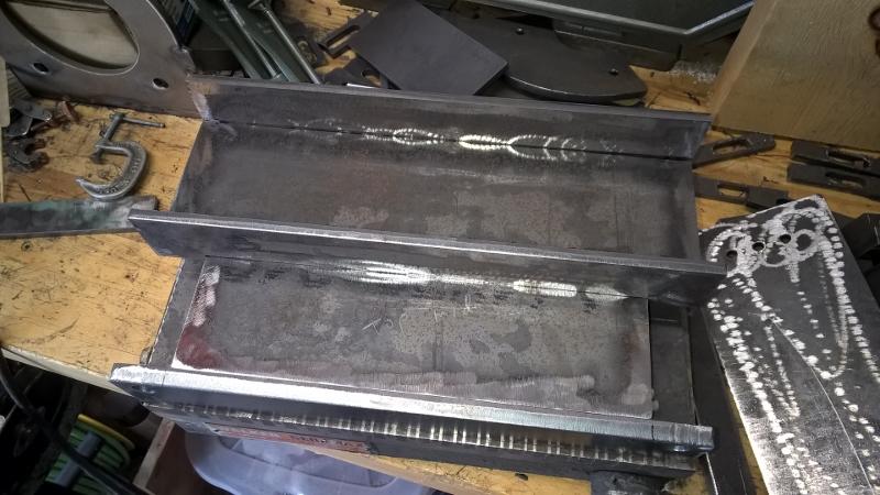

« Reply #1 on: August 12, 2018, 11:22:42 PM »

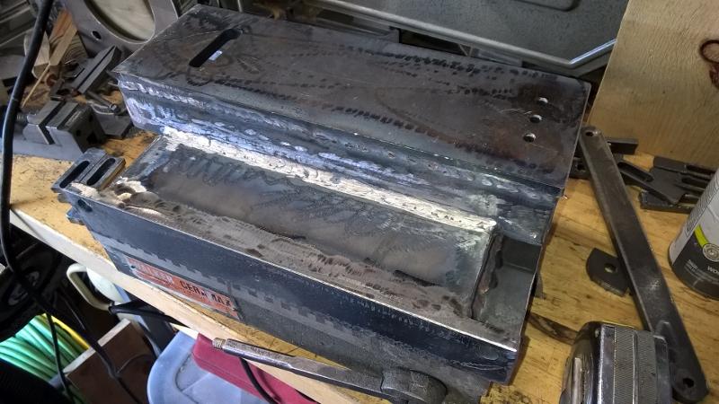

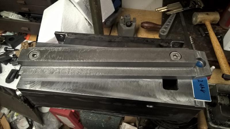

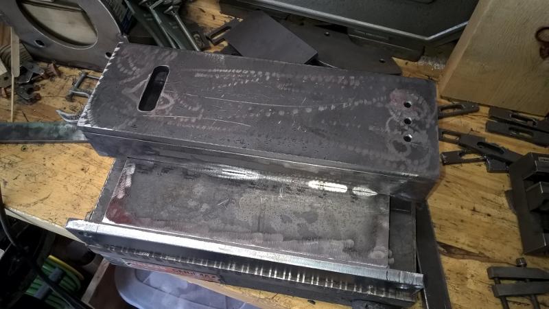

Initial fit up of the plasma cut parts!  You might note the notch on the center plate to line it up.
Second photo is the mounting surface for the taper slide.
Then, copious welding!

Aaand, a comparison with the Sketchup model; looks good!

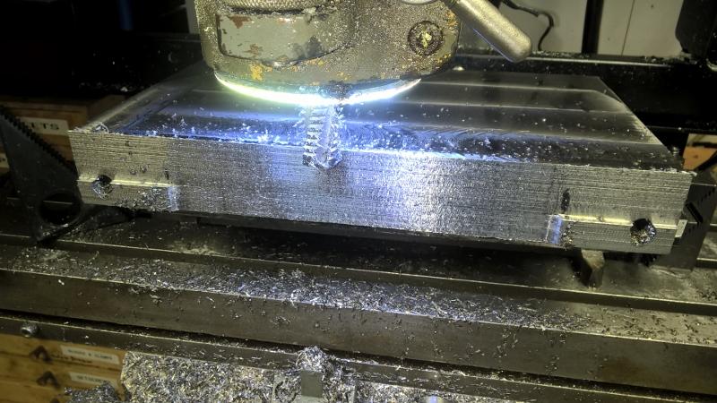

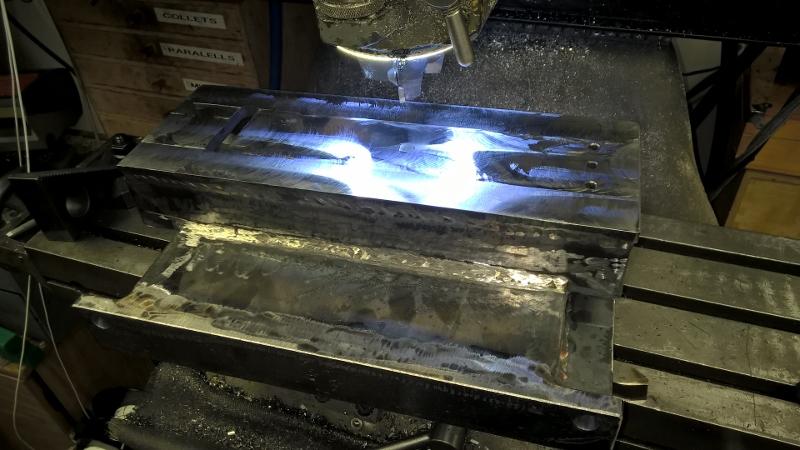

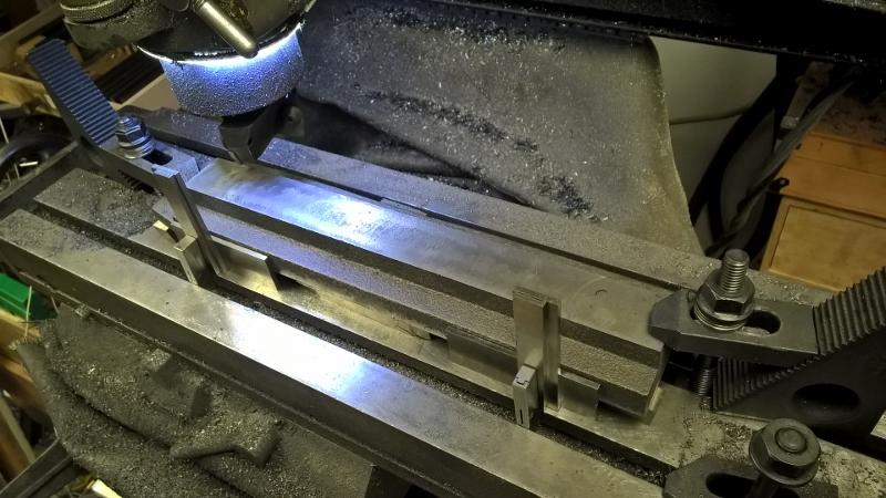

Off to the mill!  I flatted the whole bottom (with a bit not cleaned up) to make subsequent work easier.
Flip and cut more.  Carbide end mills rock!  Oh, and if you don't have a ring lite on your mill, you really need one!

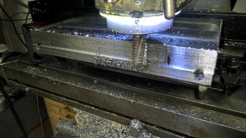

« Reply #3 on: August 12, 2018, 11:29:48 PM »

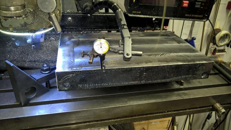

My Rockwell isn't super big, so I had to turn it around and indicate it in.  I used the end mill to clean the edges while it was in the first setup so I had a reference.
I had to do some rather fiddly measurement to get the end of the end mill to cut the top edge of the key I needed.
One side of the key done!

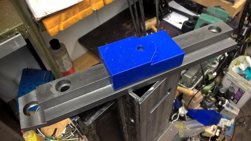

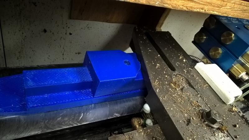

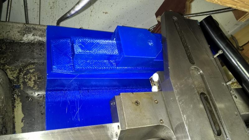

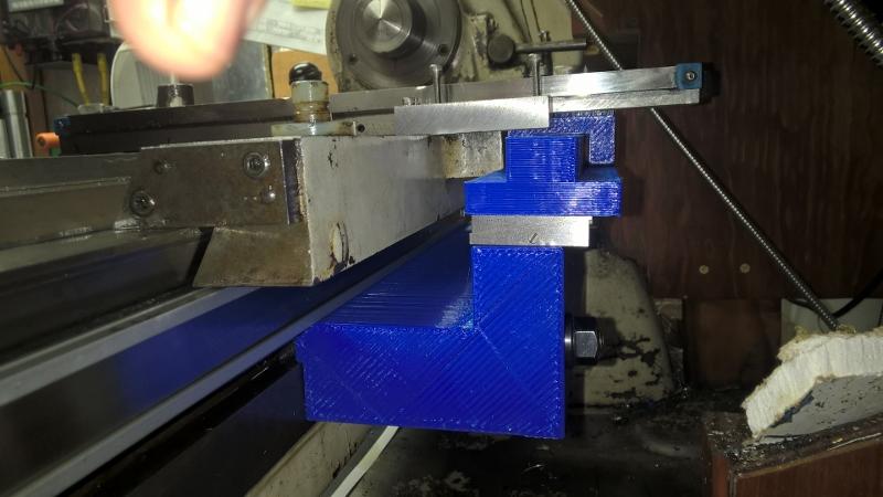

I relieved the center to make fit up a bit easier.
Installed on the lathe with the plastic bits on top.
Crud.  A little higher than planned.  At least those parts aren't made yet...

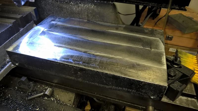

And, its time for cast iron!
And a fit test with the plastic slider.

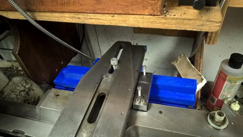

« Reply #6 on: August 12, 2018, 11:39:44 PM »

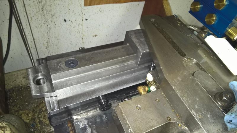

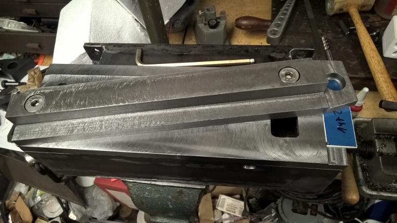

I set it up so that it had three positions for one end of the way; shallow taper, and +- a steeper taper.
Offline WeldingRod
  • Posts: 401
Re: Taper attachment build

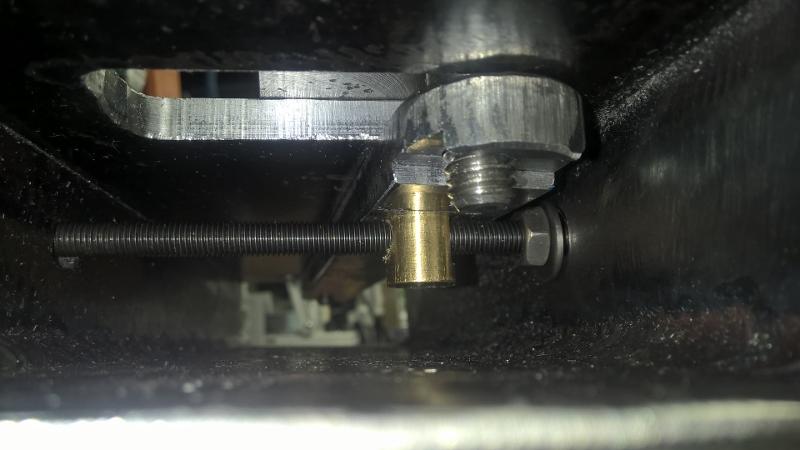

« Reply #7 on: August 12, 2018, 11:45:36 PM »

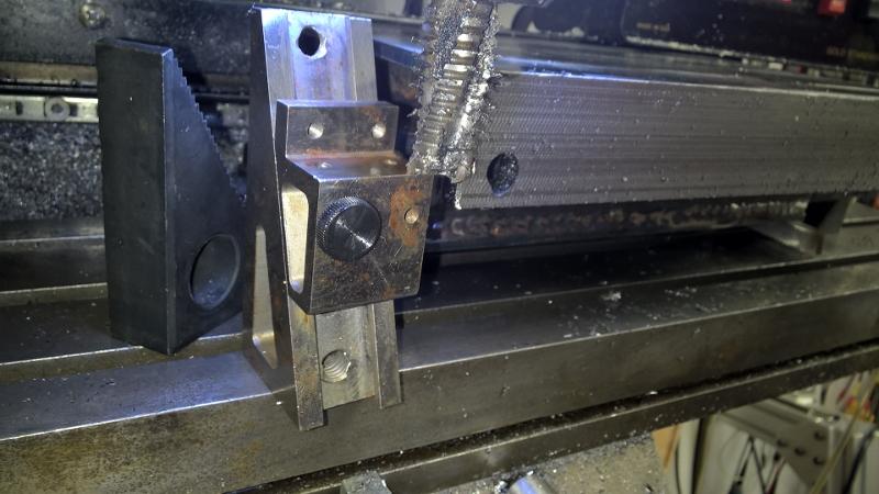

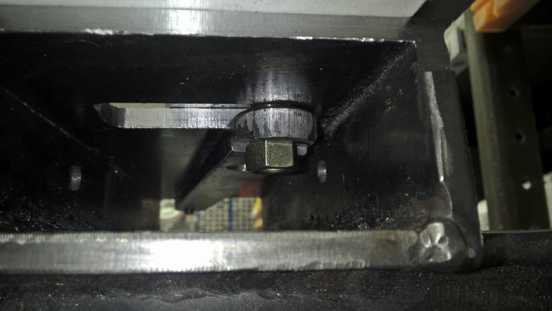

Getting a way to clamp and adjust the way was quite a trick.  I used a long nut plate to engage the two shoulder bolts; you can take one out and not have the nut plate fall down while you swap holes.
A super long 1/4-20 SHCS adjusts it side to side, working in a round brass nut.  That was the first product of the steady rest!

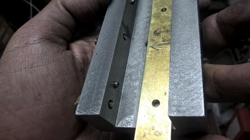

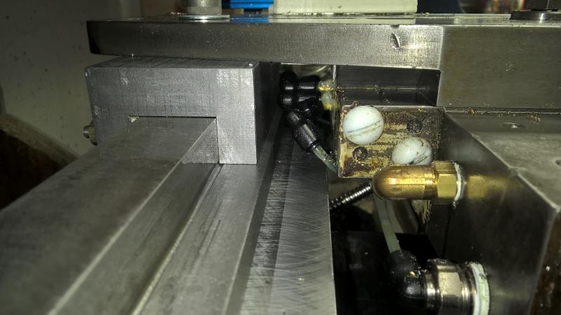

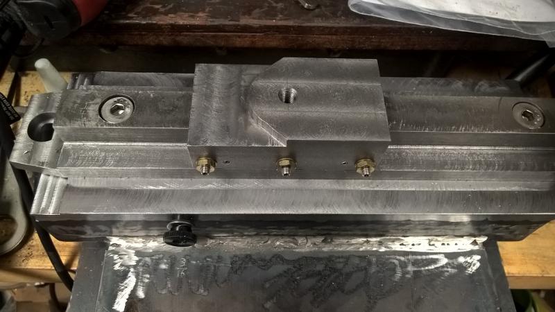

Sorry, no in-progress shots of the slider!
I did manage a photo of fitting the gib key, though.
And off to the first assembly!
The funny stuff on the back of the carriage is my lubrication system.  If there's interest, I have pictures of that too...  If you ever wanted to know what hides inside a Hardinge carriage.

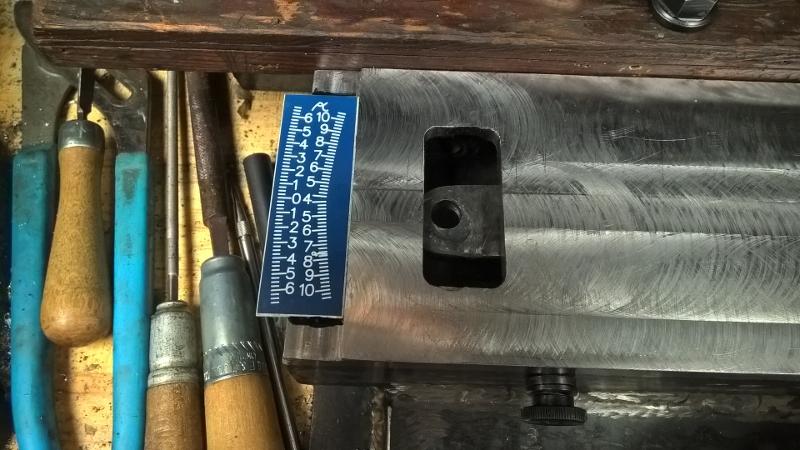

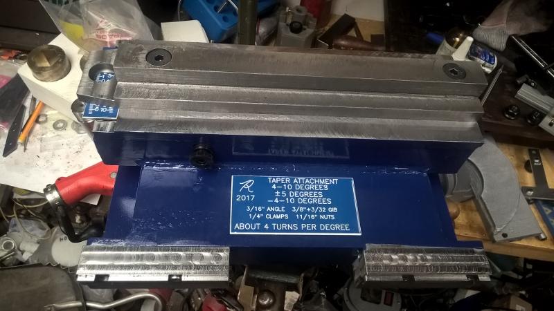

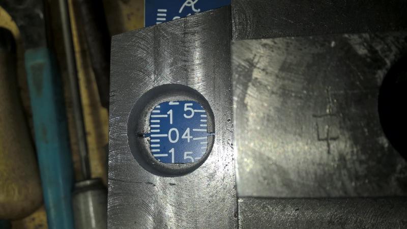

Adding the maker slot for the indicator; mini-hacksaw to the rescue!
I did some careful CAD layout and quite a few tries to get the engraver to get it all right.  Yes, I was sneaky and put three scales on, one for each of the pivot positions.
Precision installation of the indicator after I set the system to zero taper.
Offline WeldingRod
  • Posts: 401
« Reply #10 on: August 12, 2018, 11:58:35 PM »
And after all that, who can resist a proper builder's plate!

Very nice! Did you got any play?
Where did that descrepancy crep in with the cross slide and taper attachment deck height?
My speciality is to add a part thickness with wrong sign....latest was to add 20 mm instead of subsract it and even put the part in wrong way, because it did not look right - and then welded it solid. :D

« Reply #15 on: August 14, 2018, 02:37:32 PM »
Pekka,
The slide is adjustable to get close to zero play using a gib; it runs smoothly.  The way its set up, it is free to move up and down if the way isn't lined up with the lathe bed (though mine seems to be very well aligned with those keys).
I think my final height issue was due to the relatively low precision fit of the plastic parts, or a thickness mistake on a plastic part.  I really didn't bother working out where I messed up, just fixed it.

Thank you, Ok. the gib is back of the guide. Looks all very nice.
I like your 3D printed proof of consept plastic parts. That is tempting consept.
