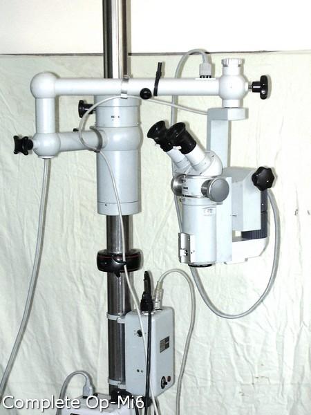

The Op-Mi6 consists of a heavy base with three lockable castors and a central foot-operated brake.  The base contains a 'splitter' for the incoming AC mains supply.  The base supports a vertical column some 80" high.  This column is tubular and guides the carriage that supports the actual microscope head on a pivoted arm.  The strong plastic ribbon is attached to the carriage and runs in a groove in the column up to its top-cap where it is directed into the interior of the tube where either a weight or a long spring counter-balances the weight of the microscope, arm and carriage.  (See the Google photos to get the idea - I'll take and post some photos of this particular unit as soon as I can.)
There are two boxes mounted on the column below the lower limit of motion of the carriage.  One of these contains the power supply for the microscope lamp while the other contains the power supply for the motions of the microscope.  I call this box the 'Control Unit' - it bears some switches affecting the microscope functions and several connectors, acting as the junction box connecting to the Pedal Unit and to the microscope head.  Each of these two boxes has an IEC connector to accept mains power from the 'splitter' in the base.

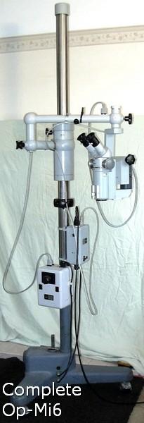

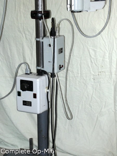

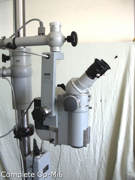

Well, I managed to get set up and take some photos of the complete microscope (except that the Pedal Unit got cropped out!
« Last Edit: August 13, 2018, 02:11:23 PM by Pete W. »
Re: An Encounter with a Surgical Operating Microscope.
« Reply #6 on: August 13, 2018, 02:04:56 PM »
An essential first step in any refurbish exercise is to perform a survey.
The photos in the previous post show the base and column, the carriage and microscope head and the control unit and the power supply for the lamp.  The Control Unit is the upper of the two boxes clamped to the lower part of the column.

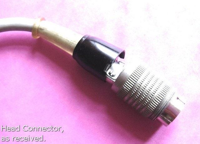

When received, the outlet shroud on one of the connectors that mate with the Control Unit was broken and the metal part of that connector was bent out of line.  This was the connector on the cable from the microscope head.  It has five poles (i.e. male contacts).  One pole was a ground and I speculated that the other four were devoted to the focus motion (one pair) and to the zoom motion (the remaining pair).  However, exploring with the ohm-meter only found one pair, raising the spectre of broken wires or open circuit motors.  It would have been a great help if I'd had matching female contacts with which to tip my meter test leads, trying to reliably contact one pin at a time in a connector shell only 13 mm in diameter was a challenge!  The first photo shows this connector as received.

(an end view of that plug would help in identification)

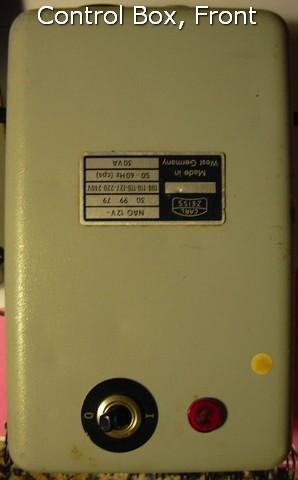

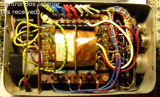

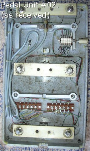

I gave the lamp power supply a functional test.  It has a mains power input with fuses and two double-pole sockets on its top face and a four position control knob and two lamps, green & red (maybe LEDs), on its front face.  The double-pole sockets are for the output power to the lamp (6 Volts at 30 Watts).  The four switch positions give 'Off' and three levels of lamp excitation - in position #4, the green light is extinguished and the red light comes on.  This is because position #4 over-runs the lamp bulb to give the right colour temperature for photography but at the expense of bulb life.  (There is no camera with this Op-Mi6.)
I then removed the Control Unit from the column and removed its back-plate.
I took a look at its contents (see the first photo), gulped and moved on to the Pedal Unit.   :bugeye:   :jaw:   :bugeye:   :jaw:

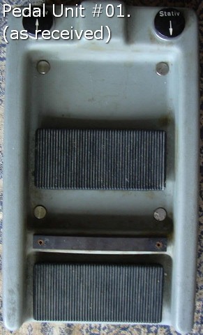

The exterior of the Pedal Unit didn't reveal much so I partially dismantled it.
Step #1 is to turn the Pedal Unit upside down and remove two M4 cap-head screws and washers from their recesses on the unit centre-line.  As received, one of these was missing.
Step #2 is to withdraw the pivot rod for the rockers, now no longer secured by the two screws of step #1.  The end of the pivot rod is accessible through a hole in the end of the housing cover.
Step #3:  Turn the unit right-side up - the two rockers can now be removed.  This reveals the plungers of the six switches protruding through holes in the cover.
Step #4:  The cover is secured to the base casting by four blind tubular nuts on the upper surface and four more M4 cap-head screws and washers in recesses in the underside of the unit.
The second and third photos respectively show the Pedal Unit as received and with the rockers and cover removed.

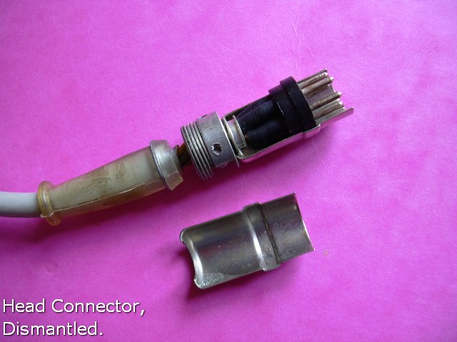

Hi there, Andrew,
Funny you should mention theatre lights!  In order to get the illumination for the photos of the complete instrument, I had to commision a 400W halogen work-light, on telescopic pylon.  I bought it some time ago, I can't remember whether it came from MSC or from CPC.  The halogen tube came un-fitted and, inevitably, I touched it with my fingers while inserting it into the lamp-holder.  I washed it off with VCR head-cleaning fluid.  I bounced the light off the ceiling which seemed to avoid shadows.
There's a small crack in the quartz tube so I ordered a couple of replacements from RS, just in case!   :zap:   :zap:   :zap:
This microscope has been dominating our living room since March!  The photography required that I clear the mantelshelf so I could anchor the top of the background bedsheet.
My lovely but shy assistant has been OK with it so far but I know the job is on borrowed time.   :hammer:   :wack:   :hammer:   :wack:
« Reply #10 on: August 13, 2018, 02:57:54 PM »
Andrew, I didn't reply to your point about the connector.
It's an obsolete German component.  I haven't been able to identify it.
I have some more photos of it dismantled but they come later in the saga!!
As near as I can tell, the contacts are close to size 16.
There will now be a pause in my postings while I attempt to produce a tidy and legible circuit diagram (aka 'schematic') of the Control Unit.
« Reply #11 on: August 13, 2018, 03:36:31 PM »
The reason I mention it is because I think that I recognise it as being the same as on one of my Heidenhain touch probes, or at least the same series.
I managed to source a suitable socket for it a few years back but can't find any photos to confirm
« Reply #12 on: August 13, 2018, 03:58:02 PM »
Hi there, again, Andrew,
Here's another photo of the connector.
The half-shell fits on to the main part of the connector and is retained by a very slim thrust washer and by the screw-jacking collar.  Then the outlet shroud screws onto the threaded portion of the connector body, in the process securing the flexible strain relief tail.
That thread is 0.7 mm pitch (or maybe 0.75 mm pitch, I forget).  The original outlet shroud is a moulding which I couldn't duplicate.  So I turned up a new shroud from a piece of acrylic, that seemed the most suitable of the materials available to me.  I'd never turned an internal thread before, I took it slowly and it fits quite well considering the male threaded part of the metal connector body is bent out of line!  It's neat but not gaudy!!!
That connector is five-way - the connector that's on the cable from the Pedal Unit is a twelve-way.  That was OK but I'll be writing some more about that cable in a later post.

To my eyes it looks very much like a standard DIN-connector. An older version of this f ex. https://www.ecvv.com/product/4569845.html
BR
/Peter
« Reply #14 on: August 13, 2018, 04:27:18 PM »
Sadly not the one that I had in mind, which was far better engineered and cost a fortune !

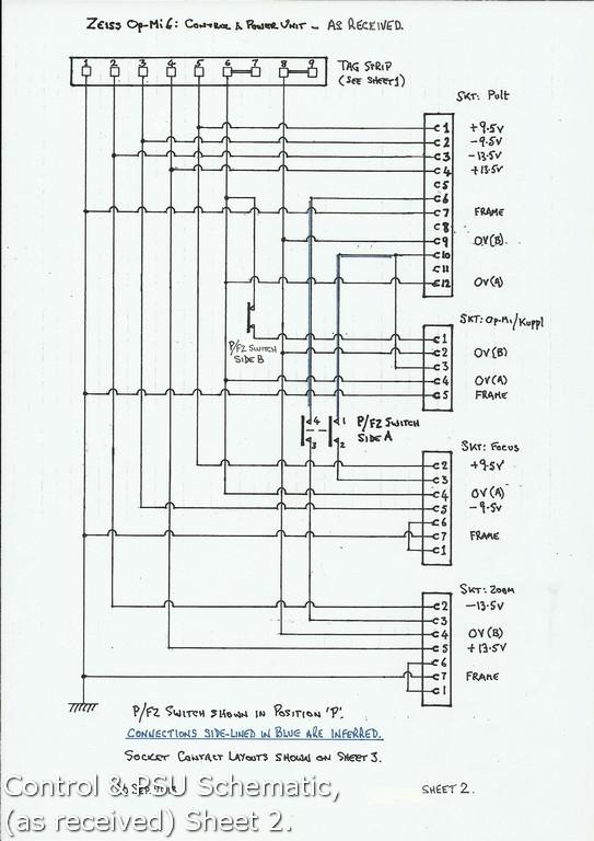

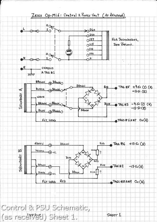

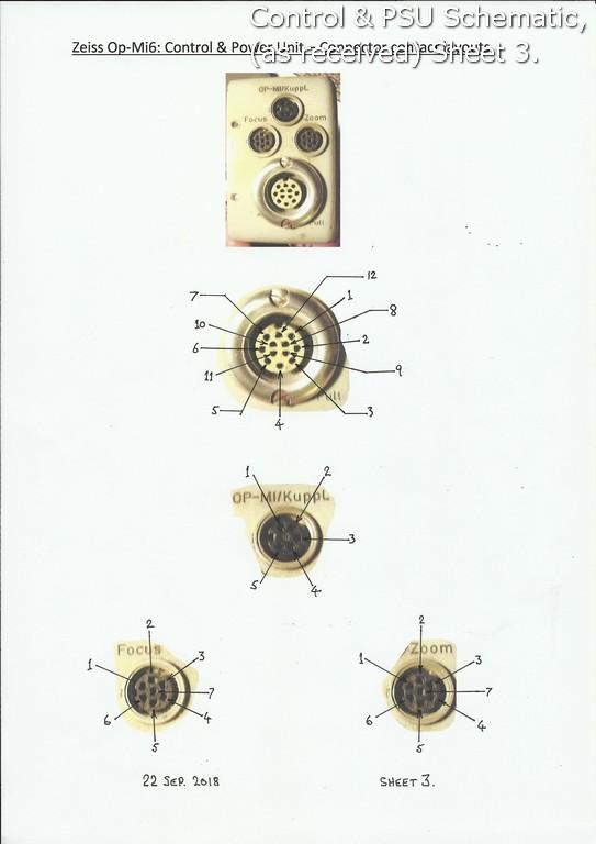

Since my last post, I've got a different camcorder.  Hopefully, I'll be able to capture the video 'footage' I referred to.  But there's a lot to tell before that!
I explored the circuitry of the Pedal Unit but it wasn't making sense without the Control & Power Supply Unit so I turned my attention back to that.  The first photo shows the innards of the Control & Power Supply Unit as received.  The second photo shows most of the schematic of that unit.  The parts omitted are the connections between the various power supply lines and the 12-way connector to the Pedal Unit and the connections between that connector and the 5-way connector to the Microscope Head.  They will be shown on sheet 2 of the schematic (to follow later).  Some of the circuitry on sheet 1 is a bit speculative - the reason is that the components are so closely packed into the box that visual access is impossible!
I have used Fast Stone Resizer on the schematic but I chose a bigger size than our usual value - if it's too big when I see it uploaded, I'll change it.
Most of the C & PSU circuitry is straightforward.  Zeiss have chosen to fuse both legs of the mains supply input.  I wouldn't have designed it that way but this post is showing what I received.  All the metal parts of the C & PSU are bonded to each other and to mains earth and both the 12-way and the 5-way sockets provide a contact to bond to the metal parts of the Pedal Unit and the Microscope Head, pillar etc.
The two transformer secondaries each feed a bridge rectifier arranged to provide a symmetrical ± DC output.  Secondary 'A' includes a tap selector switch to select one of two available output voltages.  The switch concerned here is the one whose dolly is labelled 'Focus I II'.  Secondary 'B' does not have this facility.  The 'B' ± output rails each have a mystery component in series.  These each measure 0·1Ω, they might be self-healing fuses of varistors.  I was surprised to find that neither set of output lines is connected to ground.
The numbers in circles refer to the transformer secondary tag panel.  References to 'Tag #8 & #9' and similar refer to the tag-strip that runs parallel to the edge of the box.  I arbitrarily allocated numbers to the tags starting with #1 at the left-hand end (with the green/yellow wire).  The two 'mystery components' can be seen mounted on the tag strip on the opposite side of the box.
My schematic drawing complies with no known standard but I hope you will be able to understand it.  I grew up when resistors were shown as zig-zag lines and transformer windings were loopy but I agree that those styles take skill and time to depict well.

The parts of the circuit of the Control & Power Supply Unit shown in sheet 1 of the schematic (see previous post) were fairly easy to trace, partly by visual examination and partly using my Fluke multimeter.  The parts of the circuit comprising the interconnections between the various connectors were more difficult, since much of the wiring was in the depths of the housing, inaccessible to both Fluke test probes and Mk1 eyeball.  In fact, the space was so densely packed that there was no access even for my dental mirror.  Consequently, some of the connections shown on Sheet 2 of the schematic are inferred and there may even be connections that are not shown at all.  The fact that I was able eventually to achieve both focus and zoom operation of the microscope head depends on the 'P/FZ' switch remaining in the 'P' position and the focus and zoom connectors remaining unused.  (The particular microscope head in this instrument is wired to connect to the 'P' connector.)

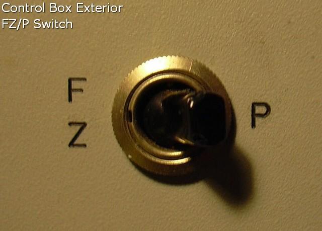

The 'Focus I II' switch is partly beneath the upper tag-strip in the photo included in the previous post - the 'FZ/P' switch is partly beneath the lower tag-strip.
