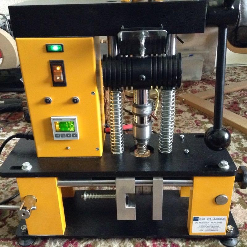

You have given me some inspiration to pursue another of projects....injection molding....
Know anything about this process? :scratch:
  • Posts: 1321
Re: Some of my real work
« Reply #2 on: April 06, 2017, 11:47:55 AM »
Yep, desktop injection moulder sat in conservatory much to my other half's dismay.  I sold my bigger old automatic moulder and got this one as it can use the same plastic I use for 3D printing, so I have a ready supply of feed stock in many colours.  It's also a lot cheaper making moulds for it.
