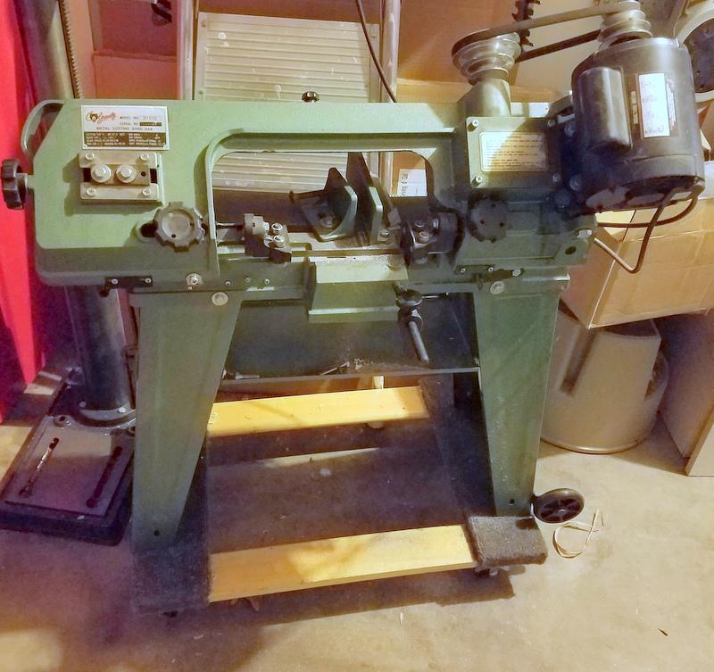

Re: Banned Saw
« Reply #7 on: April 05, 2017, 01:16:37 AM »
That original leg thingy is so flimsy that I even did not bolt it together. I cut some V-profile and welded together. Minimum stable size, because I need to wheel it around. I just put the rear wheels a little more back than original because I want to use vertical too and original wheel location did not give me peace of mind.
Original castors were not usefull. I put two cheap big plastic wheels back and two rubber feets on front. It stays put when in use and it is easy to lift from the front onto rear wheels and push wherever it fits.

« Reply #8 on: April 06, 2017, 09:19:10 PM »
Not only am I lazy but cheap too! Just a HF furniture dolly. A few years ago it was only about four bucks. Thought about permanently anchoring but it is so stable I got around to it.

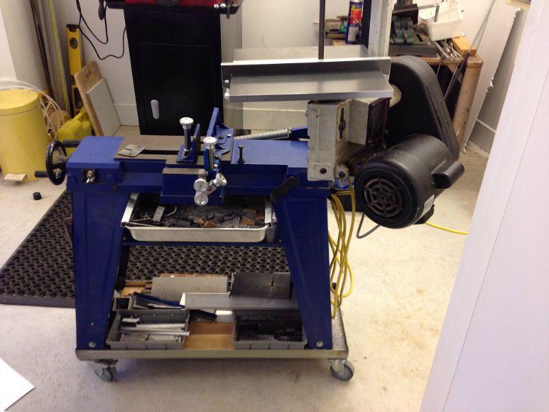

« Reply #9 on: April 07, 2017, 03:33:51 AM »
Hi Guys,
 Went down this road last year. Plus a few other up grades......a tray to catch most of the scarf, an adjustable end stop, an extension / out board stop to the fixed jaw (best up grade you can do),  a larger fixed table which allows the bigger table with adjustable guide to be fitted & removed in less than 20 seconds. Still need to add a couple of other things but more than happy with putting a bunch of ideas together
