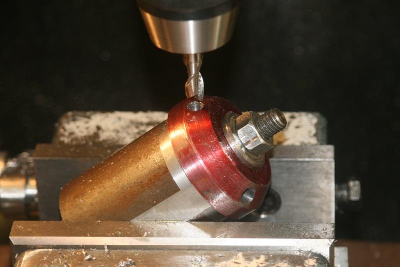

Clamp the wheels in the milling machine vice at about 30 degrees.  Sandwich the wheel in wood to protect the flanges.  Drill and tap for a 6 x 32 set screw.  Drill into the corner between the hub and wheel back.
http://i280.photobucket.com/albums/kk189/xo18thfa/Regal/Wheel%2011_zps7fncwj2m.jpg "Regal" 0-4-0 Oscillator in Gauge 1, Progress and Updates
