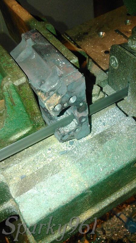

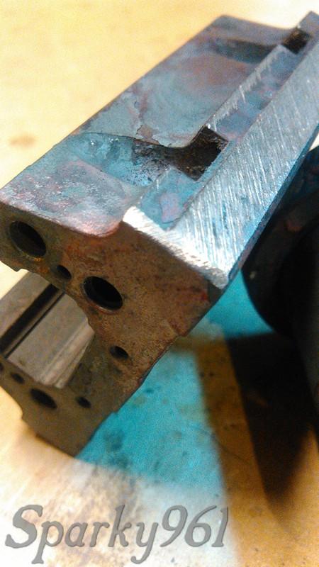

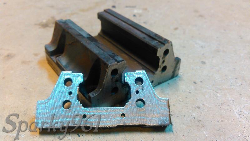

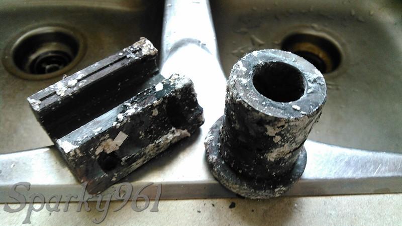

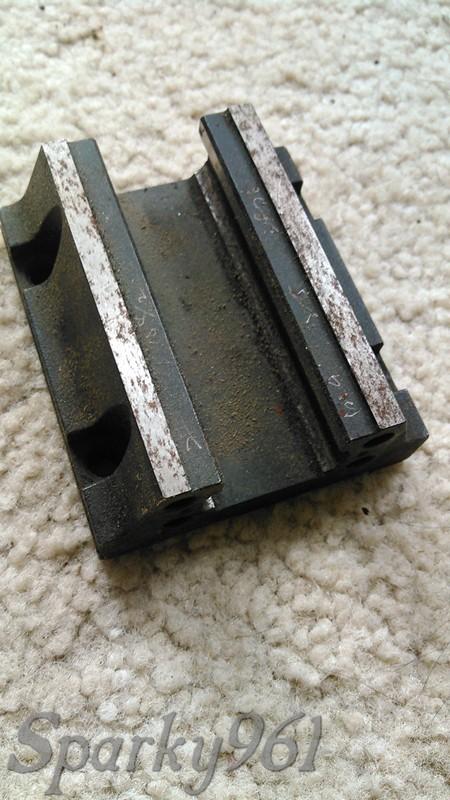

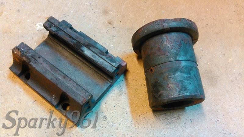

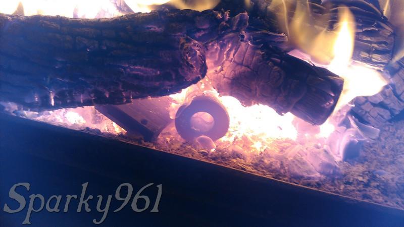

I've got some irons in the fire tonight... lol, literally.
I grabbed two of the hardest pieces of steel I could find in my box of odds and ends and when I had a nice roaring fire going I tossed them in right where it was hottest.  I let the fire roar about as hot as I felt safe with for maybe 15-20 minutes and the pieces were glowing maybe light orange with some orange-yellow at the corners.
I have a feeling they'll be nice and soft with the slow cool down overnight, but we'll see.  Pictures to follow.
One thing I did wonder about is carbon content.  I guess in most cases we aren't planning to re-harden these pieces we come across, but would anyone care to chime in on the likely chemical changes in the steel?  To what depth might it likely be affected, if at all?
Re: Cutter thingy

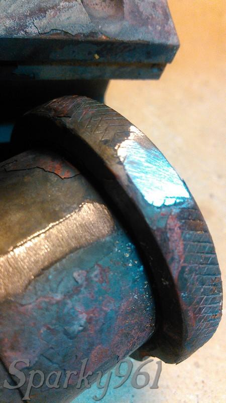

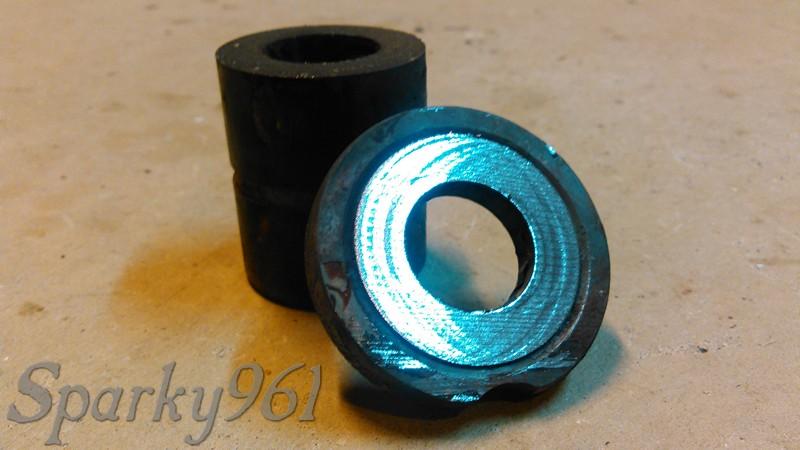

« Reply #7 on: February 05, 2017, 12:10:30 PM »
The pieces were retrieved from the fire yesterday morning after spending maybe 10-12 hours in the fire overnight.  They were air cooled the rest of the way on a fire brick near the stove.
The pictures that follow should tell the story pretty well, but if you have any other questions I can answer I'll be happy to try.
And just as a reminder, prior to annealing these pieces were so hard I was afraid of damaging my file on them!
