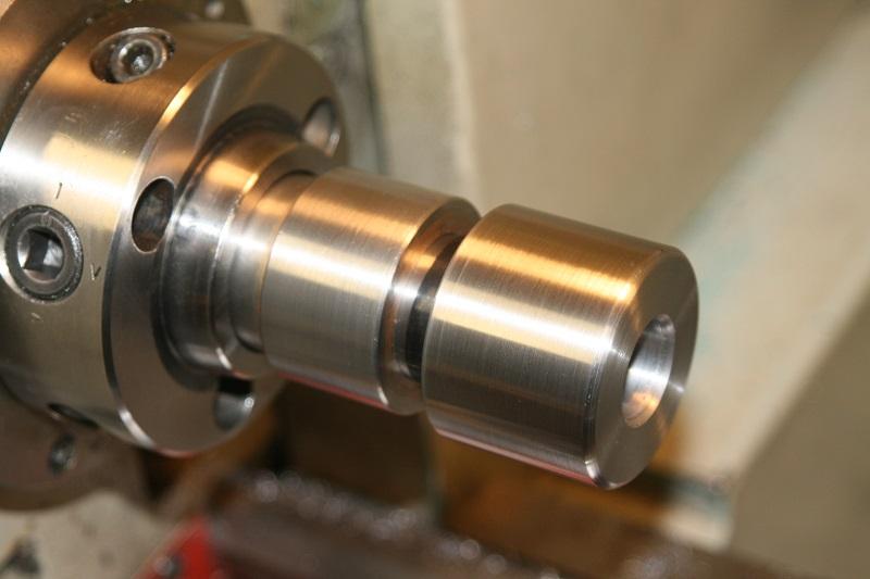

Haimer advised the use of an R8-ER32 adapter and 20mm collet. The downside of this would be that it would fit the spindle at any old position. In the instructions, Haimer mention fitting the gauge in a repositionable location, so I came up with this.

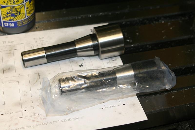

1.   A blank R8 adapter fitted with a piece of bored out bar.
2.   The 5MT – R8 adapter for boring to 20mm

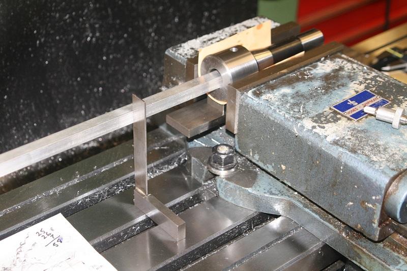

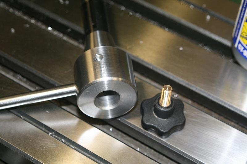

3.   M8 hole for gauge retaining stud/knob. Next job caused a problem. The requirement was for a drilled and tapped hole at 90 degrees to the original. This would hold a small handle to rotate the spindle to the correct position. Eventually solved by mounting a stick of square stock in the bore and lining up with a set square. Not quite sure how others may have tackled that job.
4.   Both parts finished. Threaded a piece of brass rod to M8 and loctited into an old rosette knob

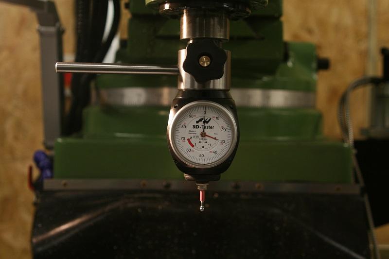

5.   Finished unit in position.
