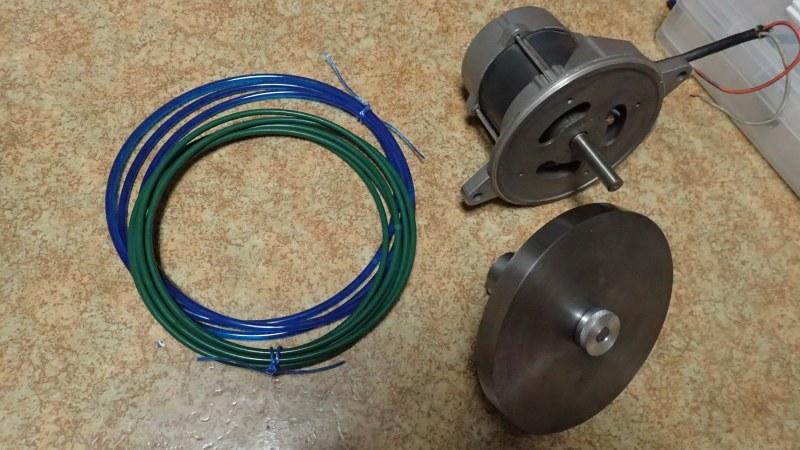

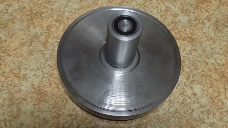

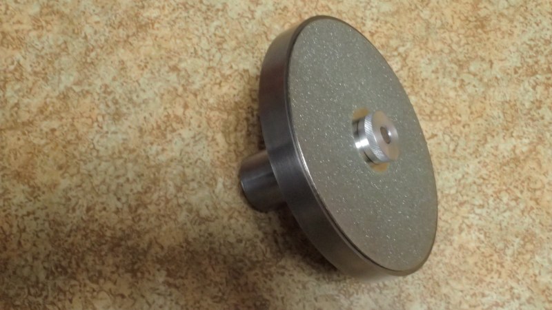

I have 90W 2800 rpm extra motor I'm planning to gear down with flat belt or round rubberthane or whatever those heat splice round belts are. Since this is fabrication, I have been thinking to use one of following methods to clamp the thin lapping disc to backplate:
1: Clamping ring/boss + nut (maybe a knurled one) to clamp the centre
2: Couple of supermagnets on the back + retaining pin on the middle. Ejection? "captive" nut or something like #1 to clamp/eject?
3: Small vacuum. I have a small quiet pump, not much is needed, but needs a rotary union or other induction. A bit over engineerin.
I would love to settle on #1, will it work. If it does - KISS, but I don't want to simplify it too far.
Re: How to sharpen carbide scraper?
« Reply #17 on: February 11, 2017, 06:56:24 PM »
Bit progress.
Any suggestion on round belt small pulley dimension. I think I read somewhere that drive wheel is V type, just like standard V-belt sheave?
