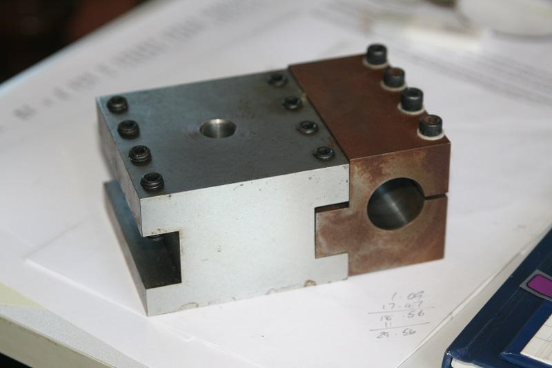

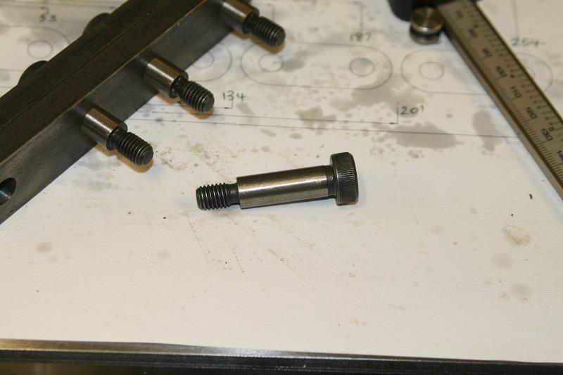

The new design will be based loosely on Rob W's slotter from the original MEW article from 1991.
Main difference will be no casting used. (CES appear bashful about price and availability of stock.) Their casting is designed to be fitted to the cross slide, whereas I prefer the top slide placement.
Main disadvantage of mine is that I cannot have the ram and pivot points on opposite sides of the main retaining stud, as the cross slide runs off it's thread.

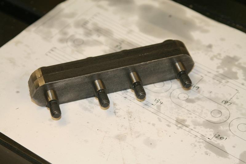

Some sizes have been altered for material I had in stock. The pivots will utilise allen headed shoulder bolts.
A start has been made on the handle, and pivot links so far. The two sets of pivot links were drilled and reamed separately using DRO, fitted with the bolts to confirm accuracy.

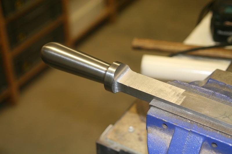

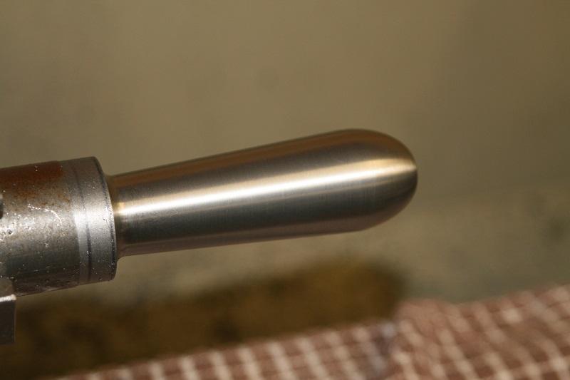

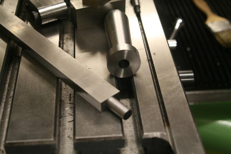

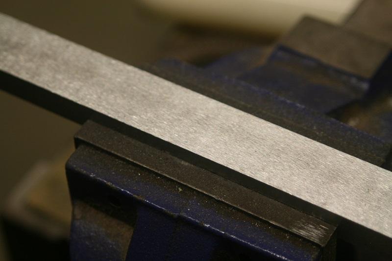

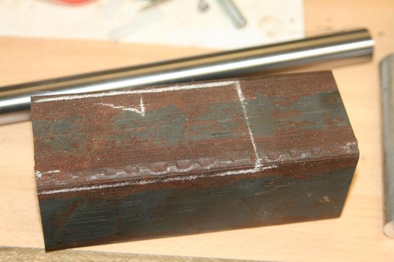

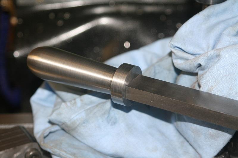

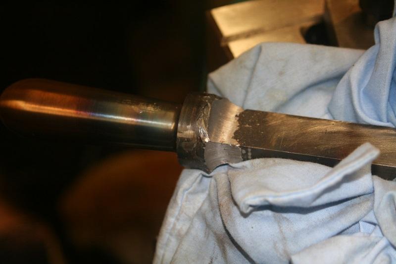

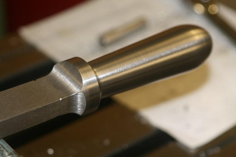

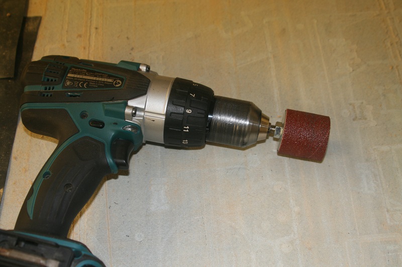

Some slight progress.
1. Parted off the handle, drilled 12mm. Turned a 12mm spigot on the 1" x 1/2".
2. Two parts fitted.
3. Following being attacked with the mig welder.
4. Cleaned up with roll sander.
5. Roll sander
6. Poor mans surface grinder? (with the roll)
7. Finished effort. Just got a slight undercut where the weld started/finish on the 1" x 1/2".  :scratch: Any ideas how to avoid that?
