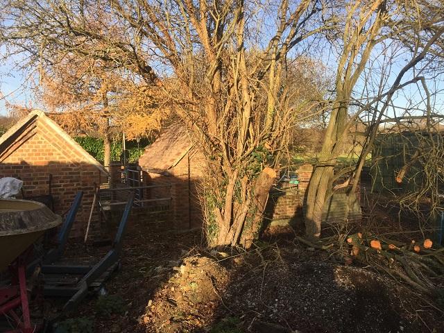

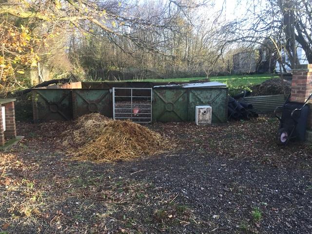

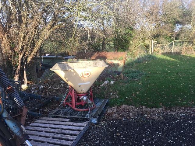

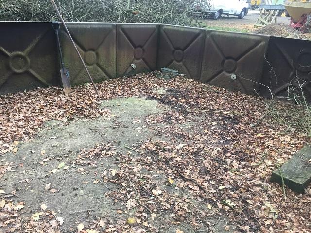

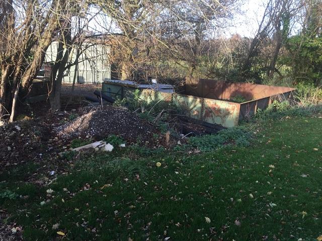

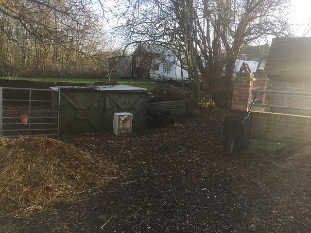

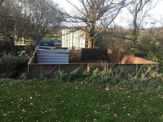

45 foot long, 40 foot wide, 12 foot eaves and a 15 degree pitched roof. 15 foot wide by almost 15 foot high electrically operated roller shutter with a pedestrian door beside it.
Walls will be dark green zintec profiled sheeting with the roof in fibre re-inforced 'big 6' corrugated sheets with fibreglass roof lights. The bottom 500 mm of the walls will be pre-stressed concrete panels to keep the sheets out of the ground and give something to form a 150 mm concrete floor up to.

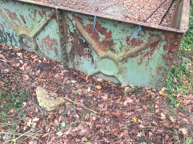

Currently the site has a huge water tank and a few shrubby trees on it that will have to go, and as you can see from the pictures, there is a bit of ground to be made up to form a base to lay a slab on
In anticipation of getting the go ahead I've been in discussions with a local contractor who has modified buildings for me before. Nowadays steel frame buildings have to be 'CE Certified' or you can't insure them, so this effectively rules out what he was previously doing ie building them from scratch from I beams etc. Now he orders a complete building, pre-made that is delivered as a kit to site, and he does the ground works and erects it. Good old EU squashing the little man :(
He may be able to put a few days in before Christmas to start breaking up the tank and it's base, meanwhile I need to cut down that hawthorn bush that is really a small tree  :zap:
The sooner we can get some fill in to make up the levels the better, so it can be settling for a few months before work starts in earnest in the spring.

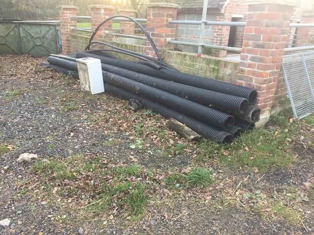

Weather forecast OK for tomorrow so I may be able to make a start clearing the site. I've stacked a whole load of 6" twin wall 6 metre pipes down the side of the tank - need to find somewhere else to hide them before that Hawthorn tree is felled and crushes them.

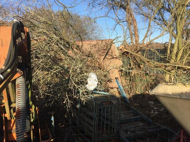

« Reply #15 on: November 25, 2016, 04:33:42 AM »
So no point in hanging around - may as well crack on  :thumbup:

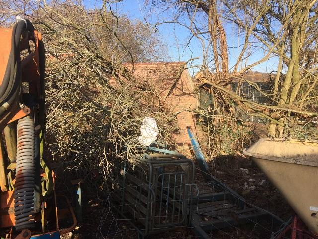

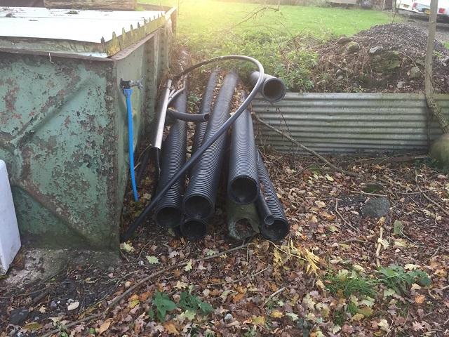

Once the livestock were sorted, I pulled out my cache of pipes and re-located them. I think that they are actually intended as large electrical ducts. They were given to me a few years ago by a friend who had to give up his farm and are too good to throw away, but I've only used short bits over the years :scratch:
Then I set too with the Hawthorn tree. Flipping awkward thing to fell - being a hugely over grown hedge shrub is has many limbs all emerging at just above ground level, with all their tops inter-tangled.
Got the first major limb down and the tops dragged away, so now in for breakfast and let the blood get back into my legs  :bugeye:

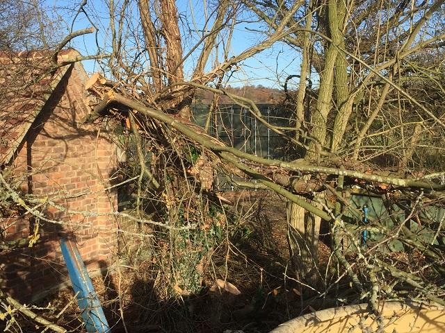

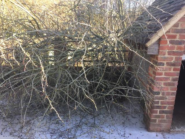

Re: New Tractor Shed

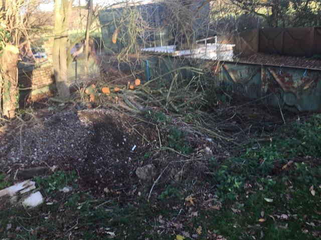

« Reply #16 on: November 25, 2016, 09:58:41 AM »

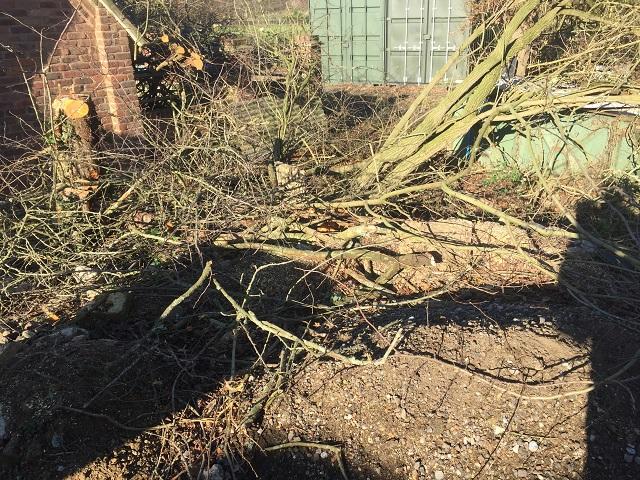

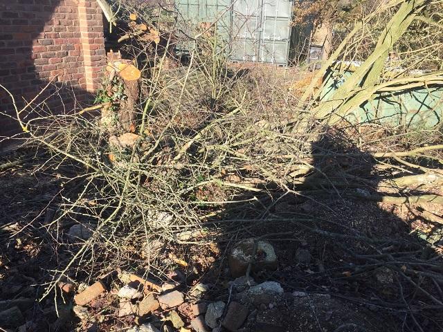

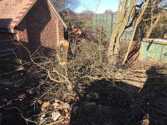

So back to it after breakfast. Eventually got the lot down, but there was so much hanging over the pig sty's it was impossible to avoid dropping some on their tiled roofs, despite pulling the limbs with a ratchet strap whilst cutting. Never the less minimal damage done - a couple of tiles I think of which I have spares.
Taking the Alder down was a breeze by comparison as i had room to drop it over the tank. Lots of good logs to cut from those limbs and a lot of clearing up to do,  but that will have to await until tomorrow as I'm knackered  :bugeye:

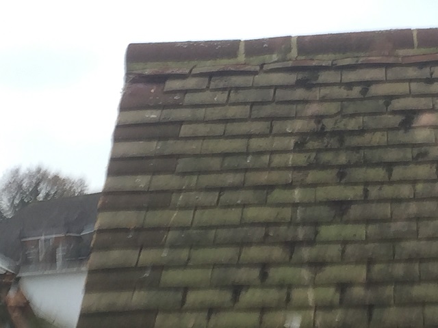

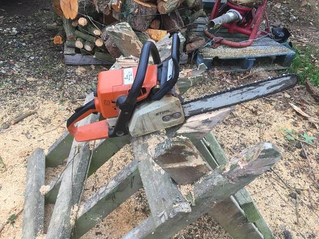

« Reply #20 on: November 26, 2016, 10:06:49 AM »

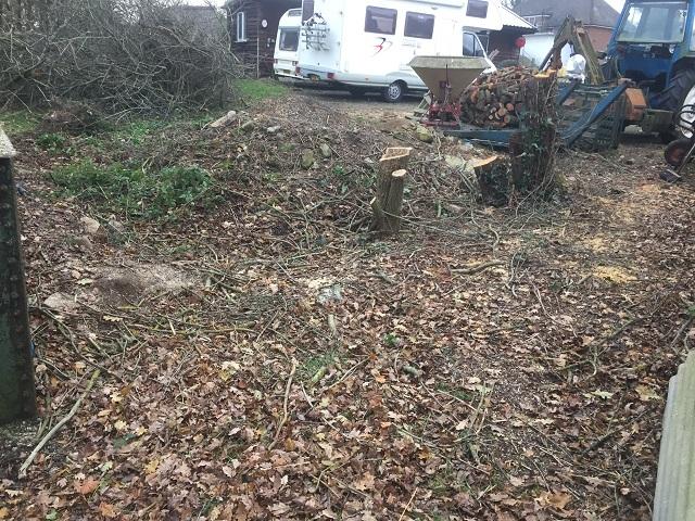

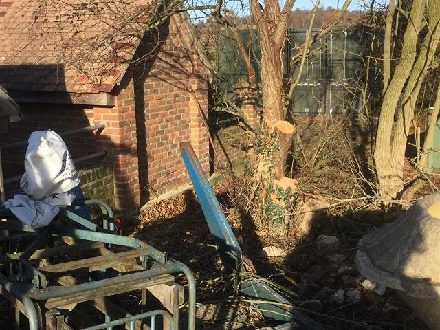

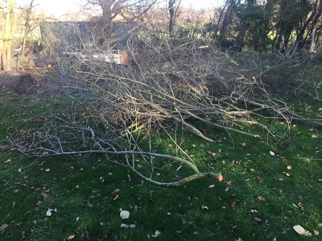

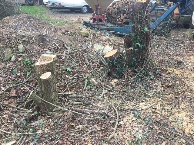

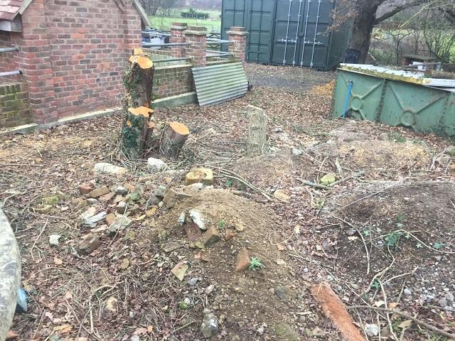

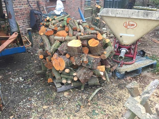

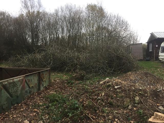

So another day of playing with a chainsaw and I've managed to clear away all the tops into one pile, and pull out anything worth logging, and chopped it into suitable lengths for the log burner  :thumbup:
Having now been able to get close to the pig sty roof and inspect the damage I'm pleased to see that it is minimal - just two broken tiles.
I've left the stumps with a fair bit 'sticking out' as this will give me more leverage with the JCB 803 when the time comes to dig them out. Just need to work out how / where / when to burn that huge pile of tops - certainly moving them again would be a major task, however they are sitting on a decent lawn which it'd be nice to preserve. Oh why did I sell my tractor mounted shredder  :bang:

Now if you leave the tops a while Andrew, given the state of genetic engineering and the bioengineering lobby they might get picked up by a few pterodactyls for nesting purposes? :D
More seriously could they not be dragged into use as hedging "hole fillers" . We have several "holes " in hedges locally where amateur rally drivers have found they're not as good at cornering as they think.  :doh:
You might find a local wood turning group are interested in the stumps once they're out?

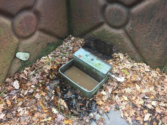

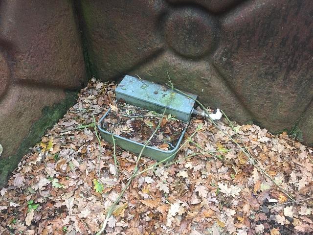

Current plan is to have a bonfire in the old tank to lose the tops. It'll have to be in the corner where currently there is an automatic filling water trough used when I've had pigs in there. It was due to be removed before the tank is broken up, but I plan to dig down to it's feeder pipe tomorrow morning, isolate it and pull the trough out.
(Has to be in this corner to keep flames away from other trees)

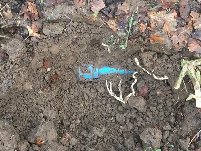

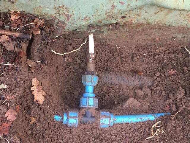

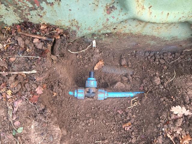

I wasn't looking forward to digging out the water feed to the trough as it's a mixture of hard core and earth on top of it, so I thought best get on with it - these things are best just faced up to.
In the event it was a doodle - once I'd got down low enough to expose a bit of blue pipe, careful trowelling got it sufficiently laid bare to cap it with a blanking plug.
(If you look at the picture of it exposed, slightly lower is a duct carrying 415v 3 phase, so careful work was needed)

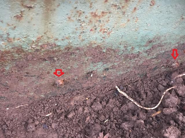

Needless to say the bolts holding the trough in were thoroughly rusted after a few years underground, but succumbed to an angle grinder and cold chisel allowing me to recover the trough and clear the site for the bonfire  .
So the job was finished by 09:30 which will give me time to shunt a few things around in the yard so I can get at the site better, before I have to take the wife out for her Sunday Roast Beef and Yorkshire Puds
