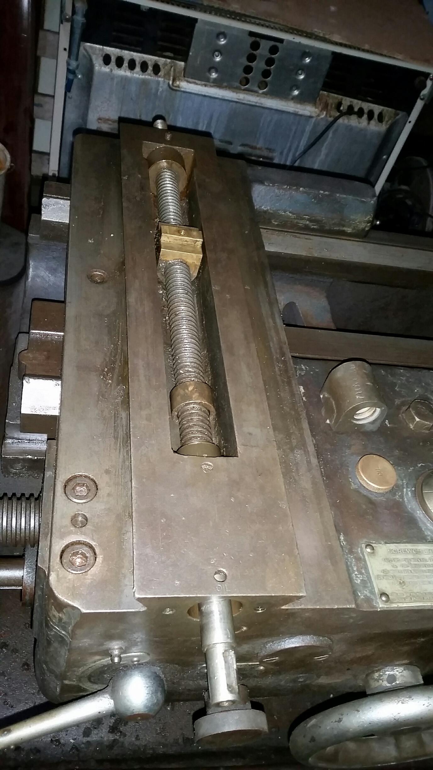

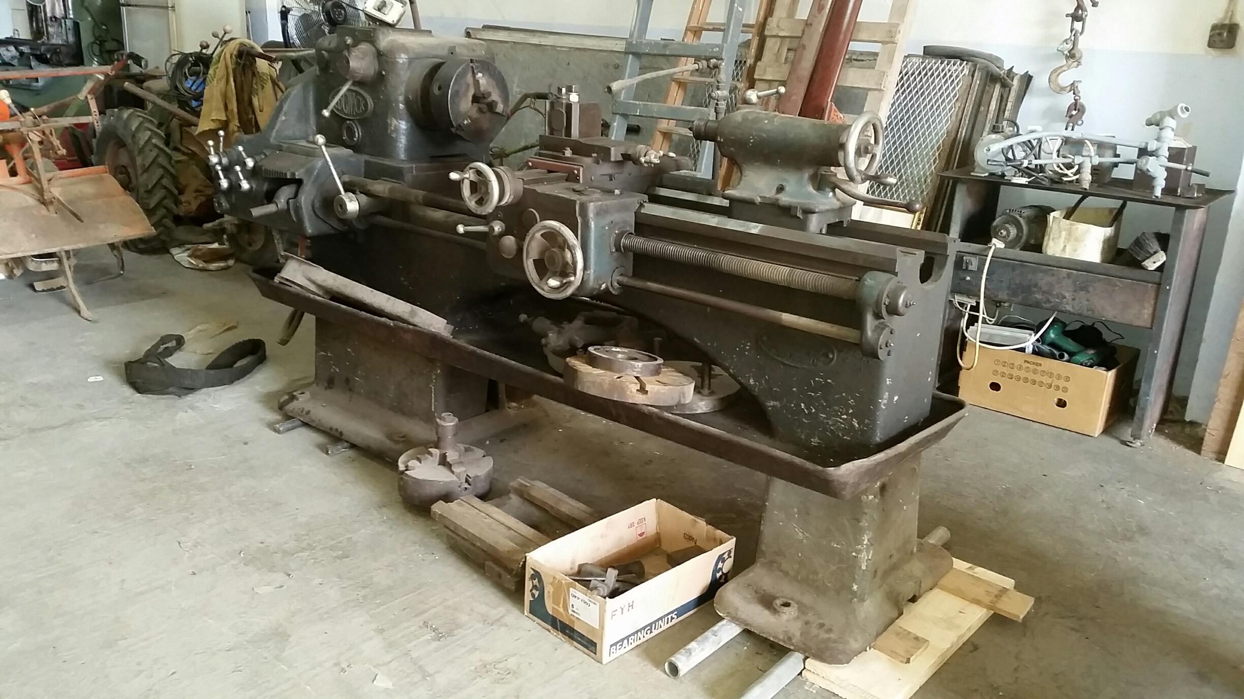

Hi all I am new to this blog but it looks really informative and helpful. I am currently restoring an Albert Herbert gap-bed lathe built by Edgwick 6.5inch mk1.
I am finding difficulty to remove the brass cross-slide nut , has anyone worked on an Edwick lathe and maybe can help? When I am trying to pull out the stud from the front side it is hitting the intermediate gear of the automatic feed. If possible I am trying not to remove the top part of the saddle in order not to loose the setting..
I am really stuck please can anyone help? I have attached a picture of the lathe and two of the cross-slide nut from a top view and front view.
Thanks

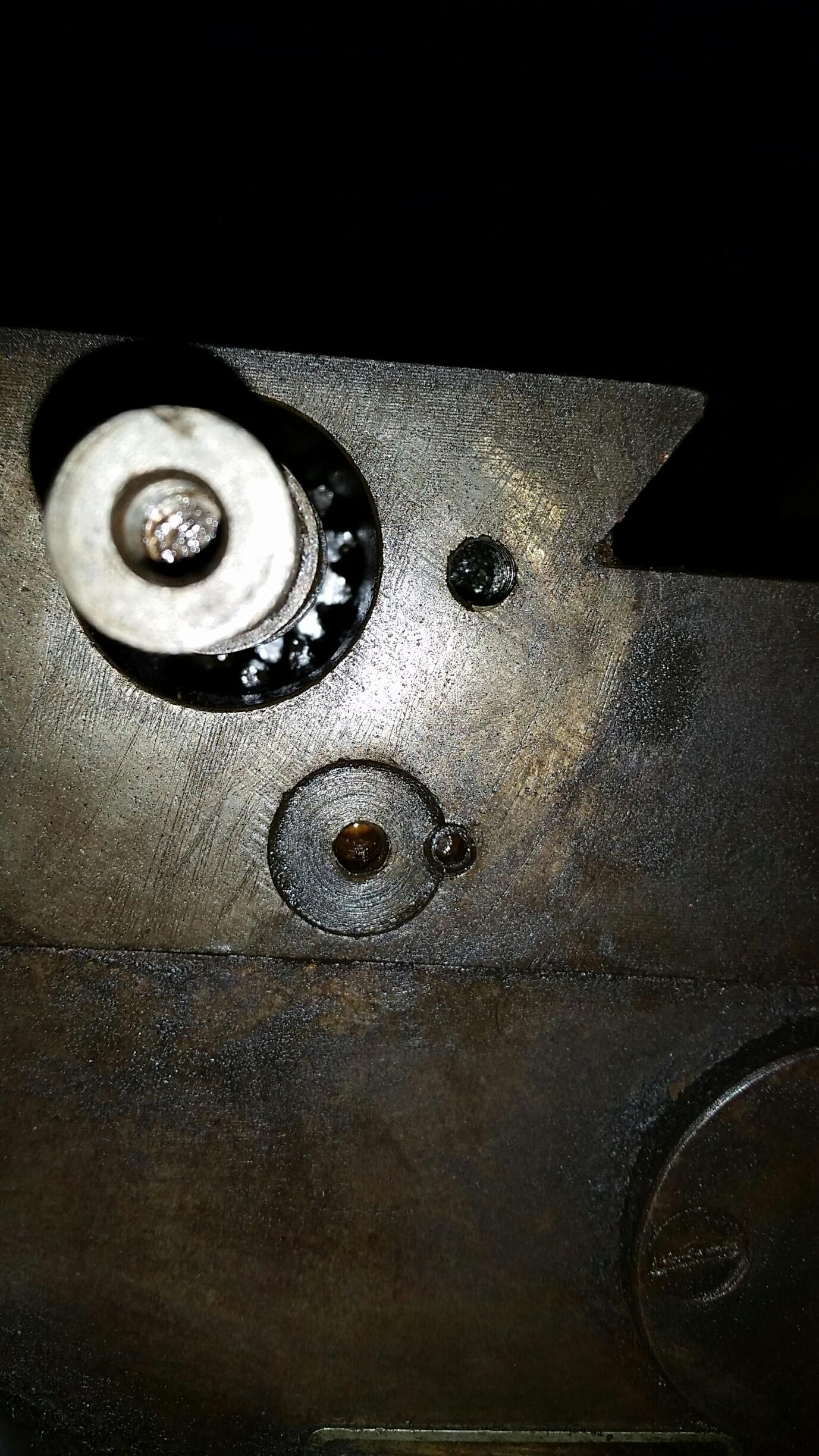

« Reply #4 on: November 11, 2016, 05:07:36 PM »
Chris,
It's been a year since I took the cross slide lead screw out to repair the where the end had been sheared off! It comes out from the front, you have to take the handle and the graduated dial off to get at the screws that hold the  lead screw in place. Note, there is a friction mechanism for the dial that uses a screw in the lead screw its self, this is visible in my thread http://madmodder.net/index.php/topic,10758.25.html in the middle of the second page. If you have any more questions, I'd be glad to help if I can!

Hi Matthew
I got the dial off the lead screw, why exactly do I need to remove the dial friction mechanism?
The problem that I am facing is that when trying to pull out the shaft from the front, the splined gear (used for the taper attachment) in the cross slide lead screw is hitting the intermediate gear that enables the power feed for the cross slide..
Re: Edgwick lathe cross-slide nut replacement
« Reply #6 on: November 12, 2016, 02:03:11 PM »
You don't need to remove the dial friction mechanism, just don't loose it! My lathe is back together, I don't have the taper attachment so I can't help you with that. Post some photos, I can't see how the taper attachment would interfere, normally, the cross slide is disconnected from it's drive so that the cross slide is free to follow the taper attachment. I have a vague memory of turning the cross slide drive to get the lead screw out.
