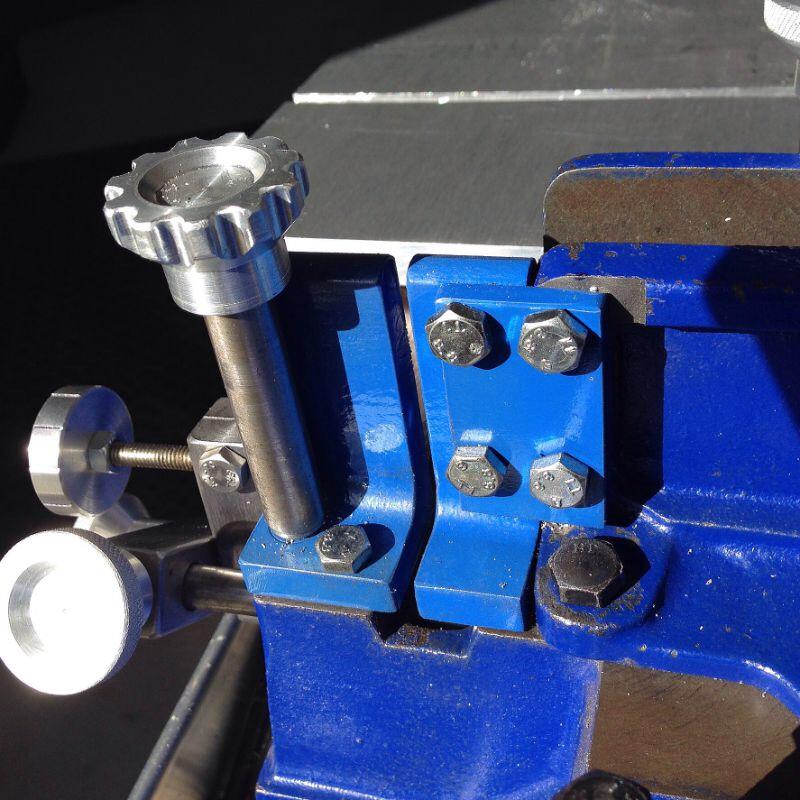

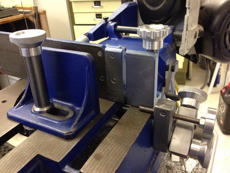

 Here's how I solved the same issue. It's not my idea as it was posted up by one of the guys on the bandsaw group just my version. It's part of an update to my saw. As you can see I've extended the fix jaw out past the blade, stops the cut off bit from going anywhere. The adjustable end stop pivots on the Rod & the screw thread knob is "calibrated" to 10 divisions on A 6 x 1 mm thread.
Cheers Kerrin

 Thanks for the compliment, I've attached a picture from the other side showing how it's attached. By doing this mod you can have your stop against the work, without a spacer, as the piece cut off doesn't move.
As to cutting at 90 degrees you need to carefully set the fixed jaw at 90 degrees to the blade, don't relie on the scale that came with the saw!  Use say a 6" set square clamped to the blade, set it above the teeth, then carefully move the fix jaw until you are happy, tighten down, check all is still ok then drill thru the jaw & the table with say a 6mm or 1/4" bit & make or find a pin to suit that is a slip fit that won't fall thru. After that it's easy to set it at 90 degrees!
I've also made a quick fit table that's 300mm square, takes less than 30 seconds, to fit & remove. I think it's a vast improvement on the pressed steel version!
